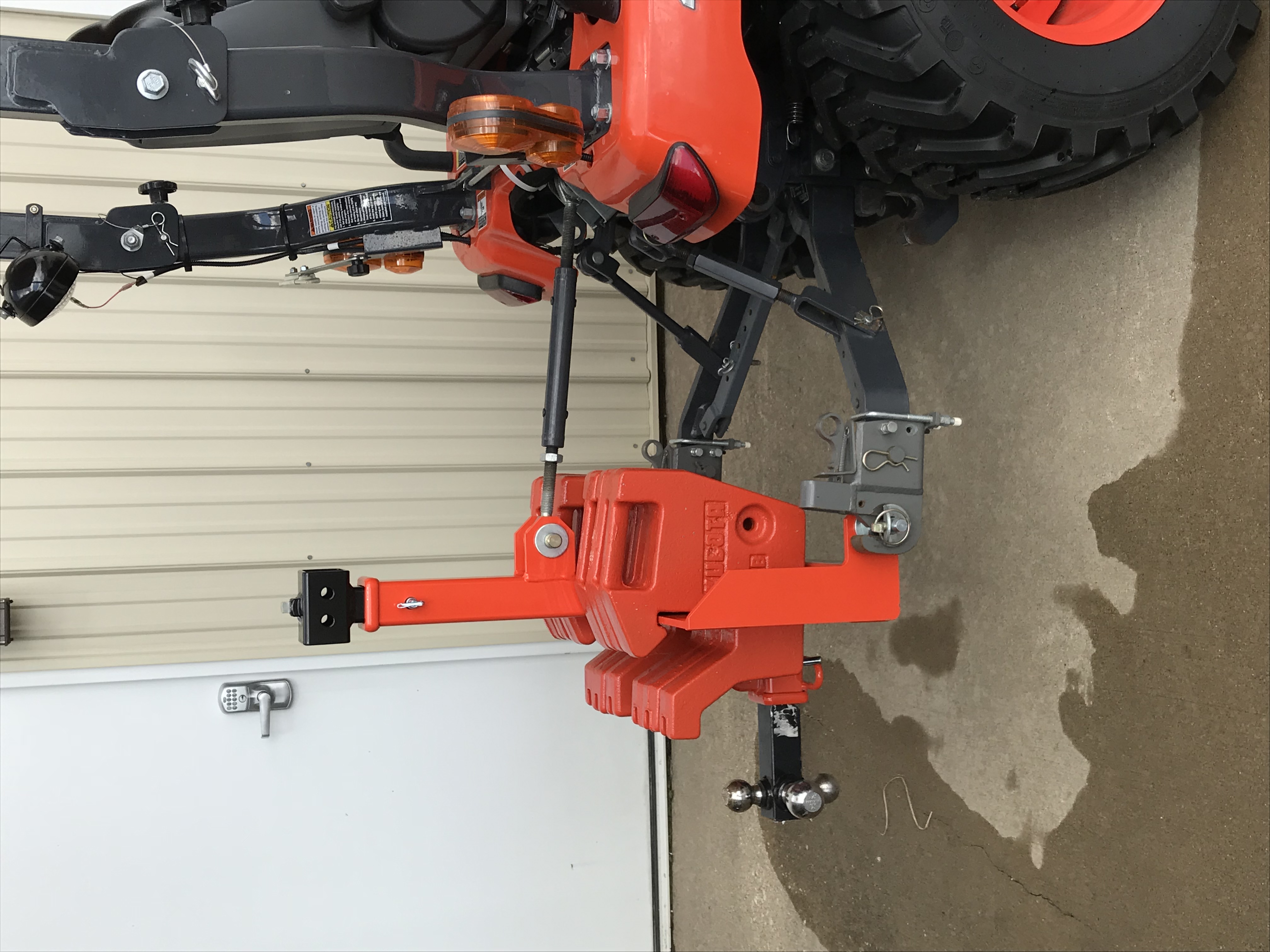

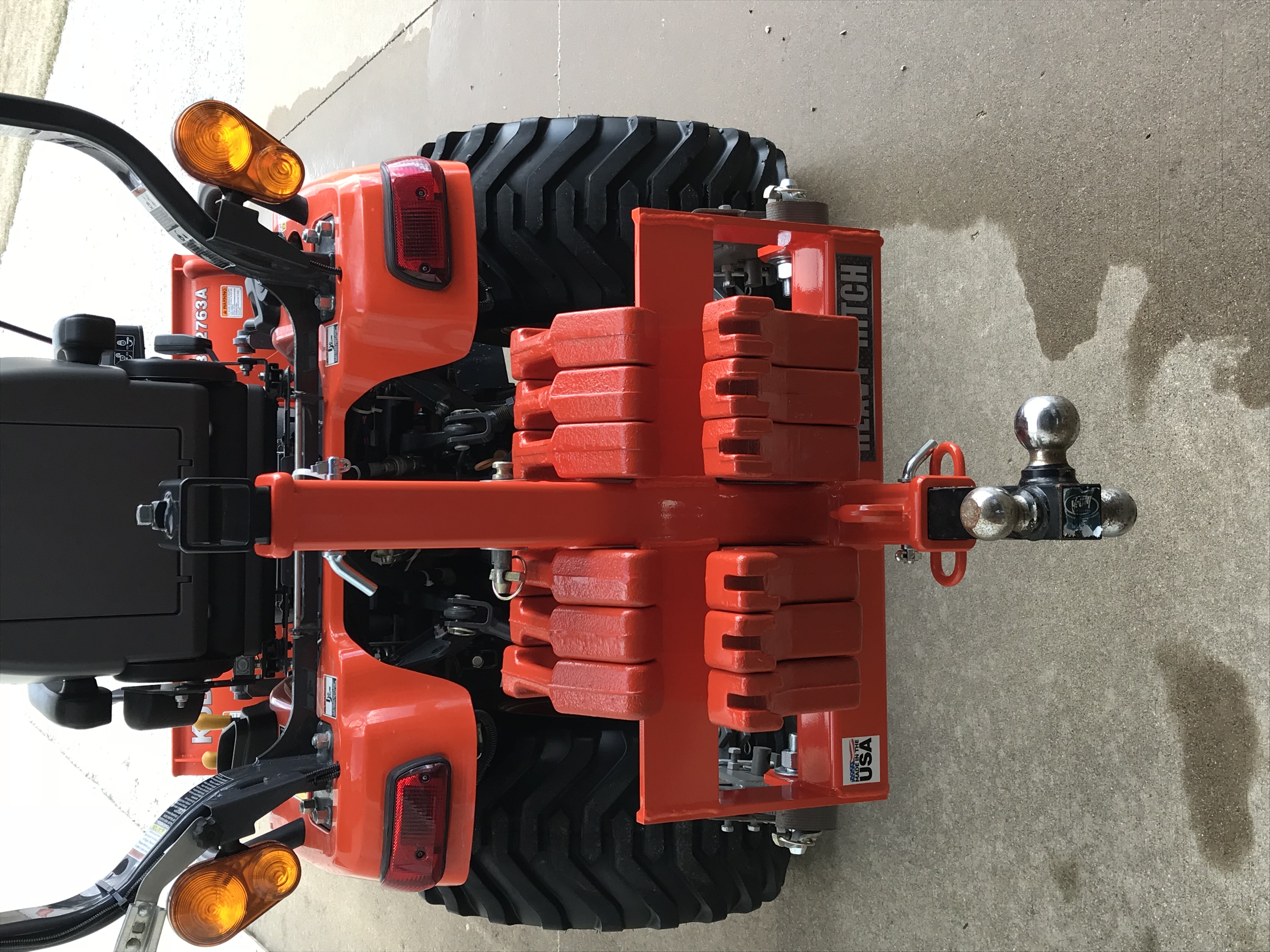

While I'm waiting for the big Heavy Hitch to arrive I installed the small one. Since one of the factory Kubota bolts was damaged and they were already rusted I replaced with a set of stainless bolts, washers, and lock nuts.
   / Ballast Box vs Suitcase Weights - HeavyHitch Inbound! #48
Have some ballast now!!
   / Ballast Box vs Suitcase Weights - HeavyHitch Inbound! #49
Thsts sharp. Did the the top drawbar for installing a rack come with it?
I can't find any weights local, so I may need to buy some from a dealer. I like this approach to weight because I can leave the Heavy Hitch on, and easily drop the weights on when doing loader work.
