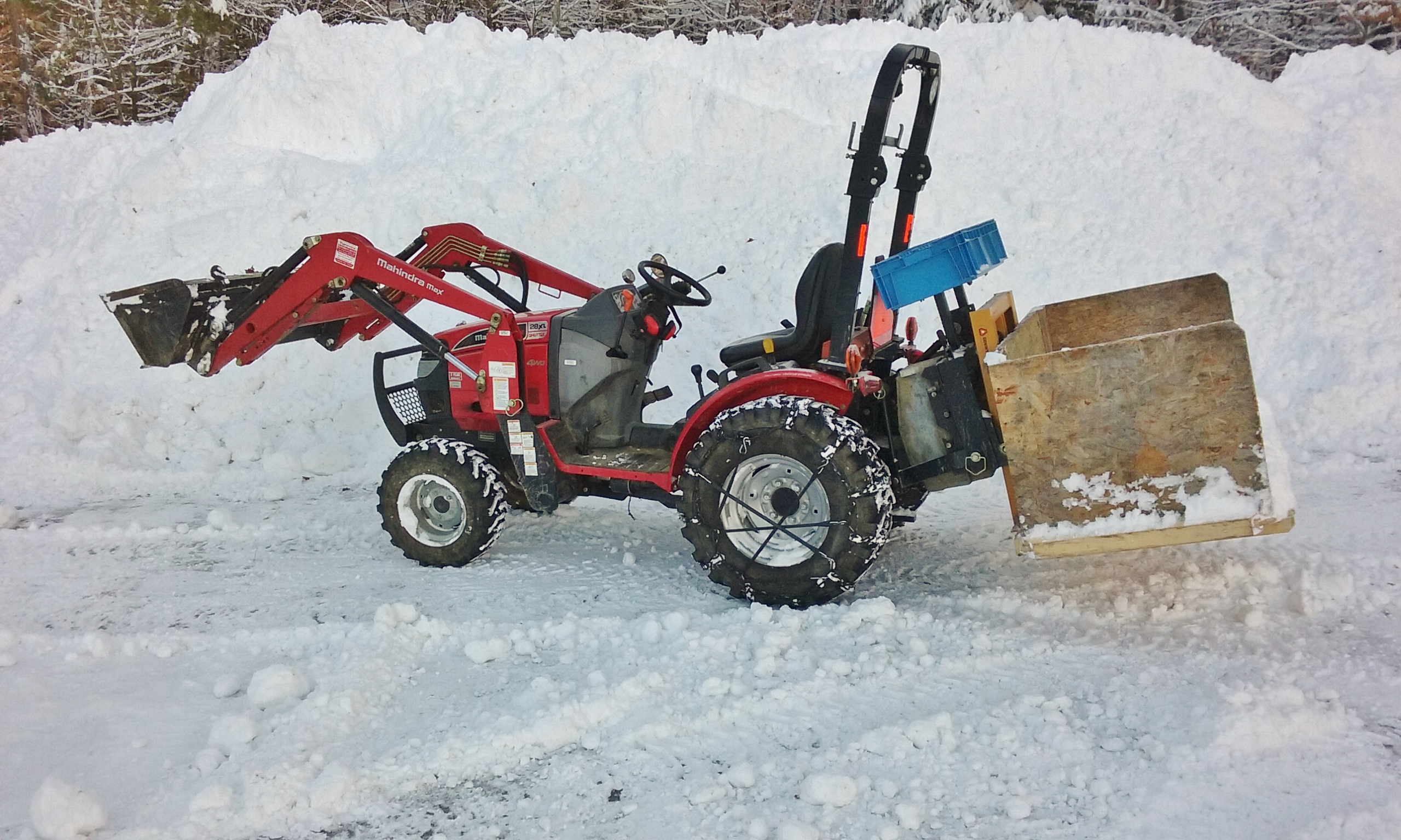

You'll probably think its cumbersome but my best counterweight is my 3 point bale spear and a bale. For snow, I have a bale outside, L6060 in heated garage. Drive out, spear the bale, and I'm in business. Spear doesn't take up much room in garage. Lots of weight well back of tires, excellent traction.

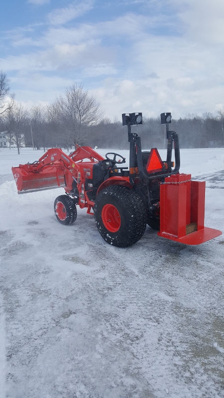

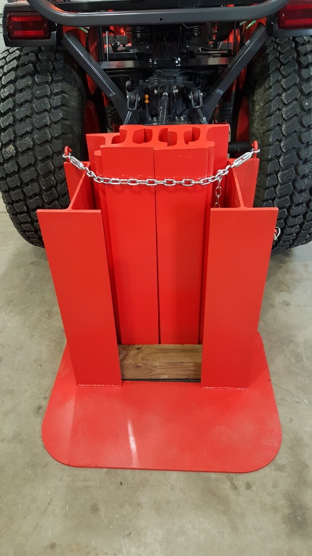

I really liked the idea of a dedicated ballast box for my B2650. I wanted to fab one up that was compact and one that was adjustable for doing tasks like plowing snow with my loader or bucketing material. I welded up a frame and welded on a drawbar. Then I fabbed up the mount for the top link and welded it on. I bought 10 peices of rr track that weigh 100 lbs apeice. With the frame weighing 150 lbs I added 5 rr tracks for a total of 650 lbs. That has been the perfect amount of weight. I can get a full bucket of dirt with my 60 "bucket and the machine stays planted even driving on uneven ground. I have left it at that weight for everything I do. Of course then I had to paint it Kubota orange to match the tractor!

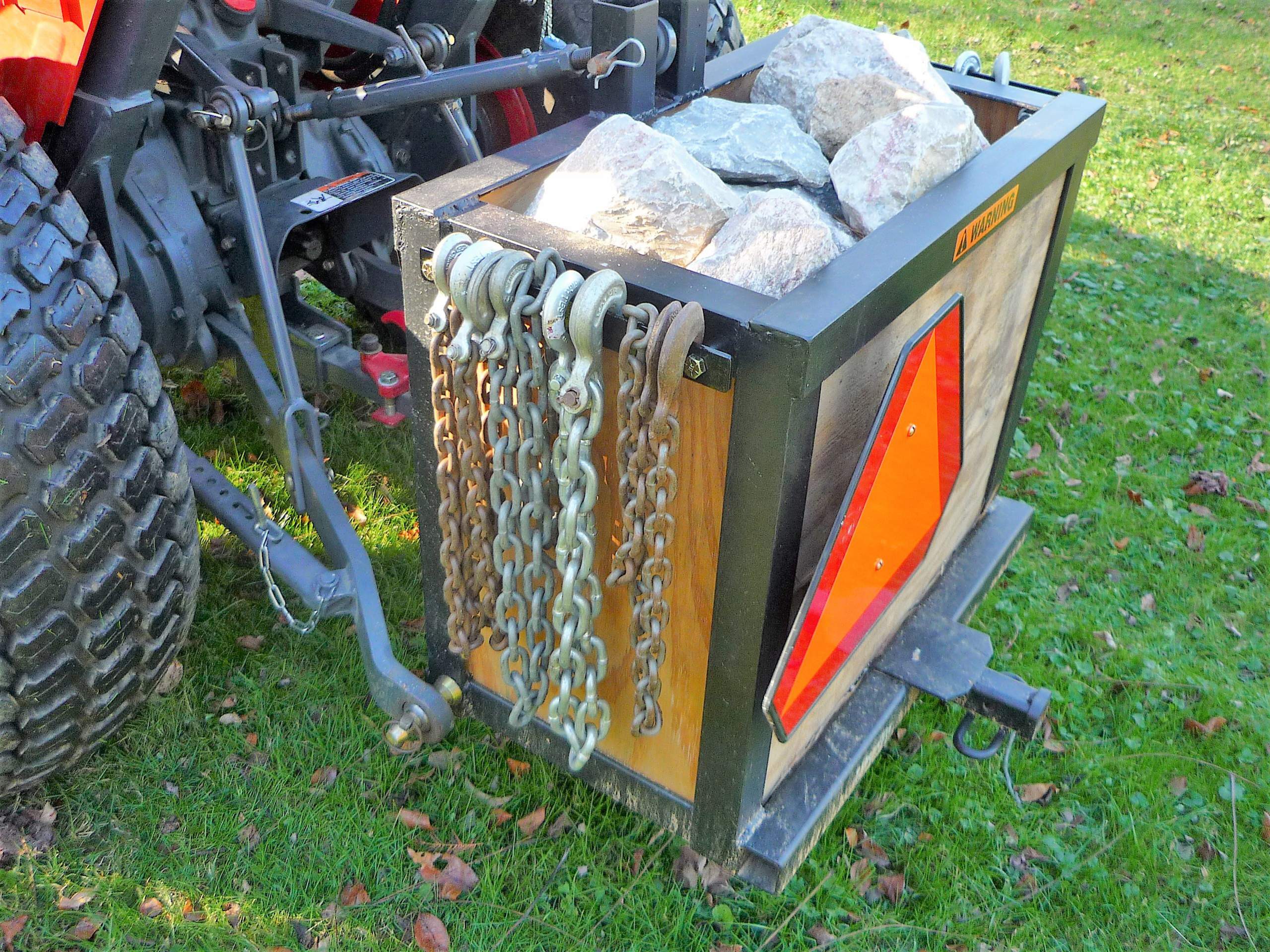

R Kidd, that's a really nice job you did on your weight box! Mine is somewhat similar, in that the ballast is removable/adjustable... in my case, heavy stones. The trailer hitch comes in handy when I have a firewood trailer to move, and still want the rear weight. The chain rails also are very handy, and add a bit of weight, obviously.
   / Ballast box vs Grandpa's implement for added weight #17
My Ballast is pinned to my customized HF 3Pt Quick Hitch, Filled with steel bars and weights over #650 Lbs.
It stays on the back of the tractor most of the time except when I need the PTO.
Comes off easy as long as I do the process slow, careful, and deliberate.

Great job on your ballast box! Nice and compact to get around. Alot of nice features. Looks awesome!!
