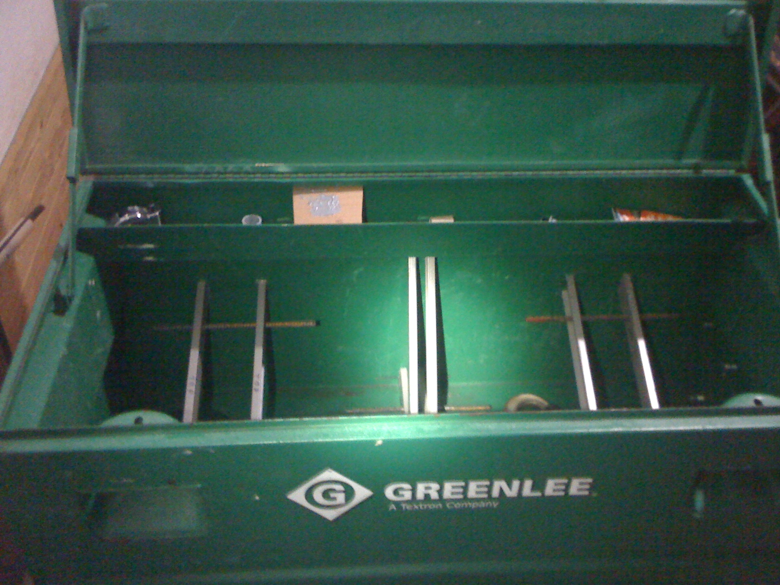

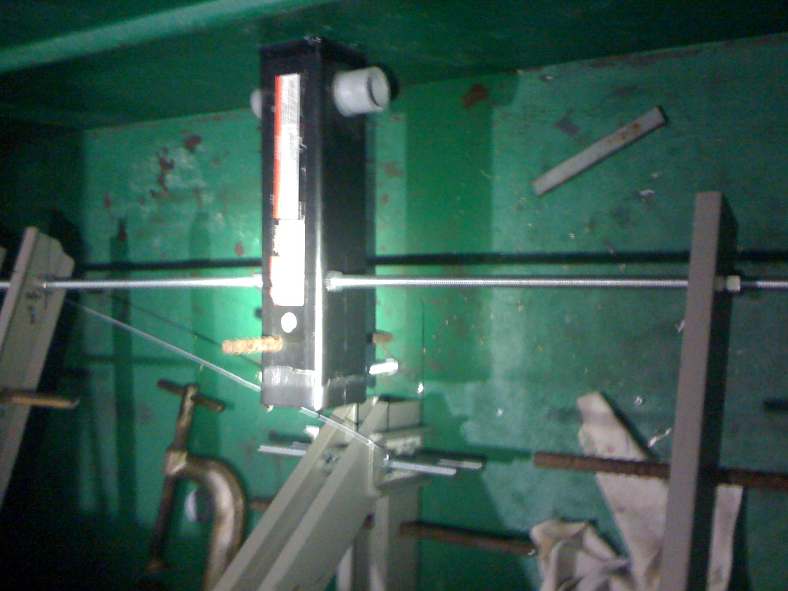

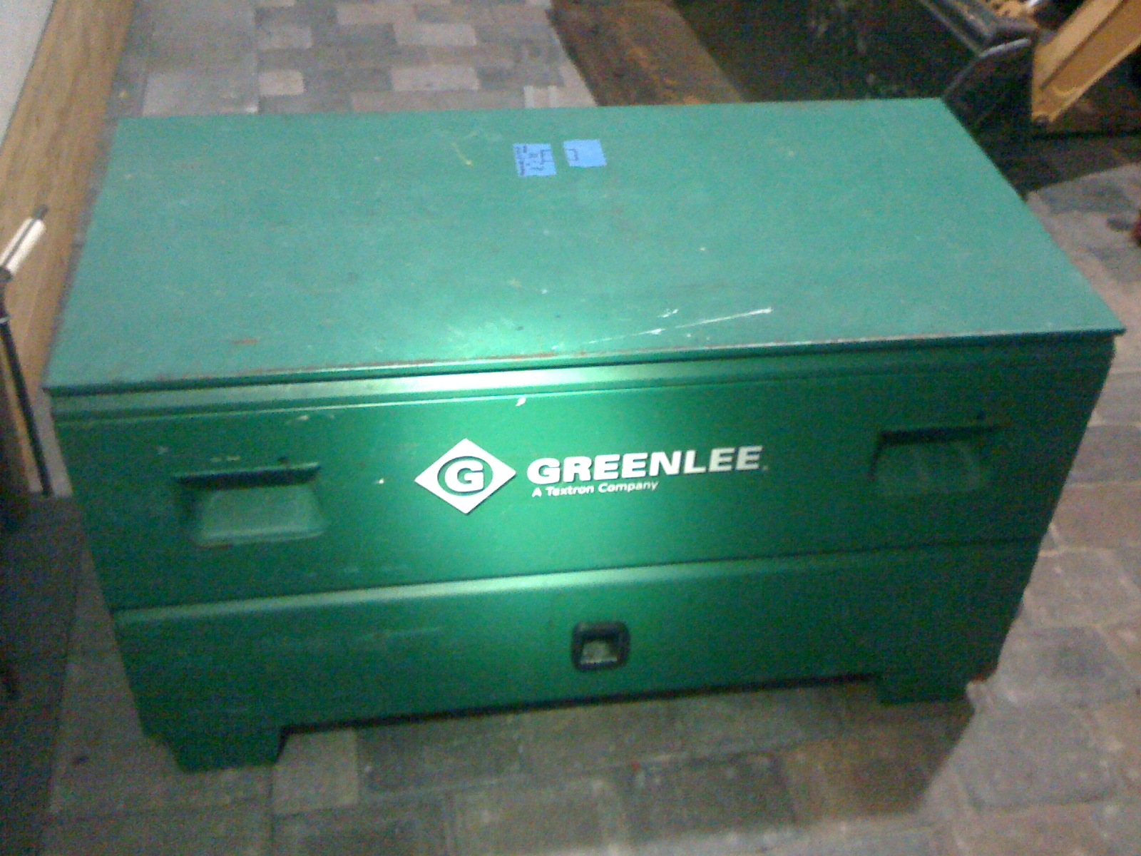

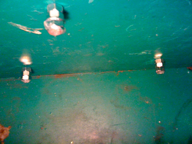

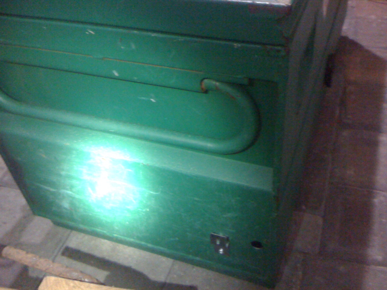

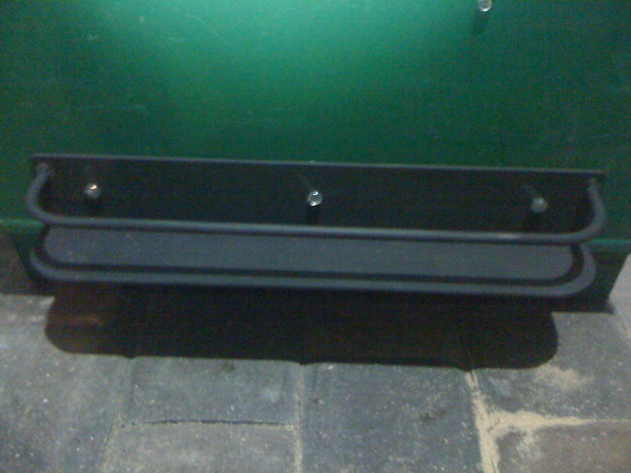

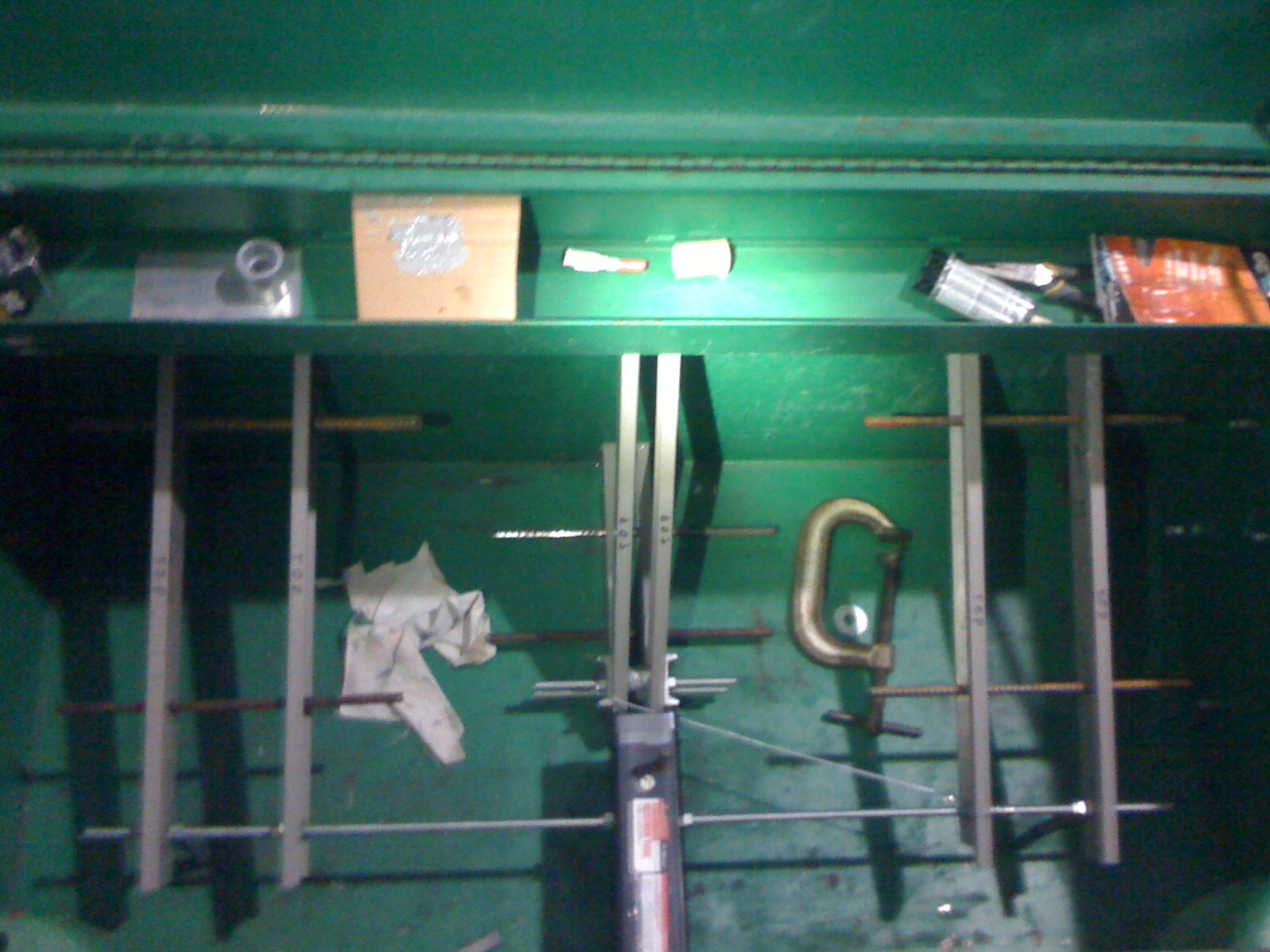

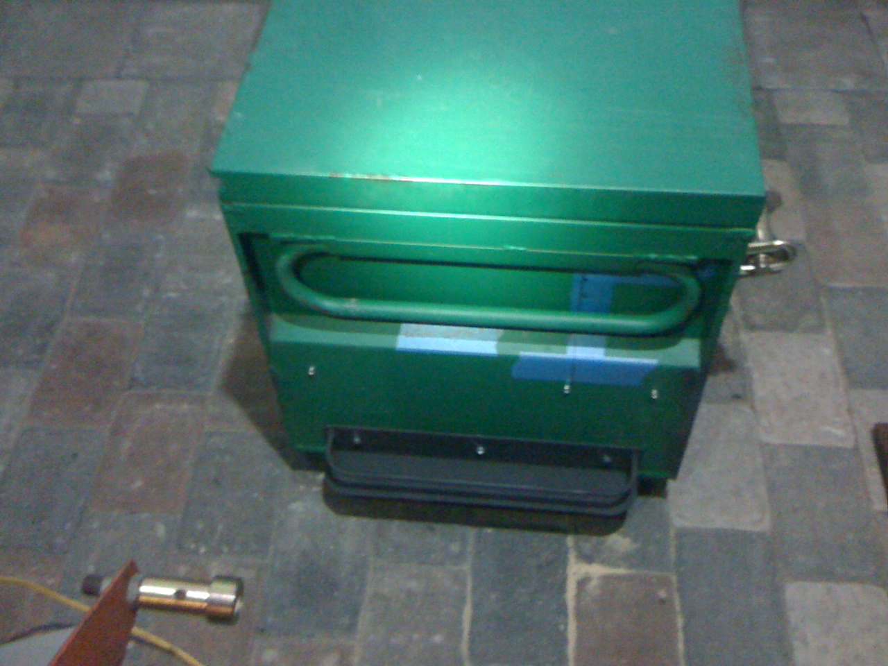

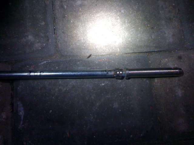

I am making a ballast box out of an old worksite/ job box. It will double as a tool storage/trunk as I will leave an area 12" H x 16"x4' open. Best weight guess would be about 1400#, but I could always add more weight to the 'storage' area. I have the standard receiver hitch (flush mounted), with a hardned pin welded to a long handle. You can see the hole and the holder for the pin. The pin will travel through the metal pipe pictured. The other side will function as a ax, shovel, etc tool holder. I have used three nuts on the inside of the box so that I can remove the mounting bolts at any time, as the concrete will hold the nuts in place. I also have place several more of the coupler nuts/bolts above tool holder bracket to install eye bolts to use for bungee tie downs. The upper mounting bracket area is not finished yet, but will be after the pour is completed. I have applied silicone to all points where the box was cut for mounting bars. So am I forgetting anything?

Looks and sounds like this is going to be one heavy beast. Can it be too heavy? I think so, so be careful on just how heavy you make it or how you can adjust the weight down when not needed. Otherwise, great idea and nice looking finished product.

I Should not need pvc pipes as any long tools can be mounted on the side. The shovels, etc would be placed through the large handle loop, with the top of the handle resting against the part that is currently black. If I find the need to, I could secure the shovels with bungee cords to keep them from moving. But a very sincere thanks for the reminder as once its done, its DONE.

I would guess the force of the concrete will bulge those sides. Don't under estimate the side forces. You could run 2 x 4s on edge outside the box to add temporary reinforcement while the concrete cures.

The only other thing I can think of from what you've posted is how do you plan to secure your long hitch pin?
You may want to leave a inch of the conduit pipe stick out through the side of the box so you can secure the hitch pin to it with a hairpin clip.

Will your top link fit through the mount? It looks close and can it swivel through the whole range of lift?
I would mount it empty on the tractor and confirm clearances. I didn't and had to take a cutting torch to my home made trailer mover.
The mounting nuts inside the box. I wouldn't depend on concrete to keep them from turning without welding torque arms on them. Also, it looks like three nuts are stacked together. Do they function as jam nuts together?
Mounting... looks pretty thin material. The mounts will have to lift a lot of weight and be able to resist dynamic side forces.
