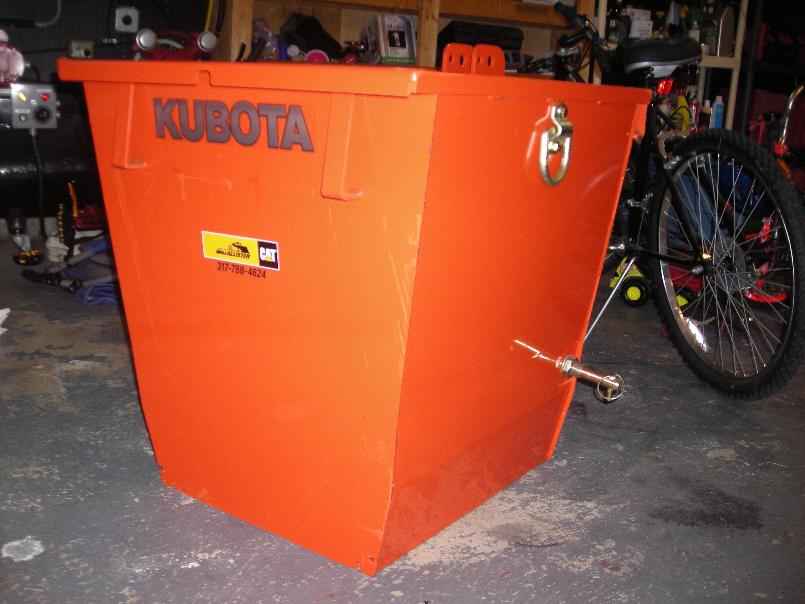

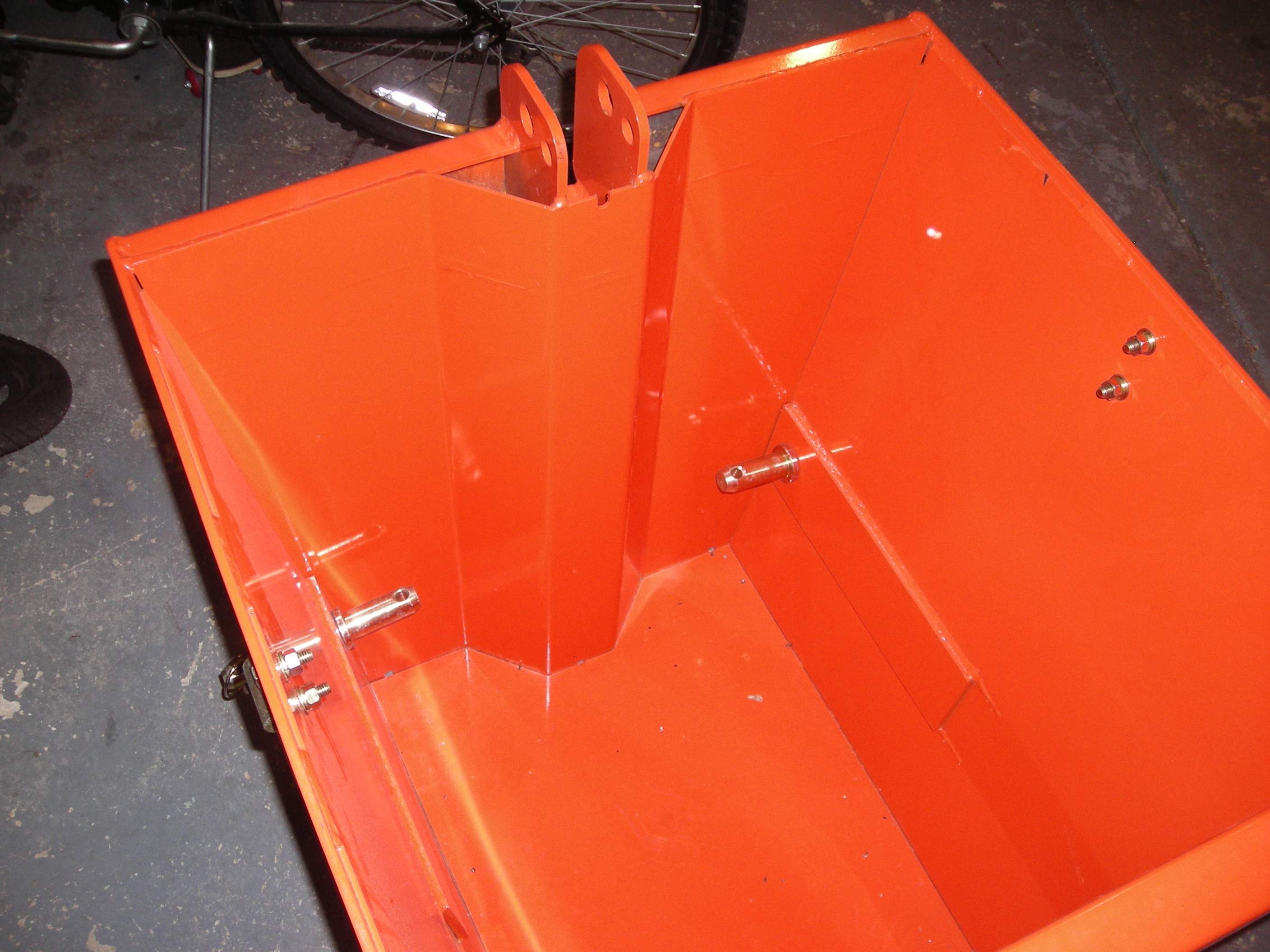

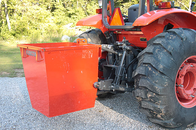

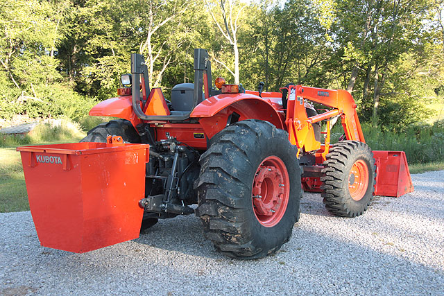

Hey everybody:

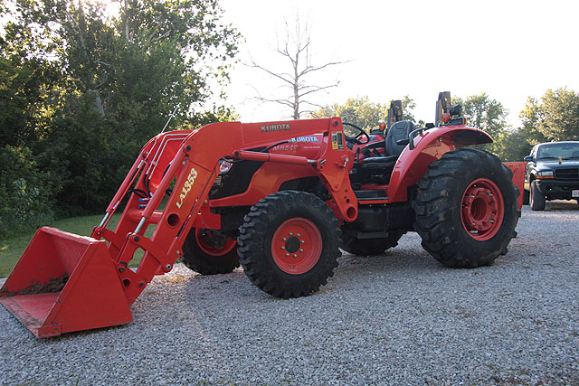

Some of you have inquired about my ballast box and wanted to see some pictures. It took me a while to get all of the parts to it (one of the lift pins was missing), but today I finally got it together. I have not filled it with concrete yet, however I hooked it up and snapped a few pictures. I also took a few of the tractor itself... but you can ignore those.:D
If you have any questions, fire away...

Very nice,! you might want to put in some PVC pipes for handle tools vertically before you pour the concrete. I put in 3, I wish I had put in 4:laughing: they sure are handy:thumbsup:

I have read a lot about that on this site. Sounds like a great idea!

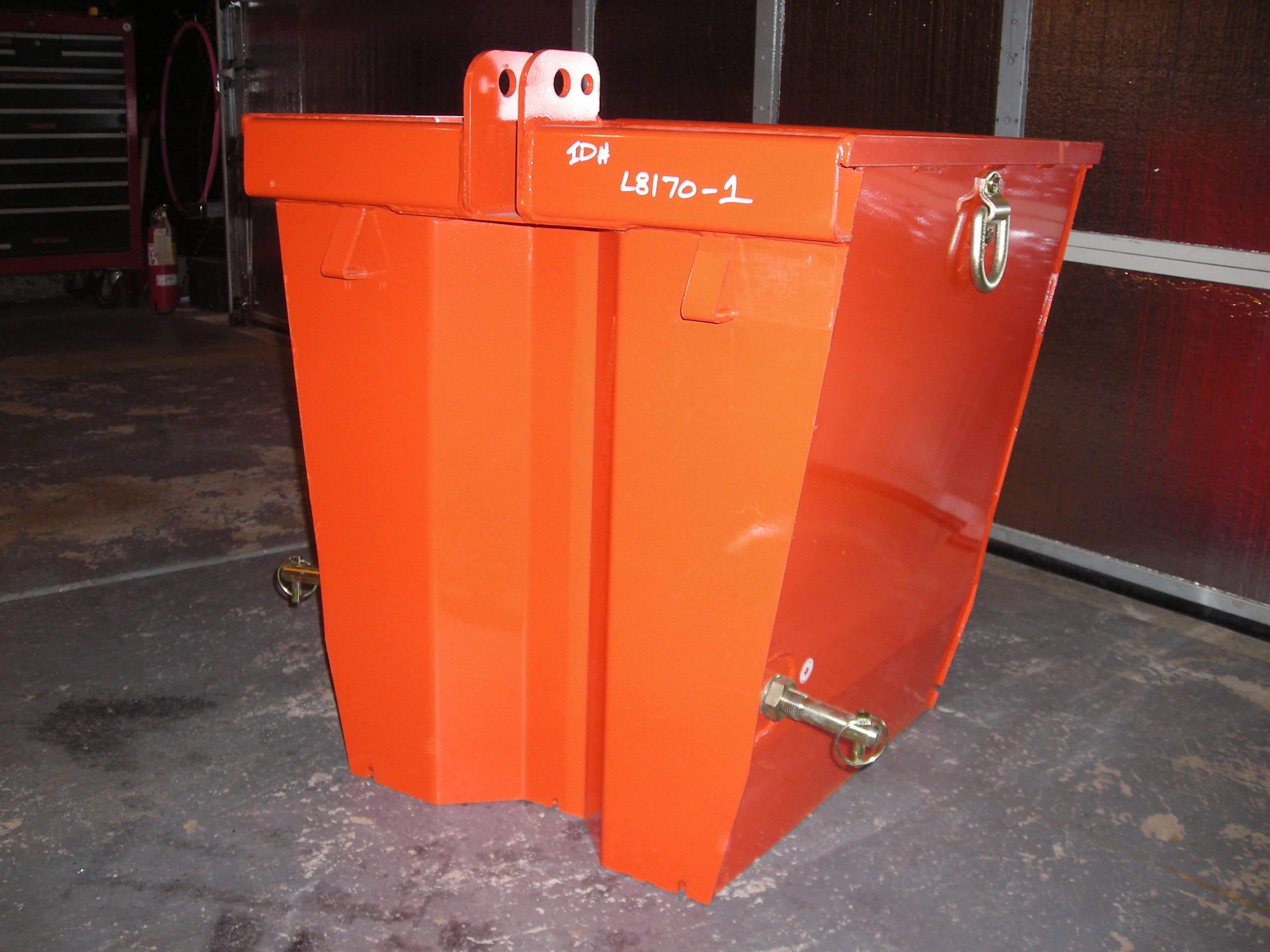

I just picked my ballast box up yesterday afternoon. RJ, I think we have the same box. My part number is for cat1, your part number is for cat2? I put tie down anchors on this morning, will silicon internal seams tomorrow, then off to the concrete company. Philip.

I see some subtle differences that indicates they are different boxes. That would make sense since the part numbers are different. The most notable difference I see is the channel iron that runs horizontally across the top that reinforces to top link attachment. On mine, my channel iron is 6 1/2" and goes below the top link attachment bracing.
I'll post another pic later today.
Here are the dimensions of my ballast box, measured at the top ID:
28.75" deep (front-to-rear)
28.25" wide (left-to-right)
32.75" high (top-to-bottom)
I figure it is around 14 cf and should weight around 2,000 lbs when full of concrete.
Kubota listed mine at $575. I got it for 15% off... so around $488. Not cheap for a box, but I don't have the time to make one and I like the looks of factory boxes.

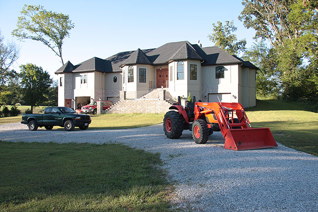

Thanks for the pictures, nice ballast box and house too:thumbsup:

Thanks for the compliments. I still have some minor trim work to do on the house, but for the most part it is finished. I spent all of 2008 and 2009 building it. My wife and I were the general contractors and I did about 75% of the labor. Concrete, exterior framing, roof, plumbing and front stone porch were contracted out. I did everything else.

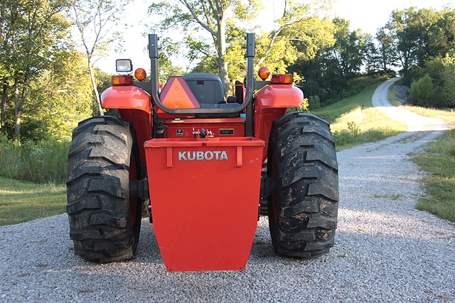

I have been ripping a bunch of locust trees out of the ground in my pasture. If the cutter is on I don't have much of a problem, but in tight spaces I leave it off. With nothing back there, my &ss end comes off of the ground when I am under the roots and trying to rip the tree out. Getting the bucket wedged under a root then curling the bucket really has a lot of power. I can't wait to get the box filled and start using it.
All in all, I love the M8540... it is very impressive. All of the golfers (we live next to a course) stop and watch when I am taking trees down.
