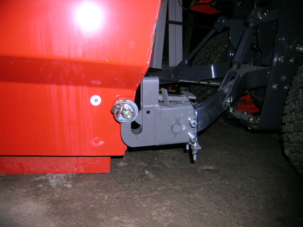

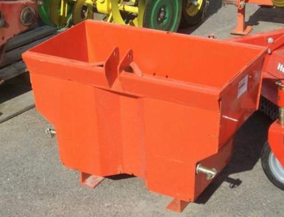

As stated, is the ballast box B8160 compatible to a 3pt quick hitch? Anybody using this combination?
   / Ballast Box B8160 quick hitch compatible? #2
That design Kubota ballast box fit my BX2660 3 point in 2009. But now, on my B2620 with a Quick Hitch, I can not make it fit since the dimension is so narrow. Thus, I remove the QH when the ballast box is needed. If another attachment, such as the Box Blade etc. is mounted, I use them for ballast, unless working space or more ballast weight is a factor. Maybe some of the more capable TBN members can fabricate a solution.
Cheers,
Mike
   / Ballast Box B8160 quick hitch compatible? #3
It is NOT compatible. The L series ballast box does not work with a quick hitch either because of the way the top connection is made. I was able to use the quick hitch on the bottom pins but I use a chain on the top so that kind of defeats the purpose of the quick hitch but it works for me.

No.
wrooster
