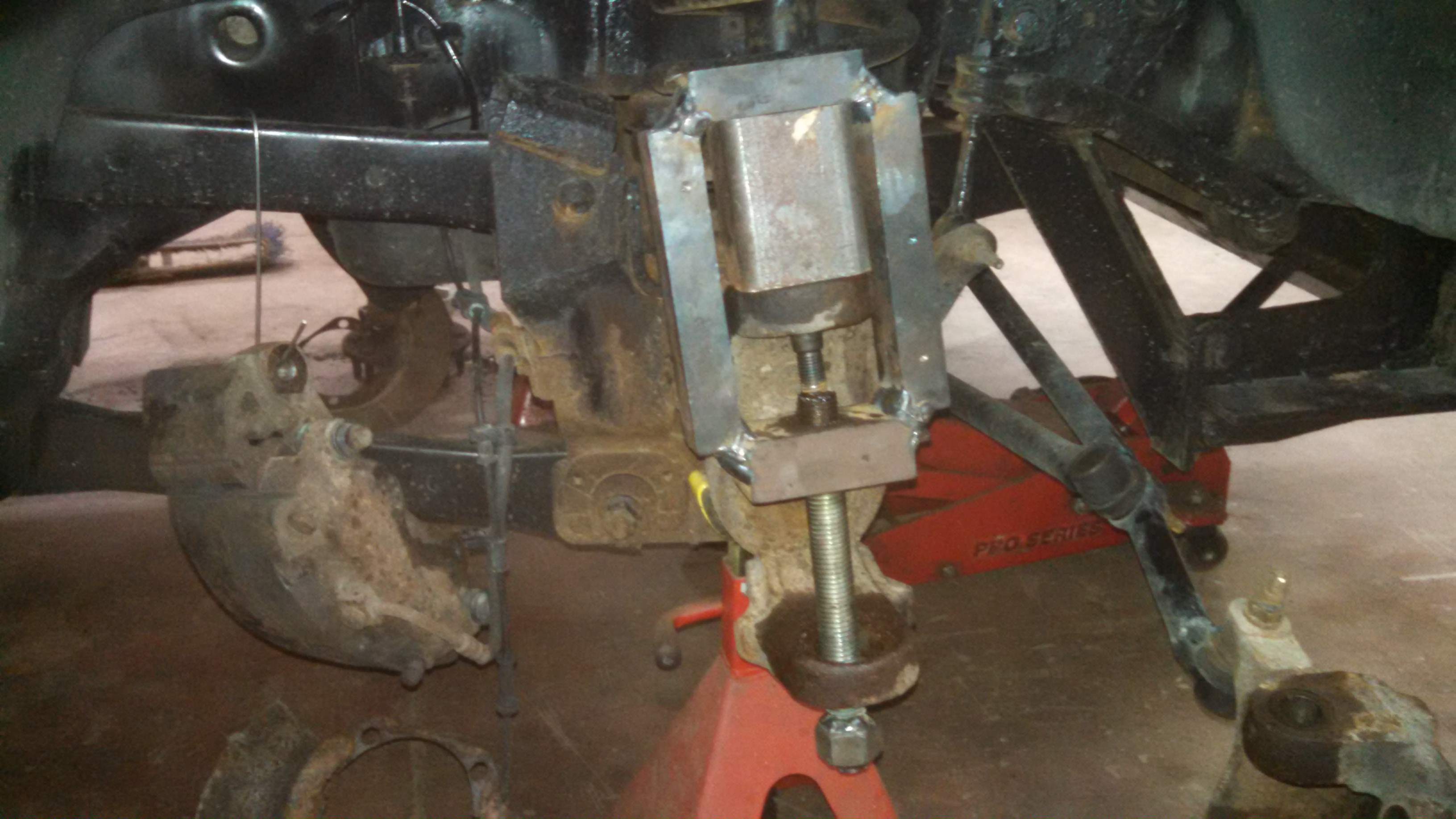

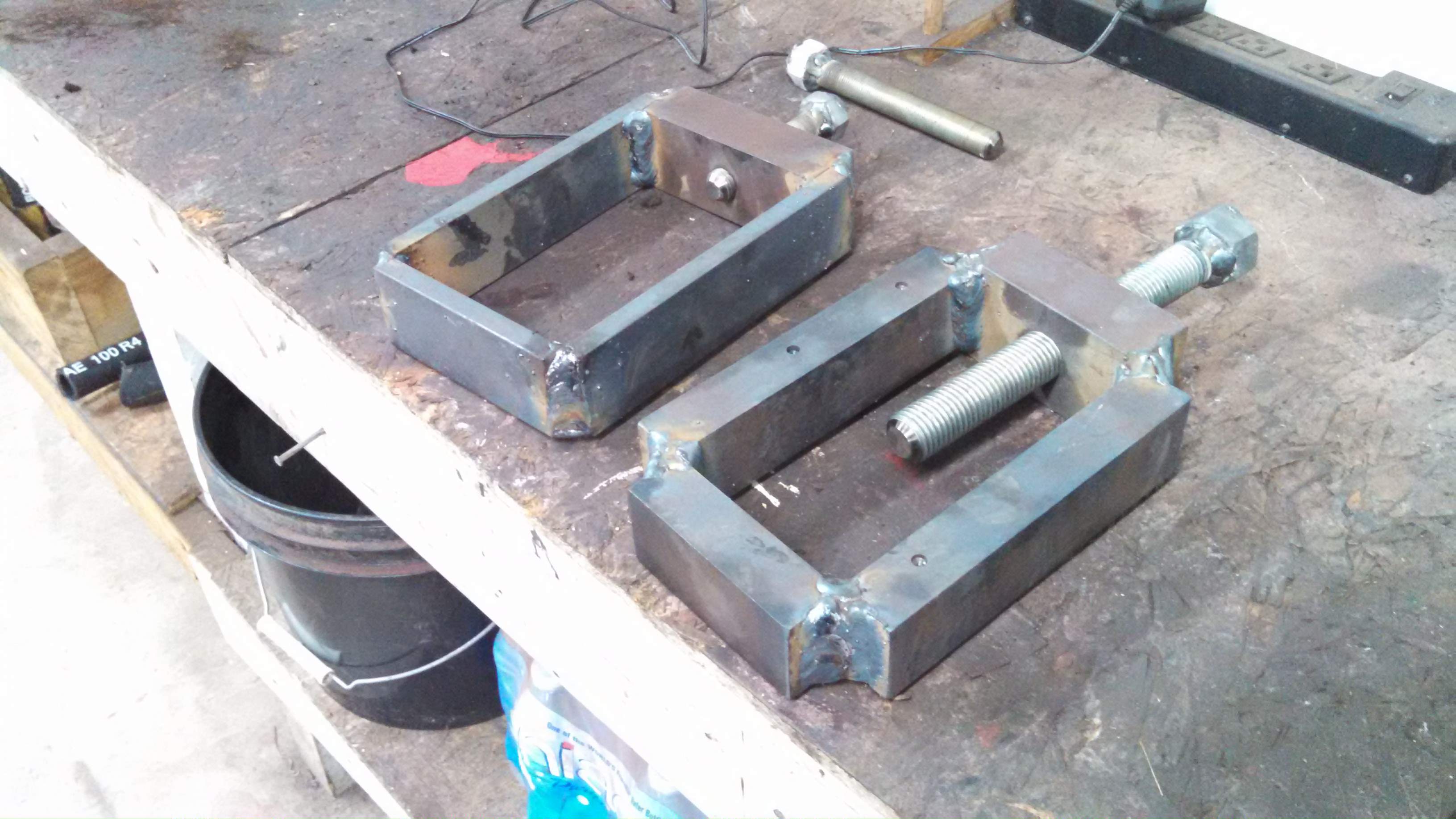

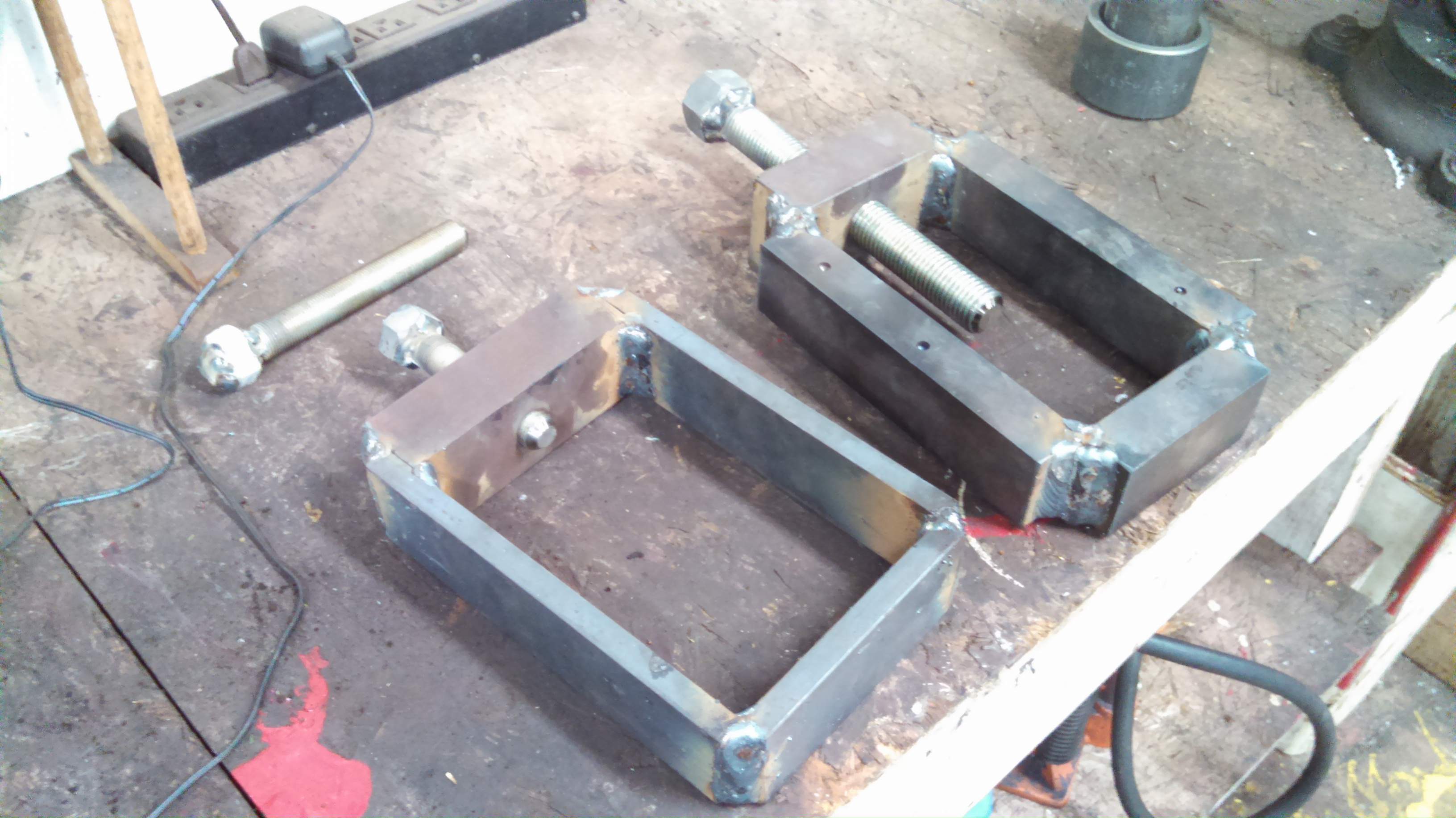

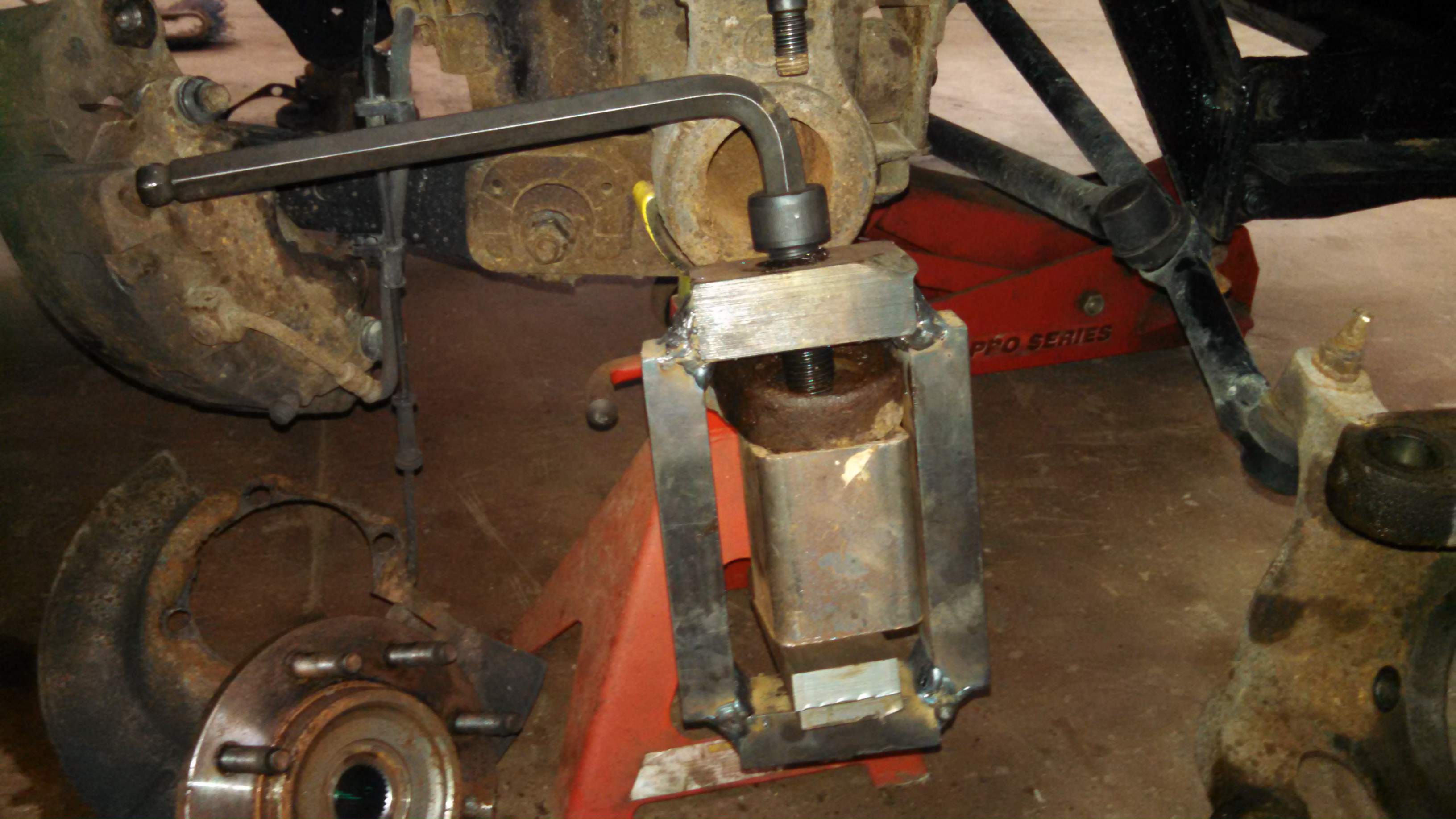

In preparation of the up coming task of changing the dreaded ball joints on my 3rd gen Dodge 3500, I made a home made press. Not the typical Cee style, rather totally boxed in.
Made 2 actually. The larger one is 1" x 2" bar steel, with the threaded portion being 1-1/2" x 2-1/2". Uses 1"-8 threads.
Smaller one is 1/2" x 2" steel with 1-1/2" x 2" threaded piece which is 3/4"-16 threads.
They worked just as I hoped they would. All the ball joints are out and awaiting the new ones to arrive tuesday.
Also work great for u-joints.
Just thought I would share. I know these are tough joints to pop, and didnt really trust a HF one (nor had the time to go get one). And didnt want to spend $200+ for a better set.

I was debating on going with fine thread or a coarser thread for this puller. Fine threads give greater pressure with less torque of the wrench, but by nature, the "meat" of the thread is smaller. It is damaged/dinged easier. So I was torn as to what to use to make the best puller. For the larger puller I made, it was easy, cause I didnt have any 1" fine thread rods or nuts. So coarse it was. So I opted for 3/4" fine for the smaller puller.
They really did work great too. Got lucky and had just the right length piece of pipe and spacers to make the job a breeze. I did ball joints a month ago on and identical truck with a decent store bought puller set. I like my set-up better.

I thought about the loaner tool, but even though it is free, driving 20 miles there and 20 miles back, TWICE, and the time involved....I wanted a more permanent solution.
I am unsure why so many of the ball joint presses are cee style. Boxed in like this would be much stronger. These didnt flex at all:thumbsup:

About the only thing I would have done a bit differently is to make ONE set with adjustable side brackets so you can squeeze the two uprights tight to the part.
Make two box shapes with 4 "T" nuts then use all thread to hold the two boxes together (slide the threaded rods close to the A-Arm so less bending forces when pressing.)
The center threaded rod would then be the press & could be thru a 5th "T" or welded solid.
I built a spring compressor doing it just like that using the center rod for keeping it centered and two outside ones for compressing the spring. That was a LONG time ago (1991 or so) and I DID find one of the threaded rods a while back but that was it..

I thought about making the sides adjustable, but then thought it through some more..
In practice, even if sides were adjustable, it would still be easier and quicker to just grab something to space up the bottom or top, or longer piece of pipe, etc. Like I did with the pieces of flat steel under the tubing in picture 3.

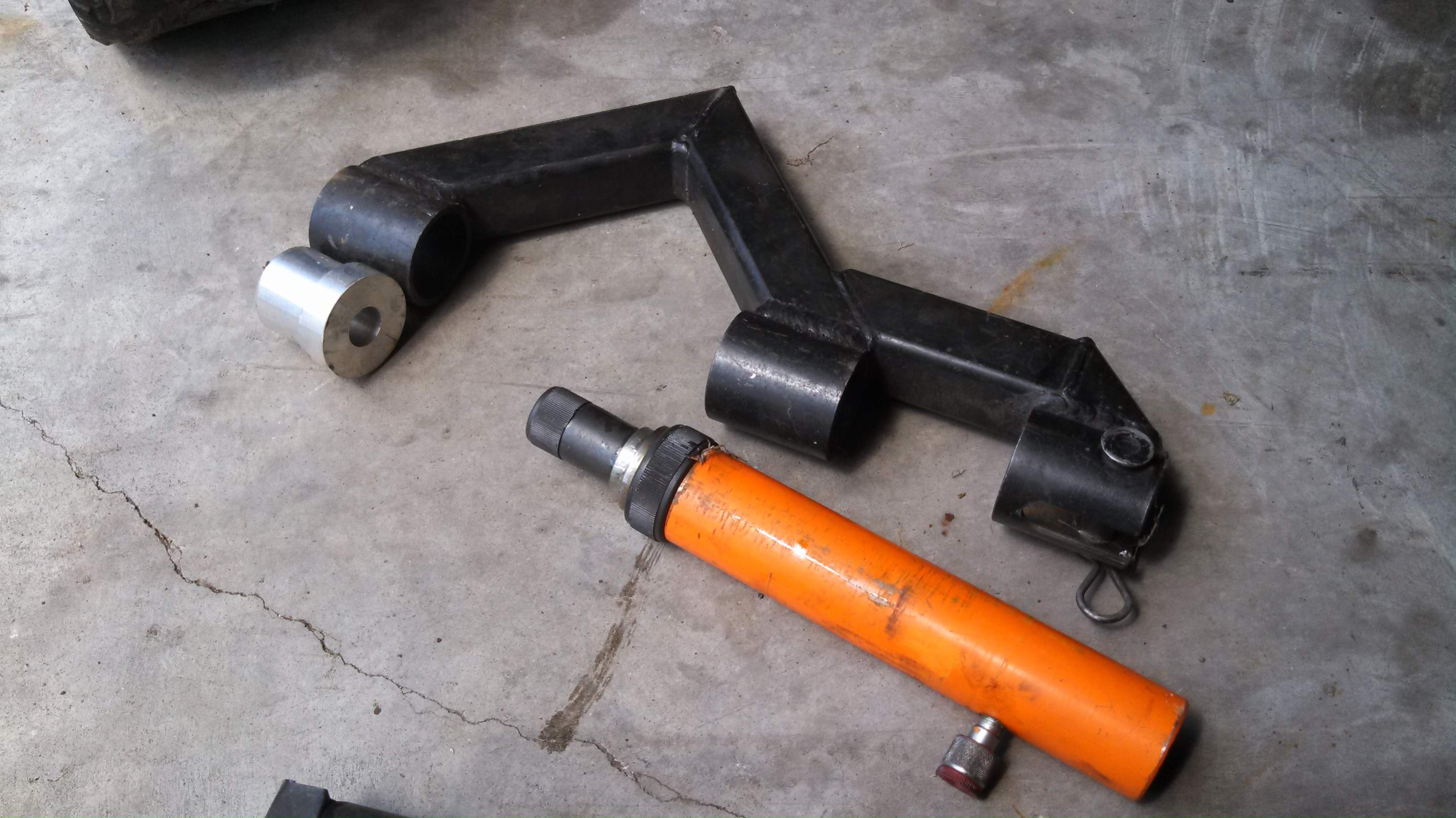

I had to make a "C" style to swap out a u-joint where the shaft could not be removed from the machine.
I used a 10 ton porta power ram instead of threaded rod.
The machined insert allows you to press out and in without having to turn it the other direction.
Not one of the things I use a lot but it works when nothing else will.
