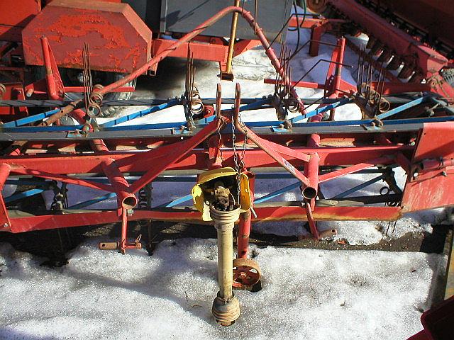

As for a bailer, based on my experience, I couldn't recommend a JD twine bailer. Mine was new, early 80's model, but spent far too much time making repairs. Broken needles, broken knoter frame and repeated bearing failures.
As for a rake, Don't know if they are imported any longer and was never a popular rake but the side delivery rake my Mads-Amby was a great rake. PTO drive, moved the hay to the side without twisting and had the ability to work like a tedder as well. Loved that rake and after using it, you couldn't ever get me to go back to a convientional side delivery model. The Mads used belts and articulated fingers to move the hay sidways and gave it a kick as the hay was discharged. I could run over a rain beaten row and the row would come out standing 2' high.
Here's a pic I found on the net.
