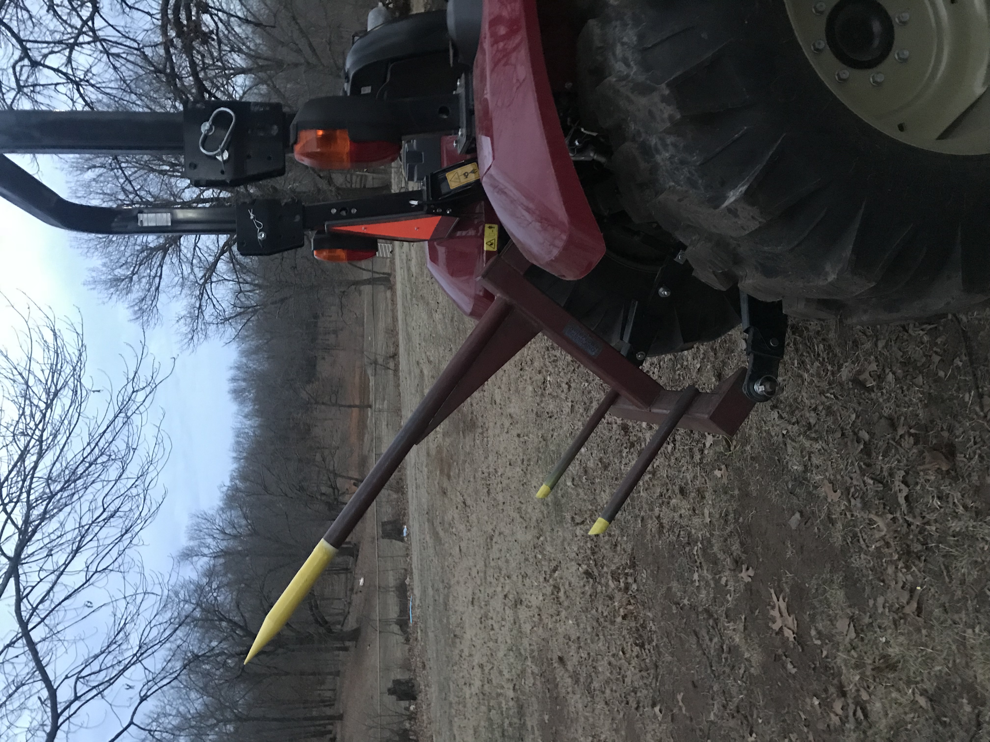

I stopped just inside the gate after dropping a round bale. Tractor safely in park, I hopped off and closed the gate securely. Spinning around I got a sudden jolt in my nose and found myself on the ground looking at the sky. Very thankful that I still have my right eye (even as bad as it is)
I really think the best plan is a cover for the tip that I can slide on after removing the bale. I keep the tip bright yellow and try to set it at the safest height. My property is crazy hills, and height or color wouldn't have mattered in this instance.
I have looked and don't see a purpose made cover. I am thinking of getting a horse 'Jolly Ball'. Cut a hole to fit then foam fill it. Chain it to the spear's frame.
Any other ideas?
btw, nose is healing nicely. My wife wasn't all in on a piercing, and definitely thinks I was best to forego the 4000 pound jewelry.

I took a piece of 3" back flexible drain pipe and cut it to fit over the spike. It's a couple of inches longer then the spike, and seems to work fine. I leave it on whenever I'm not using the spike.

How about a piece of pvc pipe with a cap on the end to cover the point
Plastic pipe. Really? That is the best you can come up with?!
No matter; it is pure genius. I made it in 5 minutes. It slides on super snugly. The cap is so thick that there is no danger of it being penetrated. I even had some heavy pipe that should stand up to being driven over.
Thanks so much! I値l post a pic tomorrow.

Slips on snugly. Won’t slide off.
I will paint it with plastic paint to slow UV. Will be nice to store as well.

I was going to say pipe but I'm late to the party. What I usually use is an orange highway safety cone. I just slide it over the spear so it's blunted and highly visible. I started doing this when I saw my dogs running around near the spear when it was sitting on the ground behind the shed.

Well as usual I'm late to the party but I was going to suggest asking your local FD for any decommissioned fire hose. Cut to length then just duct tape, staple, bolt, glue, or whatever one end shut and make a scabbard for it.

Looks good, But still waiting for my check :D
