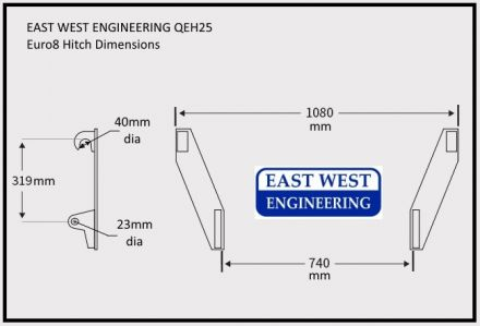

Not sure how we got off on this tangent but... any of you guys ever see or use the European quick hitch which is triangular in basic shape? It is like 2 pieces of C-channel on the implement (like a triangle with the bottom piece missing) and a full 3 sided triangle on the FEL that is centered on the loader. The Triangle is male and the implement socket is female. Roughly 2' on each edge as I recall. I saw them in Austria in 2000 and was amazed how simple and easy they hook up. Self centering. Once you raise the FEL triangle vertically into the twin C-channel socket on the implement all you do is put in a pin (or 2?) and you are hooked up.
What is the name for that system? Is it still in use? Any in the USA ?
