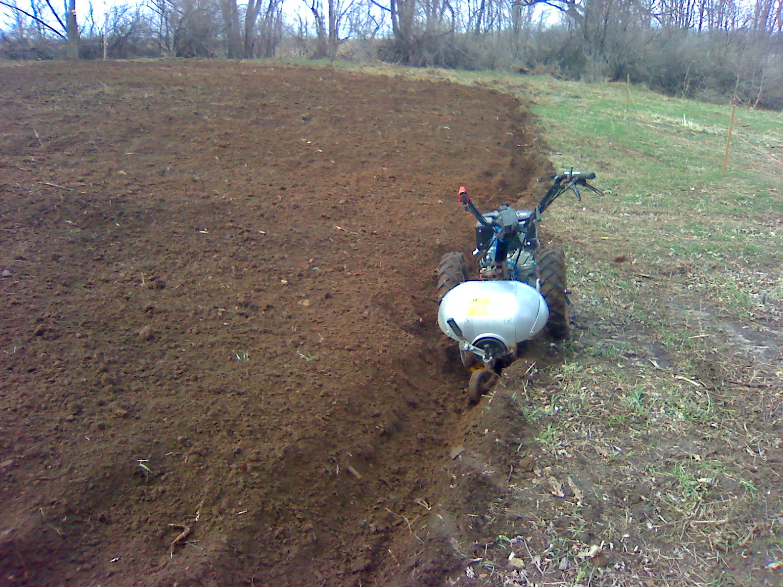

I purchased the single Berta Rotary Plow late in the season last year to go with my 853 that has the 11hp Kohler Lombardhi diesel and the larger wheels. I didn't get to put a lot of time on the setup but my gut feeling is that I might need more extension (or weight) on the plow. I do have the quick couplings which add some length.
Does anyone have this same setup, and have you added an extender to help hold the plow in the ground? I know this would result in more strain in lifting the plow for the turnaround on the row ends but it seems like a valid tradeoff.

Hey Ray,
Have you mounted the plow yet to see where it balances? Mount it now, tip the machine so the engine is tipped forward. If it comes back to the plow, it should be close to perfect - just a little weight to the attachment side. If it tips to its nose, you may want to consider an extension. Just keep in mind that an extension gets the plow that much closer to your toes!
I have the double plow with the 11 hp Lombardini on a BCS 850, and I need to put 50 pounds of weight on the engine side to balance it.

Farmerboybill: Thanks for the feedback. The ground I was breaking had very thick turf and has not been plowed for decades. I wanted it to work like this
but it sure wasn't happening! I had to raise the handlebars and push downward on them the entire row. The ground must be softer in Italy LOL. I did find a big part of the process is getting the first pass correct regardless of how much time it takes, because any discrepancies (left/right or having the plow come up out of the ground) gets transmitted to every following pass. The times I tried the plow in previously plowed went much better.
You had a good point about the extension putting the plow closer to your feet. I really hadn't thought that part through. I will probably just figure out a way to hang some weight on the plow if I think I need it.

Sorry, I misunderstood. I didn't realize you had tried it already.
The biggest thing you need when plowing is adequate soil moisture. It will dig through powder dry soil with a lot of work, but it will do MUCH better with the soil moist, but not wet. I attached pics of some jobs I did with mine. The ground was in good condition with adequate moisture, but by no means perfect ground. The first pics shows my F-I-L's place. This was next to a building that had been a farm implement dealership in the 50's-70's and was where customers parked. There were spots near the building that were 80% gravel covered with grass. The second job was a sandy area where a bunch of junk trees had taken over. The trees had been grubbed out, but there were plenty of roots and sandstone rocks left over. I hit a few that killed the KD440 diesel engine, but did no damage to the attachment. The rotary plow is an amazing attachment.
Another thing to be sure of is the track width of your tractor. You technically only need to change the in-furrow wheel, but most change both. You really want the furrow wheel to be 9 inches from the center of the tractor to the inside of the wheel. More, and you take too big of a bite. Less, and you take too little of a bite.
I recommend you go an soak the ground with a garden hose if mother nature doesn't cooperate. Give it a day to dry out after the soaking. You'll find the results more to your liking.
