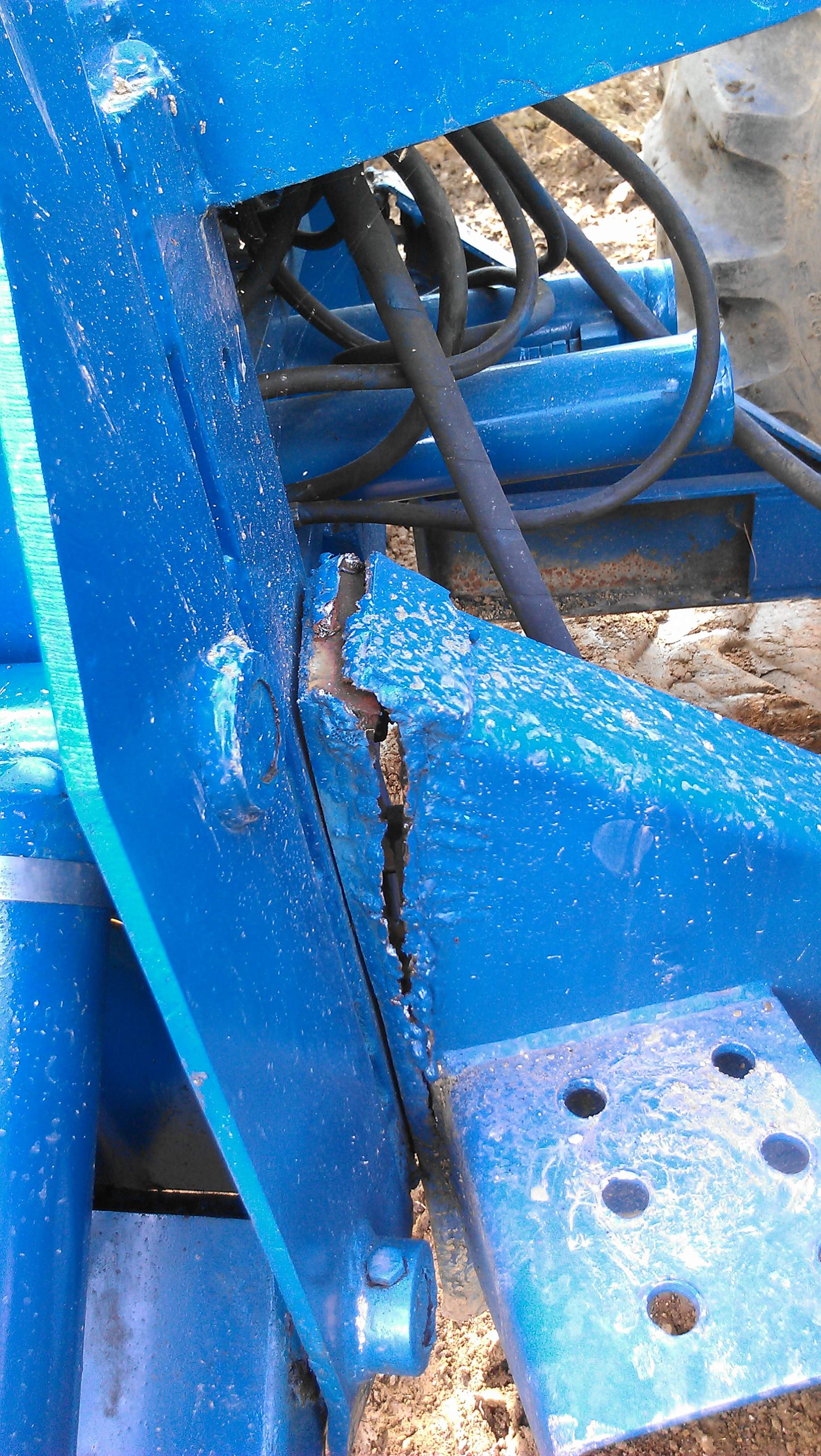

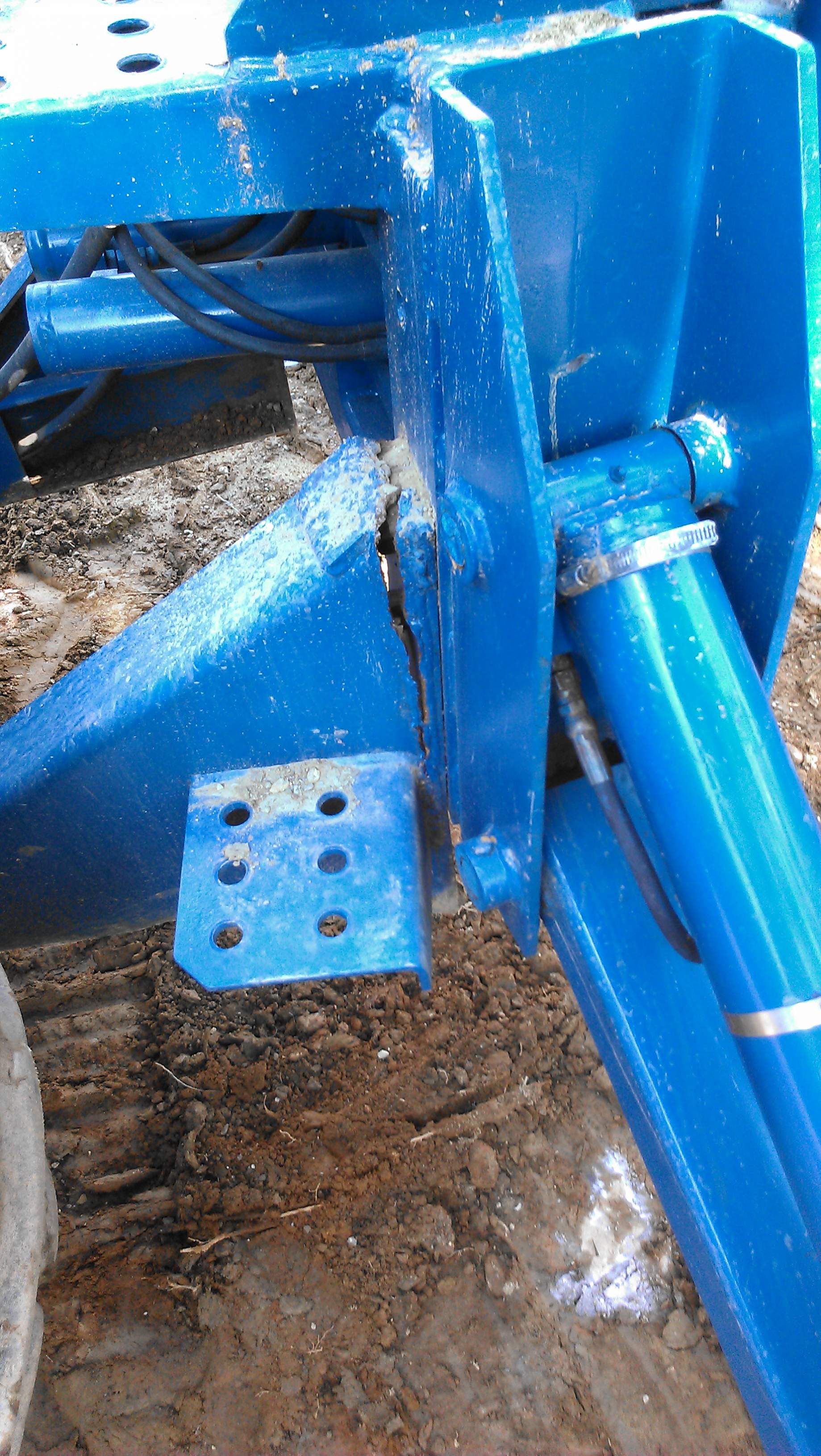

I just bought a 2000 Ford 2120 with backhoe.
When I used it Saturday some welds broke on the mounts. These appear to be the only connecting parts between the tractor and backhoe. Is there something missing, or if not, is this a common failure, and what is the suggested repair?

What were you(or someone else) doing to make that happen? Did someone have something heavy in the BH bucket then lift the stabilizers? I had a Woods 7.5' BH on a 1715 and beat the heck out of it, it would toss that little tractor around pretty good. For the fix, I would grind it really good,maybe try putting a big clamp, chain or binder on it and reweld. If that doesn't work maybe you can back up to a tree and push it back into location to tack it?
/ Bakhoe Mount Failure on Ford 2120 #3
Looks like pretty crappy welds! Have a qualified welder take a look at it. Should be able to beef it up and or gusset it. Doesn't look like too big of a job. I ripped the top swing mount right off the backhoe on my Cat. It in turn also bent the 1 1/2" thick bottom swing mount. It broke because it was a poor design. The crack started along the hole for a grease fitting. I fixed it myself but I'm sure it would have cost at least a couple thousand to have a shop fix it. The swing pins are 2 1/2" diameter.
/ Bakhoe Mount Failure on Ford 2120 #4
Not factory welds there. It's a repeat failure after a crappy repair. And no, that's not a common failure point in my experience.

A little more detailed pics would help, but I agree with the other assessments that it is a crappy repair. The welds look a little to bubble-gummy to be factory.
Not the hardest thing to fix if you can weld. Otherwise a call to a local welder will get it fixed and re-enforced correctly.
/ Bakhoe Mount Failure on Ford 2120 #9
Is that a clean new break or did it break prior to you buying it? I can't tell from the pictures. Does the weld on the other side look the same? That may tell you if it was factory. My guess is the same as the others, a cheesy weld job by the previous owner and paint to hide it.

I can see porosity through the paint! Yeah... not the best welds;)
/ Bakhoe Mount Failure on Ford 2120 #13
Agree with others who say those welds look bad.
When you get a welder to look at it, have them inspect it for any other weld "repairs".
Hope those were the only ones.
Good luck and let us know how it turns out.

Just a follow-up, I had it welded this past weekend, and it was pointed out to me that it is missing a 3rd link, which may have prevented the failure. The welder is going to source a 3rd link for me as well.
