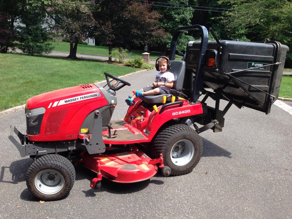

I current use a Massey Ferguson GC2400 with a PTO powered catcher from Protero. It's hard sided and quick dumps form the seat. They make a bigger model with more capacity. After that, you are looking at a tow behind model (trac vac, cyclone rake or similar).

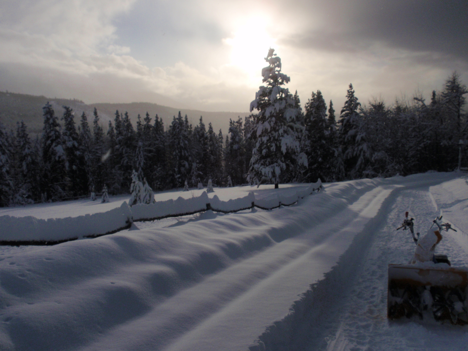

Some snow pictures-from more typical to extreme:
The current snowblower (BCS 853 with Berta 32" - works, but rather small for 1 km driveway and eats shear pins):

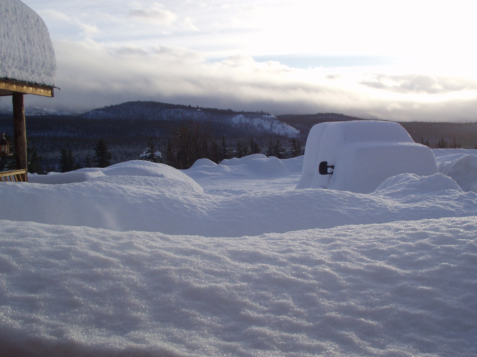

A more extreme overnight snowfall (nearly 2', wet, happened twice in a week causing an avalanche over lower driveway)--that F350 was clear of snow the night before:
Back when that happened, all I had was a snow shovel...

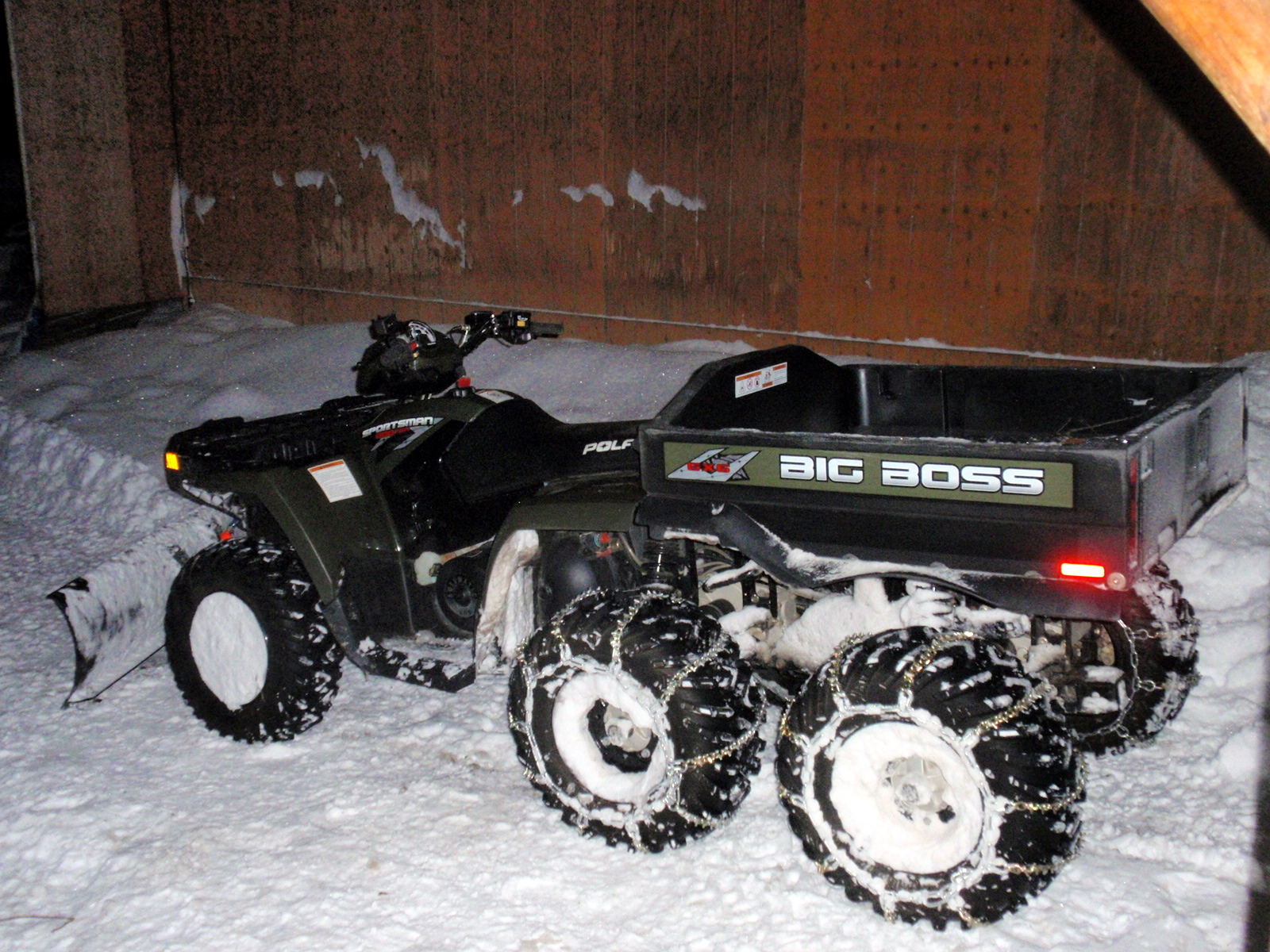

The other current snow tool is a Polaris Big Boss 6x6 with Polaris plow. It works reasonably well until banks get too high, too much snow falls at once, or snow is too wet. Overall, it's small for the job and it shows in repairs I've had to make to plow mount, etc:
