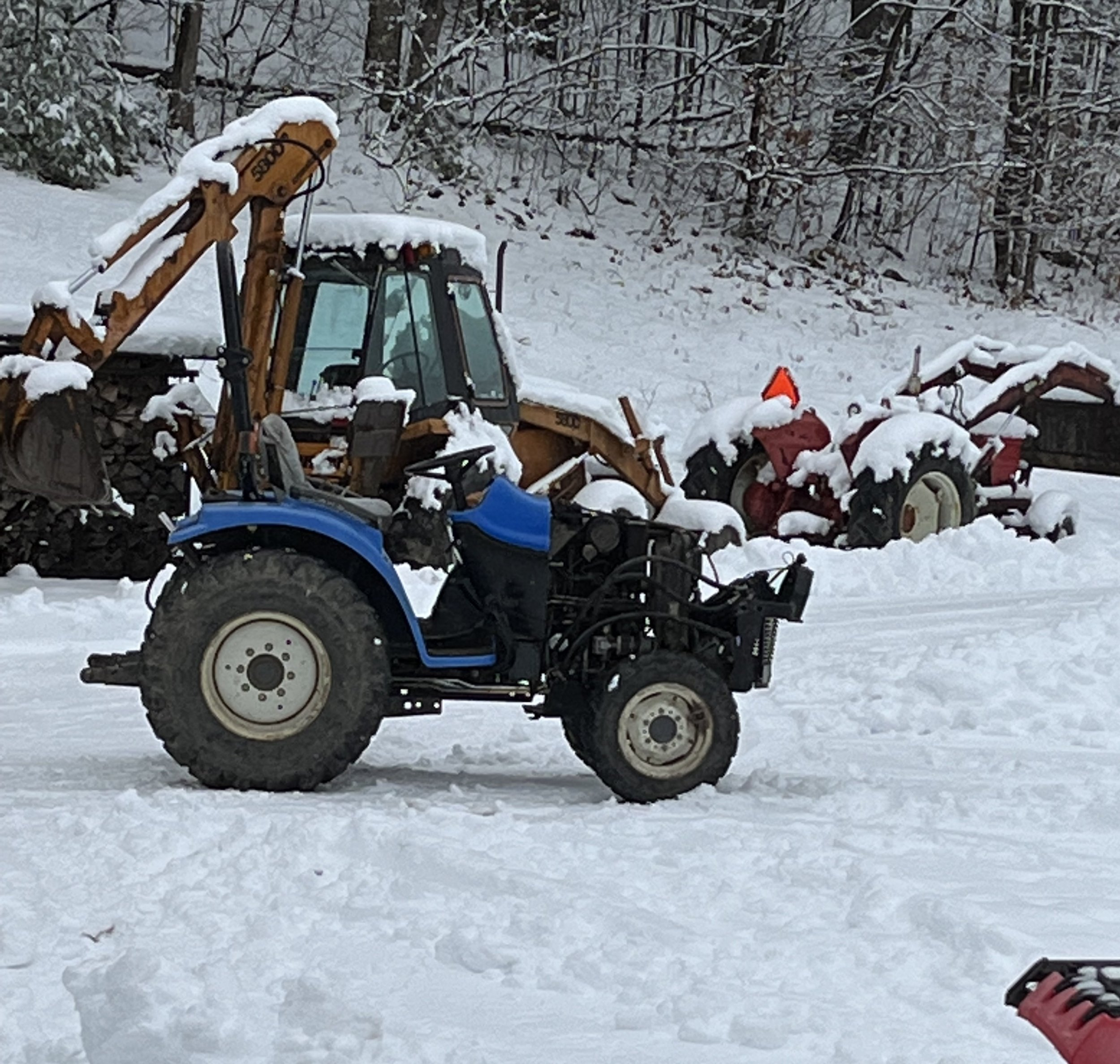

I ordered a used casting from Long Lane Tractors in Elizabethtown, PA. The tractor is mostly back together and the repair guy has given it a test run. No leaks, seems to be working well. Need to make an adjustment to the HST: If I push it back to neutral, it will stay there, but it won't return all the way to neutral on it's own (but that's a problem it's had for some years now... it would just get close and then creep a bit unless I gave it a little help finding actual neutral.)

   / Bad news on my TC33D #58
You'll be back posting pictures of your tractor and wood in no time. 👍
   / Bad news on my TC33D #59
Good deal and now you have a working machine again.
Good decision to repair and nice you have a local guy that takes on these jobs.

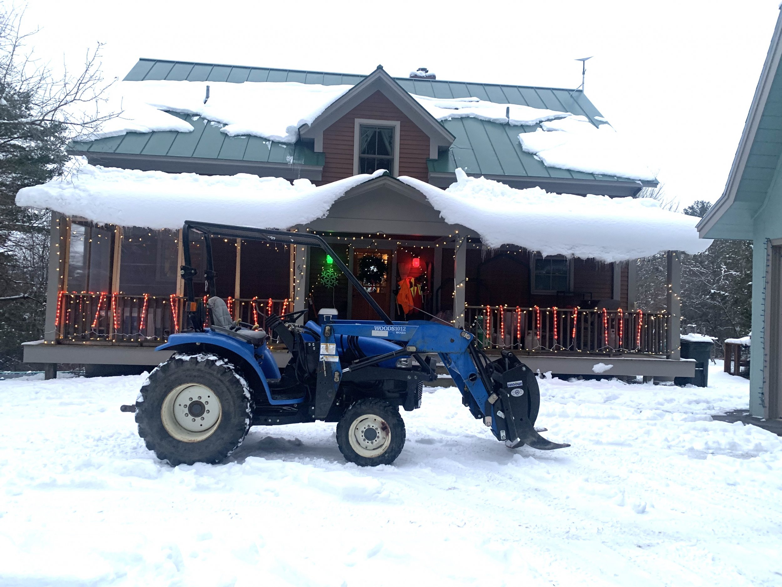

All back together and back home from the shop. I don't have the final bill yet, but it will certainly be well under what the dealership estimated.
Need to put the chains on and swap to the bucket to clean up the driveway a bit tomorrow.
