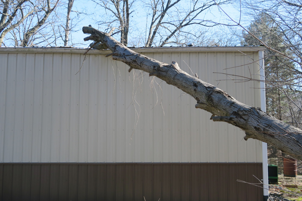

Since it's dead, Once it was trimmed down to this I would have seen if the loader would lift the end off the shop just a little and trim more off until maybe it cleared the barn.
Maybe even cut sections out of it to reduce weight more.
Not a snowball's chance in hell that loader would have lifted the end of that tree off that building. That looks like a pig hickory. If it is, at that size, we're looking at a tree that could easily weigh as much as that tractor does, or more.

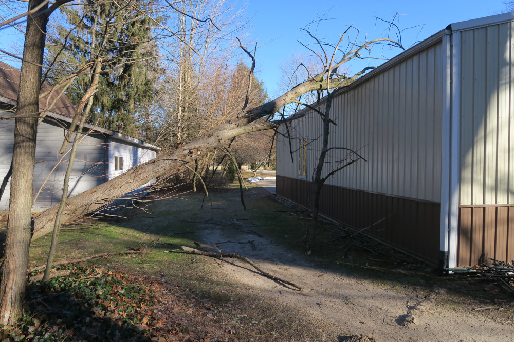

It's an oak and, yes, my tractor couldn't have lifted 1/4 of it. I cut it at about shoulder height, hoping it would drop to the ground and the top wouldn't hit the barn too hard. If I could have safely cut it up by the gutter, as someone suggested, the full weight would have dropped into the wall and probably gone right through it.
Yup. I did this stuff for a long time. As a tree guy, if I'd have shown up to look at that job, my goal of course is to do it with zero further property damage, which is why I would have brought in a bigger machine. I knew that tree would more than likely hit the side of the building if you tried to do it as you did. As the property owner though, you've got the option to accept further property damage that ultimately will be cheaper than the bigger machine would have been, particularly if you're able to do the repairs yourself. Glad you got it down safely. (y)

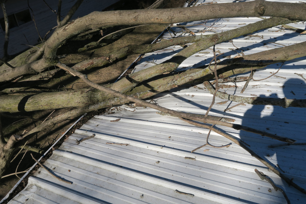

You insurance co. may be your best bet. I say this because from the picture the roof is bent below the bottom Purlin which means if you do have structural damage it will be the eve strut ( and possibly the Purlin) The Eve Strut is much more detailed than a purlin the eve strut ties the two bays together supports the roof sheet as well as being the component that the top of the wall sheets are secured too. To change the Eve Struy all the wall and roof sheets must be unscrewed if you have the typical vinyl backed insulation it will need to be detached from the eve strut and replaced but on the other hand from the picture you may not have enough damage to go to the expense to replace all this. Oh well just an obersrvation from an old building erector. After all it is you call I hope all goes well for you.

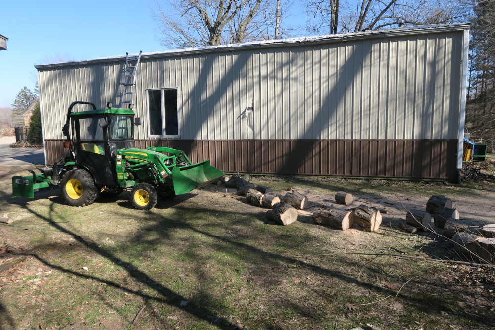

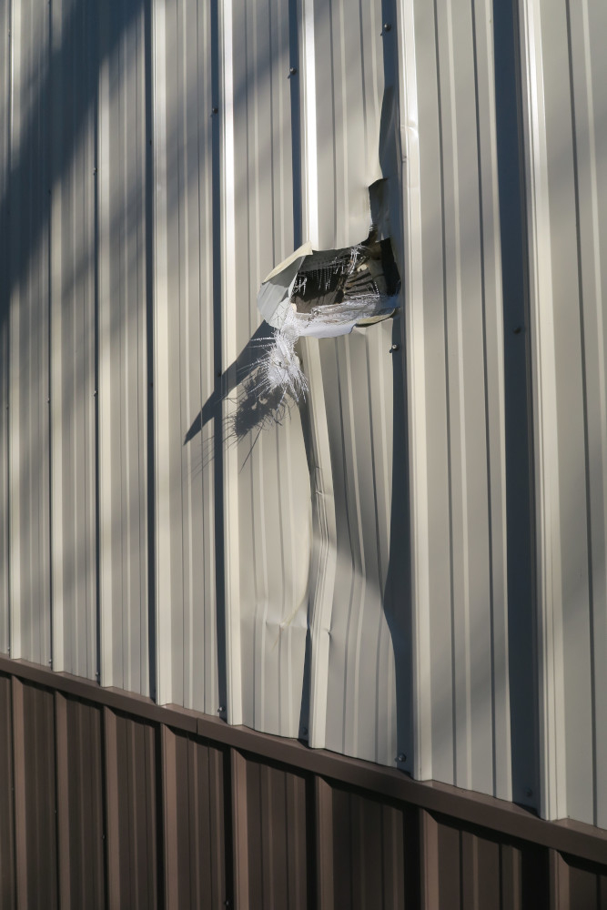

A quick update. All the wood is cleaned up and I've ordered the replacement metal. Should be here next week. I haven't taken the damaged roofing off yet, so I don't know if the eave purlin is damaged, but if it is I think I should be able to scab in a replacement. Fortunately I have trusses on 4 foot centers, which takes away a lot of the structural concerns with the purlins.

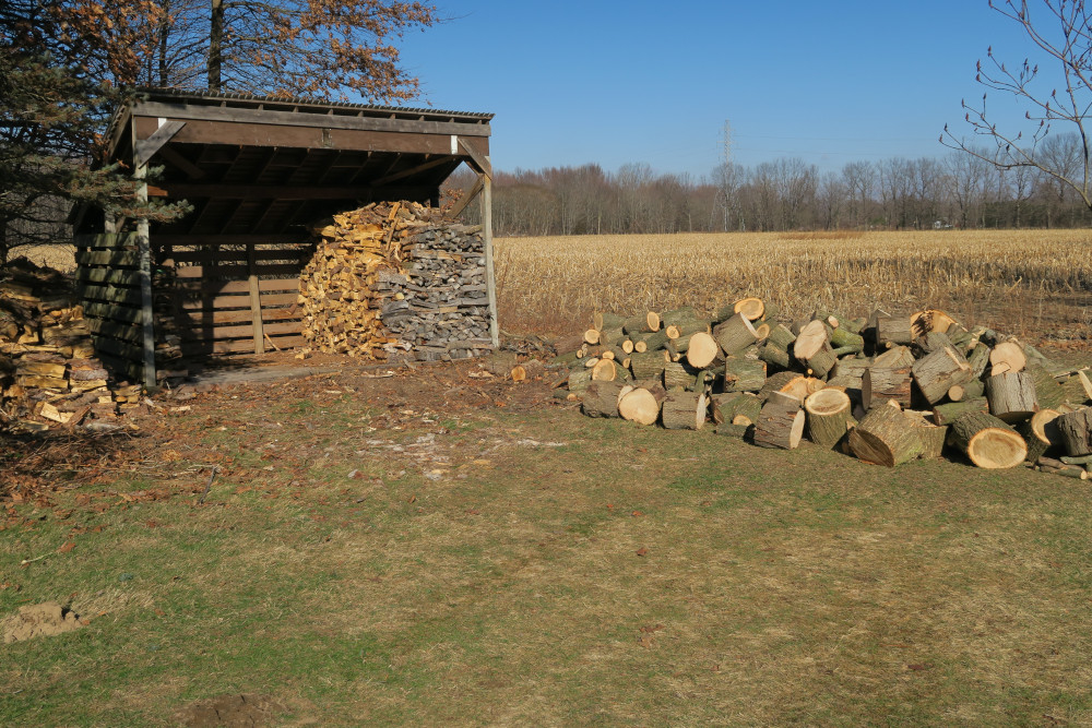

More to come. Silver lining in all this is that, combined with another tree I took down last month, I'm about set to restock the firewood storage.
That was my first thought too.. .particularly, to avoid the ding-in-the-wall problem. Was it too heavy for the loader?
