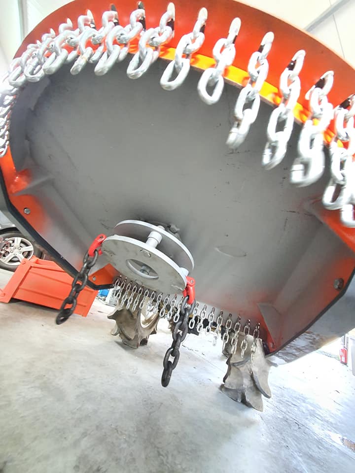

Looks like you could use one of our brush mowers we use around here. These things will just plow through everything and just won't care as the chains will just skip over it. Yeah, it might slip the clutch or snap the shear pin on harder hits but that's about it.
We mow brush with these mowers with 40 or 50 HP tractors that most people in the US would only dare to use a skidsteer and mulching head in those conditions.

As far as using the loader technic, I also do it but only on land that I know and have mowed before. Mostly just to knock the tall brush down to prevent scratching the hood or something.
f I'm mowing for someone else on land I don't know and the brush is taller that 2 or 3 ft, I simply go in the reverse and let the mower take the hits. After all it's cheaper to fix a brush mower than something internal or external on the tractor. If the brush is taller than 5 or 6 ft, I usually go in reverse with the mower about a foot off the ground till I can't go anymore, then just go forward with the mower all the way down.

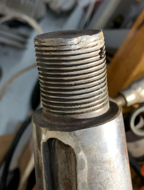

If you keep the stumpjumper castle nut loose enough then BOTH Blades (and the stump jumper) will eject and you won't have that horrible imbalance! Well, ahem, someone mentioned that to me. BTW - A stump jumper plus blades ejecting from a 6' RC doesn't travel as far as one might think (though mine went far enough into brush that it was a hunt to find it- my trusty "bloodhound" found it)
Loose castle nut? You are kidding, right? I had a castle nut come off on me because debris took out the cotter pin, then the nut came off and the stump jumper fell to the ground. Here are the threads on the $400 shaft.
I ended up spending a few hours removing the shaft and putting it on my lathe and cleaning up (re-cutting) the threads. Not fun, but the Mrs would not understand that kind of expense.
To make matters worse, this was the center cutter on my 3-cutter batwing. The two outside blade sets did a beat-down on that center stump jumper. I can't find a picture of it, but the 1/8" steel pan was mangled.
