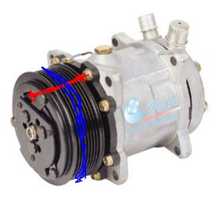

After almost $200 spent on tools, driving almost 200 miles. All for noting but frustration.
Could not find the video that I first watched on doing this job. But fund one similar.
Metric sockets do not work, must be sae, Nope they don't work either.
Get mirror & look down the hole, there is a C ring in there not a nut.
Video shows a special puller that screws into clutch. Not any kind of puller that most shops would have.
Look on line, yep there they are, as part of a complete kit with many things I will not need. Give or take a little $28 + shipping & tax.
Will also need C ring spreader pliers. Only another $23 + plus shipping.
Time for a beer & think this thing over. Order tools? Pay to have it done?

As for the A/C compressor, I'm not sure how your truck is but on mine it is somewhat high so I can unbolt it and move it to where I can see the front of the pulley without removing hoses. Makes life much easier. I used a couple 2" bolts and a nut just under the pulley to push it off. One on each side and a big hose clamp to keep them from popping out, just turn each bolt a bit at a time while holding the nut. Pretty crude pic below but the red is the bolt with nut just under lip of pulley and tip against the compressor housing. The blue is the hose clamp to hold the bolt in place. Thinking about it, mine has a C ring too.
   / Bad Day at Block Rock - errrr - Make it Bad Year. #516
If you are replacing the clutch, just pry it off with 2 small prybars or large screwdrivers (after the circlip is off...) The new one will go on easy enough. You aren't trying to save the clutch after all. But whatever you do - SAVE THE SHIMS!!! You may not get any in the new kit (or wrong size) and you need to set the clutch gap within reason.

Early this am gave it a try. Even sharpened up a wrecking bar & gave it a try. No luck it would not budge.

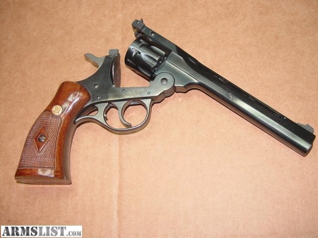

Look like this?
Last time I looked for one of those it was called the "Sportsman" and they (H&R) quit making them.
I bought a Ruger Mark II instead.
