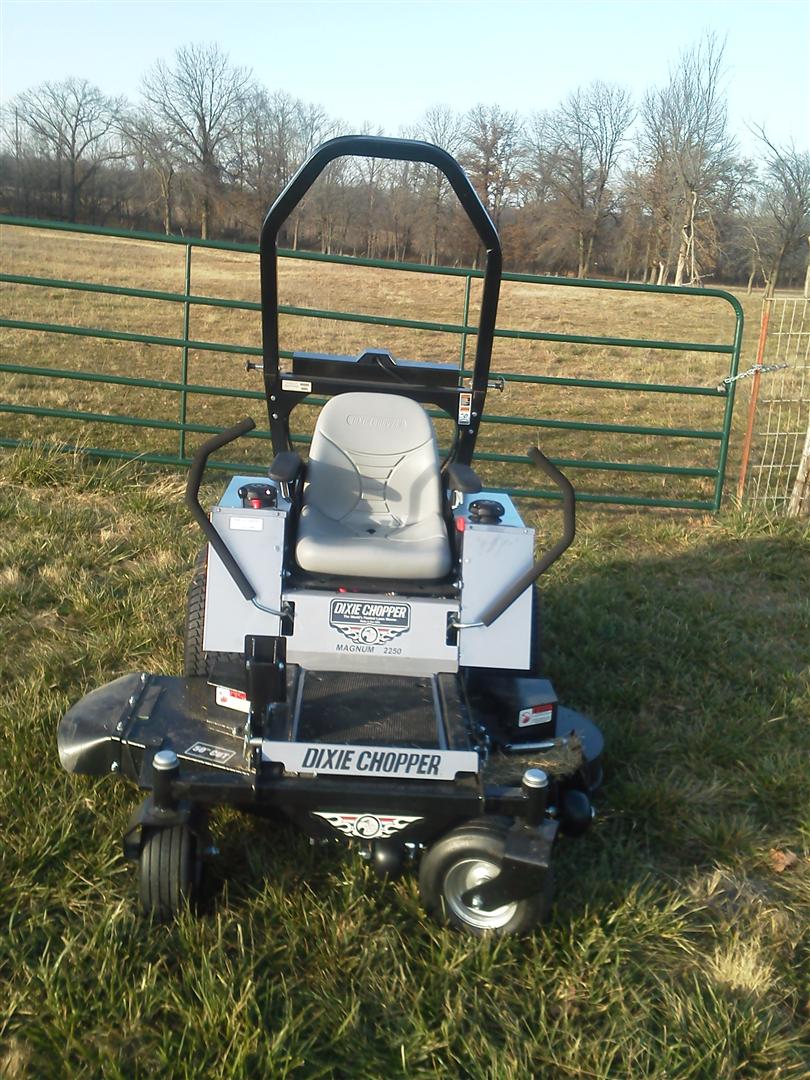

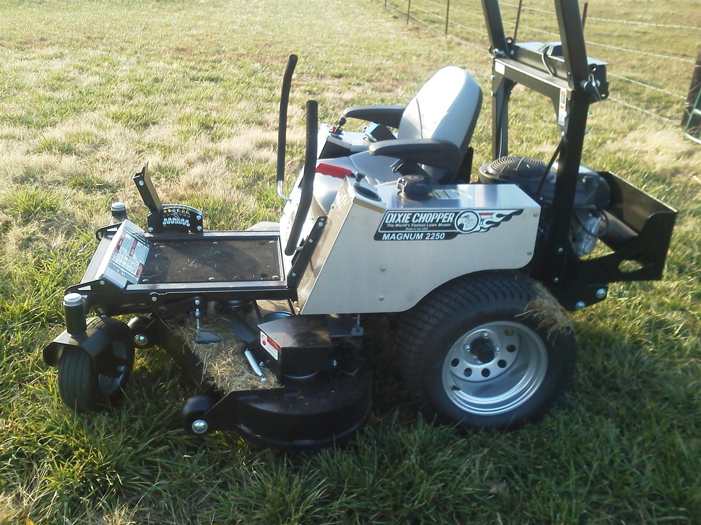

Yep, I pulled the trigger on a 2013 Dixie Chopper Magnum 2250. That is 22hp with a 50" cut. :cool2::drink:
Smaller engine than my Craftsman but doesn't bog down at all like the riding mower.
Weird was the Craftsman had a 54" deck and it fit on my 5' by 8' trailer, a little tight with the chute held up, but the 50" Dixie is just as tight if not a bit tighter.
The Craftsman deck is just a one piece shell with 3 blades. The Dixie has baffles and channels under the deck so the cut is smaller but the deck is bigger.

Funny thing was I just got the mower back to the house and "had" to test drive it.
I had about 15 minutes of mowing in, which covered a lot more ground than the old mower, and the sound/power of the blades changed?
It seems like they just wasn't getting as much "power". I would stop and the blades would speed back up...move forward a bit and they would slow back down. The motor never changed its sound, never bogged down. :confused3:
I called the dealer and he said he is on his way to my place. When the dealer guy showed up, he took it for a spin, adjusted a belt a bit but it didn't make any difference...still did the same thing.
He said, it is not right, he would bring the trailer by in the morning and pick it up.
Well, they dropped it off a few hours after picking it up and it runs great! You'll never guess what happened?
What happened you say? Well, I'm glad you asked.
He couldn't figure out what was going on so he was going to go back to the basics and took the belt off, once the belt was off the drive pulley fell off....it fell the F off...he said he never seen anything like it.
The main drive pully is connected to the clutch with 4 bolts and all the bolts had come out?! :shocked:
He said he check his other 2013 models and they all had loose bolts, from the factory.
So even the "Fastest Lawnmower in the World" can be slowed down by Quality Control.

I have found that, for my needs, the Dixie Chopper doesn't "cut" it. :(
What I expected from using my cheapo Sears Craftsman mower, Snapper and even the belly mower on my Kubota, is that when I would drive over grass...it would be cut.
The reality with the Dixie Chopper 50" magnum, other models may be different, is that with the baffling under the deck the grass, if long enough, will just be pushed over and protected from springing up into the the blades of doom and cut.
Both my old Snapper and Sears had just a stamped deck, all open with the blades cutting anything that would pop up. The belly mower on my kubota has the front half of the deck open and only half baffles on the rear of the blades. They all cut great.
The Dixie is fully baffled, I've used single blades, x-blades, double blades, blades 1" shorter, but always get the same result. Rows of uncut or nearly uncut grass, so there would be like grass mohawks or just plane uncut grass.
Now granted I'm using the mower in, usually, tall grass by the time I get around to mowing it (shift worker). Some of the "yard" use to be pasture land. The grass can easy be 6", 12" even 24" in some spots before I can mow it.
I've even mowed over weed plants, you know with those little seed heads on top of a long single "stalk", and look behind me and they would be totally fine, seed heads still attached. :mad:
The grass would be to tall for the other mower to take on so I had to hook my belly mower back up, not my favorite activity since it took hours to hook up the drive shaft (trial and error, dealer never gave me a manual) Grr! The half baffled mower deck knocked down everything without a problem, even with the deck set on 3".
This isn't to knock the Dixie, it is a very fast mower when mowing slightly tall grass. When the grass is taller I've had to mow twice and sometimes three times, knocking the grass down a little farther each time. Mower deck set as high as it would go or 3" didn't seem to matter.
If Dixie made an unbaffled deck that I could change out I'd do it but as it stands I might be getting out the old grinder this winter and trying to cut some of the baffles out in the front of the deck.
