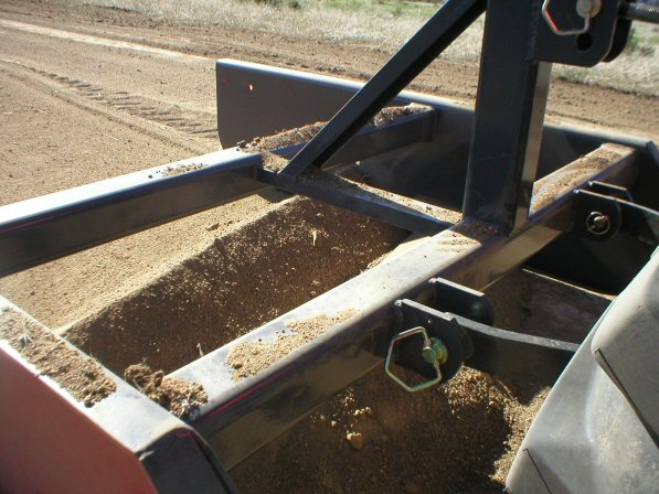

I think adjustable blades means they can be adjusted to cut deeper. I slotted my angle supports so that I can adjust my blade depth. I don't see how the lateral angle could be adjusted. Adjusting from straight to angled blades will change the width, not to mention some crazy angle issues with the blades.
   / Bad Boy Land Plane #23

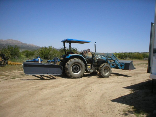

Interesting views. I built mine 7.5' wide, opposing angled blades at probably about a 20 degree angle and the blades are pitched at 45 degrees. I haven't weighed mine but it's at least 1000 pounds, probably more like 1200. I need to build a flop gate for the back since I've used it a few times now. I know one thing, it puts a load on my tractor.
Just to be clear, you have a 90hp tractor. I think that we were talking about smaller tractors.
I also have a 7 footer that weighs in at 1200lbs. I agree that a tail gate could-would be very beneficial. (y)

That's cool. :cool: I actually have everything to put a tail gate on my 7 footer, everything except the time to do it. :(
Gordon is way ahead of us getting the tail gate installation completed. (y)
Yea, I haven't decided how to make mine yet or how much gap to leave at the bottom. I'm thinkingf of using a piece of 5" channel that I have. I'll think of something. I also want to build some fork slots so that I can lift it with my forks to move it around without attaching it to the QH.
   / Bad Boy Land Plane #28
Just go in between the 2 cross beams and lift. The weight pulls the unit down on the forks, or at least mine do.
My 5 foot unit is 6 foot long and my 7 footer is 8 feet long. Sort of in a bind, so no sliding around.
I can pick it up. I want to add slots so that I can engage it with the forks and actually use it with the loader for pushing instead of pulling in certain situations.
