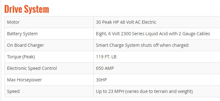

   / Bad Boy 72v electric UTV #10
Have you seen the[FONT=&] Intimidator Classic Series? [/FONT] Classic Series - Intimidator Inc.QUOTE]
Does anyone have any experience with the Intimidator Classic Electric? I'm in the market for a UTV and am interested in Intimidator but not finding much info in the way of owner experiences - specifically the electric. I have a fairly steep paver path between my house and dock and am in the market for a UTV that will get me up and down the hill plus do some medium-duty work in the yard.
My concerns are the ability to climb the hill (approx. 23 degree incline), how long a charge will last and the availability of service/parts for the brand.
