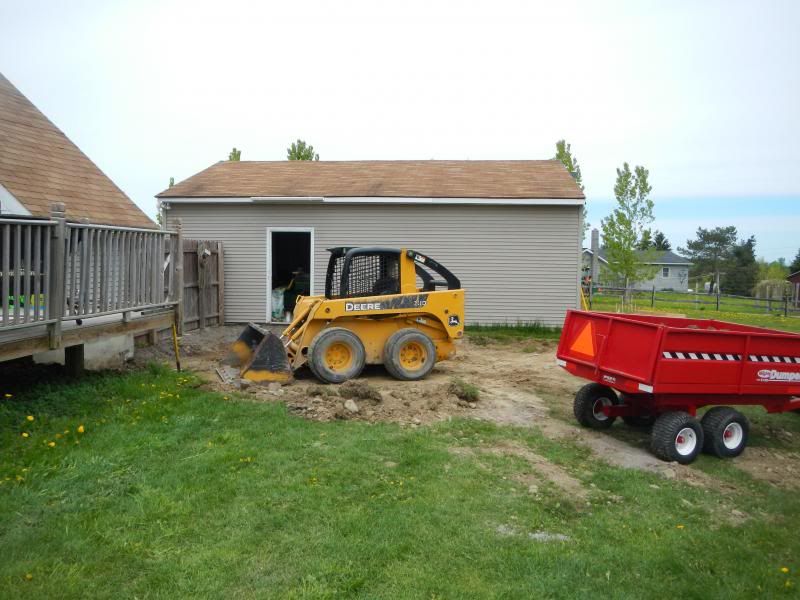

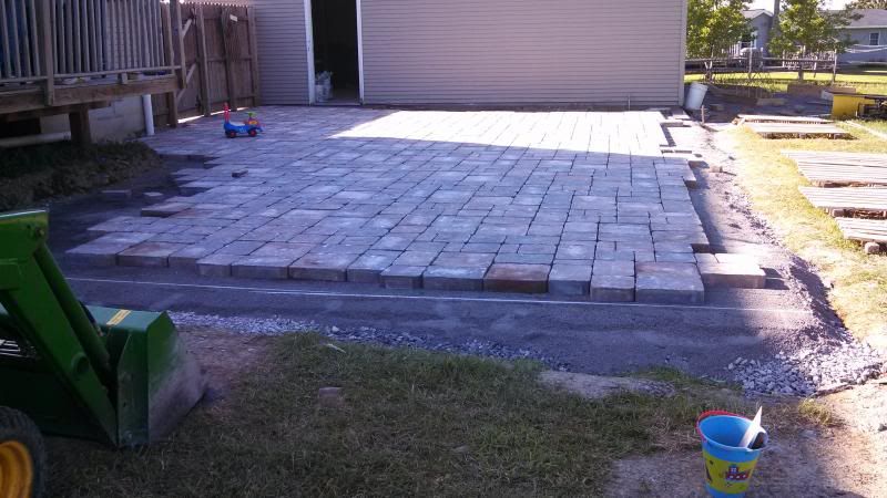

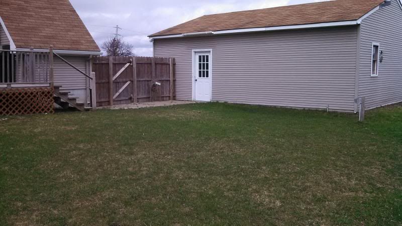

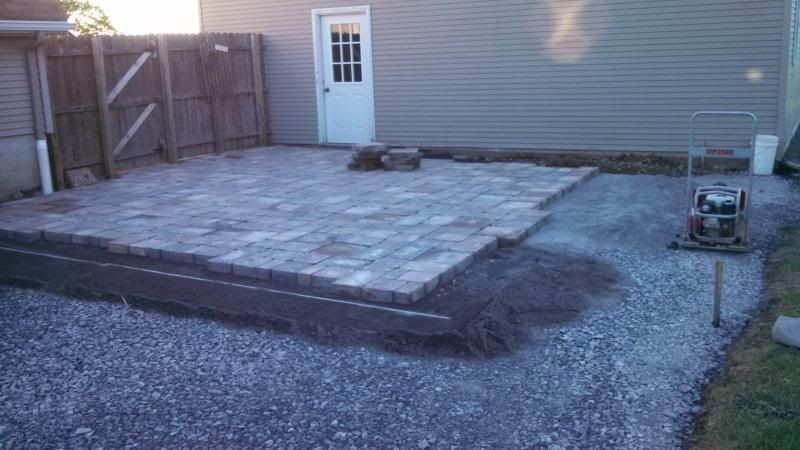

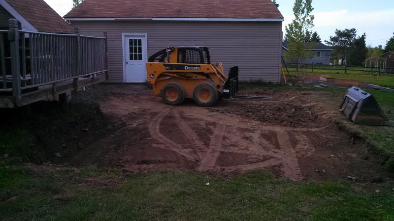

well, it finally was time to start the project, been thinking about it since last summer.
we have a perfect place for a large patio in the back yard, with the garage forming a
large L and a fence between the garage and house for privacy and wind protection.
found a deal on some close out color Rinox brand pavers, their Belair line, and the
dealer had just enough with a little to spare so i bought the whole lot he had

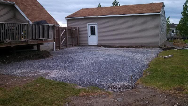

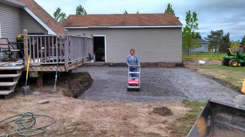

we started 2 weekends ago, did the excavation and backfilled with layers of
crusher run with compaction every 3 inches. I ended up a little deep in places,
but had extra material so it was ok. better too deep than not deep enough
it took me a long time with a line level (should have rented a transit, but,)
and I graded the patio in 2 directions, sending all runoff out one walkway
to the back yard. when it came to laying the stone dust, 3/4" EMT conduit
was just the ticket, and we compacted the stone dust then screeded it off
between the pipes. So far everything is going well, but we seem to get these
monster rainstorms every few days so i'll be happy when i get the rest of the
patio done (the walls have yet to be built) so i can tamp in the polymeric sand.
I did manage to arrange for some great equipment to use, had a customer drop
off a large JD 328 skid steer to unload the brick pallets, then I borrowed another
JD 320 to excavate with, a neighbor let me borrow their little 1.5 dump wagon,
and i used a JD 3203 tractor to pull that around during excavation and backfill.
that kept the wear and tear down on the lawn areas.
since then, i have been using my little X585 with 45 loader, and gator 4x2 to
move the stone dust. I did use the X585 with front 54 blade to level off the
lifts of crusher run before compacting.
here's a link to my photobucket page with the pictures, and here are a couple
pictures to view on TBN
Patio Project Photos by sdutch | Photobucket
before:
during:
day 1 of laying brick:
and after day 2, ran out of brick, were 2 pallets short, which were delivered yesterday....

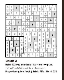

   / backyard paver patio
the pavers have different patterns depending on how many of the
large TX blocks are to be mixed in... (14x14).
I had enough to use about 20% of the large squares, but the pattern is
approx 4x5 . i attached a diagram of the install. it goes nice once all the prep
work is done and everything is screeded.
needless to say, all my helpers learned their A, B, C's!
oh and D's

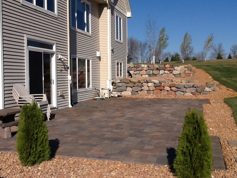

I did an 800sq. Ft. Paver patio last year. It was a lot of work, but I saved a ton of money doing it myself. I used 14x14, 7x14 and 7x7. They were Borgert Vavel pavers. I did a random pattern and mixed 2 northshore and mn river colors.
