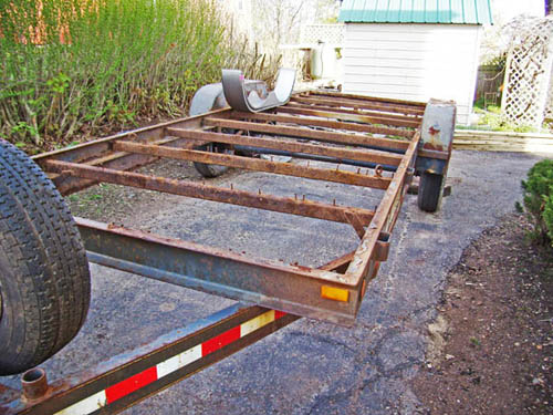

I had a thread sometime ago about repainting my 16ft trailer that I use to haul my tractor on. My plan was to pull the deck boards off and take it to a guy who paints them on the side. He was going to sandblast, prime, and paint it for about $400. After that, I was going to put new deck boards back on.
So, last weekend I went to Lowes to start the process. I bought 15 pieces of PT 2x6x16, which is what's on the deck now, total came to $140 bucks. This evening I took a hard look at getting the old boards off. Wish I had done that last week!! I might be changing my direction if I had. The boards are held in place with #27 TORX screws. They staggered them on opposite sides from end to end (of the boards). Not every board has the same number of screws drilled into the angle joists. Some have 4, some have 5, & some have 6. (NOTE: The ends of the 16' boards are tucked under a 2" wide metal strip). I tried backing out a few screws with a #27 bit in my Dewalt 18v drill and it would not even budge the first one. :( They are all rusted solid. Looking at the bottom, there is about 1" of screw sticking through the bottom of the angle iron, all of it nice and rusty too. I guess they are 3" long screws. Most of the screws you can't even get the TORX bit into the screw because of dirt, rust, and corrosion. I did find a few screws that were broken off.
I had hoped to reuse these boards on a foot bridge across the creek at my hunt club, but that's looking pretty doubtful now. I'm thinking I will pretty much have to destroy these boards with a combination of pry bars and sawzall to get them off.
I'm also thinking now that I could have probably sold this trailer for $800 (which is what I paid for it 10 years ago), add about $500-700 to that and buy one already looking much nicer. You think Lowes will take the lumber back? :eek: I see trailers on CL all the time in that price range, but I really like this trailer. It has a sturdy drive on ramp with spring loaded assist, tongue jack, 12" high sides filled in with expanded metal, and brakes on one axle. The trailer nameplate indicates it was made in '98 though.
Any thoughts on the best way to get the screws out,and maybe salvage some of the boards??

Every time I've redecked a trailer I ended up using a cutting torch to cut the heads off the screws, pry off boards. Take a hammer and bust off what is left of the deck screws. Install new boards. Drill new holes and install new deck screws.
   / Backing out rusted up Torx bolts ?????? #3
Put a floor jack under your trailer. You may need to put some blocks of wood on your jack depending on how high your trailer is. Jack up the trailer by the boards so that the screws pull through the board as you jack up on the board. After jacking up all the boards causing them to pull away from the frame of the trailer, cut off all the screws with a cut of wheel or break them off with a pair vise grips by bending them back and forth a couple times. Don't bother trying to remove the old ones. Just use new self tapping screws for the new boards. Good luck. This project is not the kind I call fun:).
   / Backing out rusted up Torx bolts ?????? #4
I second using a cut off wheel to cut the screws so you can get the deck boards off. The last one I did I flipped the trailer over onto its top and it was much easier to work on from there. Did all of my cutting and then flipped it back over and popped the boards off and drove the screw back out of the boards. It worked for me.
   / Backing out rusted up Torx bolts ?????? #5
I'm third on the cut off tool the screws are hardened and are really hard to drill you might try and drill heads off and jack boards up off them.

I agree with the others, even if you could get the old screws out, how likely is it that you can drill holes in the new boards in just the right spot?
Some good idea's I hadn't thought of!! I knew I came to the right place to ask! :D
The cutoff saw will definitely do the trick. Can I get a 4.5" blade that will fit my angle grinder and use that to cut/grind off the screw heads?? If so, what kind of blade would work the best for this??
I think if I can get the screw heads off, the boards will pry up pretty easily. I may have to cut about 1" off of one end of each board (where it's tucked under the metal lip) before I can start prying on them.
I think that as bad a shape as these boards are in, the screws will pull right through the boards with a good prybar, or by using a jack underneath the boards like Matt suggested. That will probably do the least damage to the boards, but will probably be a time consuming deal.
I really had hoped to re-use those existing holes in the angle joists but it will probably be easiest just to break them off (after I get the boards off) and re-drill new holes like DK35vince suggested. After I get the boards off, and break the top portion of the screws off, I might be able to use a visegrip wrench and clamp down on the screws on the bottom side and screw them on through the bottom. Will try one to see if that works or not.

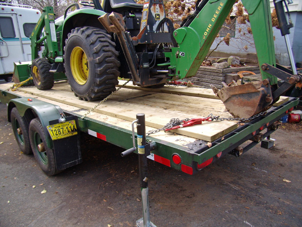

My trailer was re decked last summer. I just cut the boards from the top and use a pry bar to break them off or pull them through rotten boards.
Ground the remaining stubs off with angle grinder.
When applying new decking used bolts. Placed the board and then drilled through board and support Chanel's. In some cases used pipe clamps to pull boards into alignment. :D

All very good ideas for wooden deck removal. Last few trailer decks I have done, I did not redrill the cross metal beams to lock down the new deck. Just get fender washers that fit your bolts and drill the wood adjacent to the angle iron flange and clamp to the beam. Saves drilling time and more holes in the iron. You mentioned a 2" lip on the front. Your decking will not move and is held nicely with the fender washers as clamps. You can use more bolts too. Makes it easier if you should have to redo in the future.
PS-I also had to destroy the old deck on removal.
