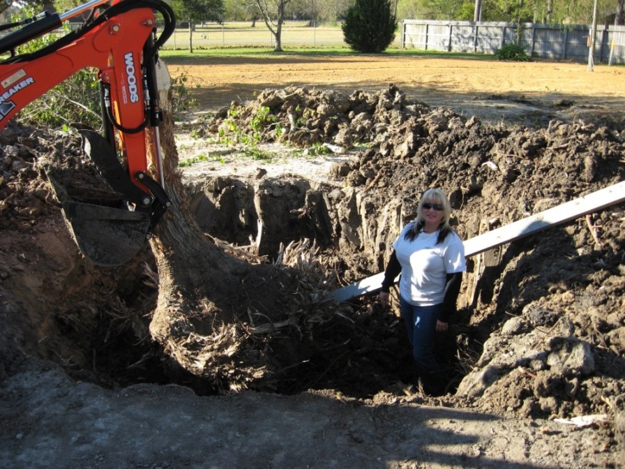

If I had it to do over I would have just ground the stumps on my propery except the ones that would be beneath a foundation. With time an patience you can get dig them up but I personally believe its hard on small B/H's.
A ripper tooth like Bro-tech offers may be a good option. I used my ripper tooth on my Bh75. The soil had just enough moisture I was able to use the ripper tooth to severe most all the roots then I just pushed the tree over.
The advantage to this method is very little backfill work. Sometimes the real challenge can be getting the stump and root balll out of the hole, dont ask me how I know :eek:
Had a heck of a time dragging this one out of the hole, should have got out the pressure washer and knocked the mud off to lighten it up..

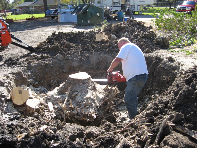

Or do like Chuck and carry a chain-saw.......My wife tells me all the time that i do everything the hard way:D.......I think i got that from her dad.
Hey Chuck,
I have been there & done that:D.......When a person finally gets the root-ball out of the hole, then it looks like a bomb went off.

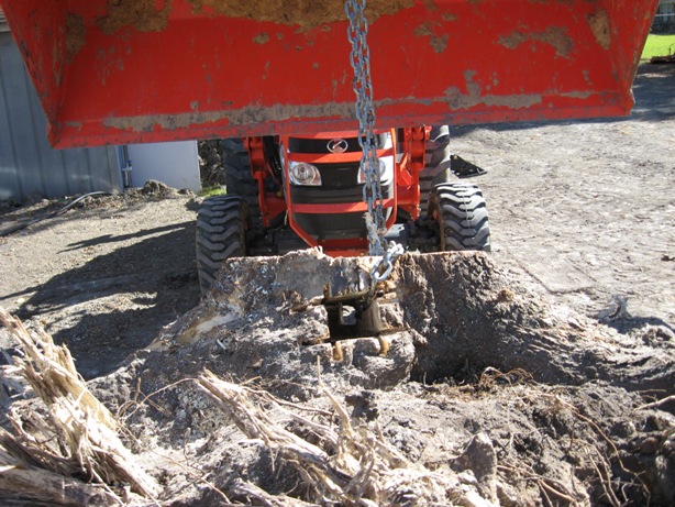

Dig the sides free, the if the curl won't move it dig the other two sides. Try the curl again. You will be able to roll the root ball a lot easier than a straight lift. You can also drop a chain and pull it under the rootball cutting any roots that go straight down. Drag the ball out of the hole with a chain. Use leverage instead of brute strength....
