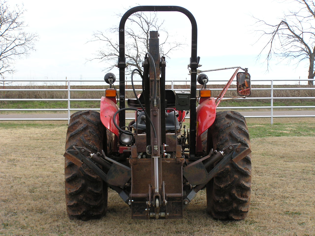

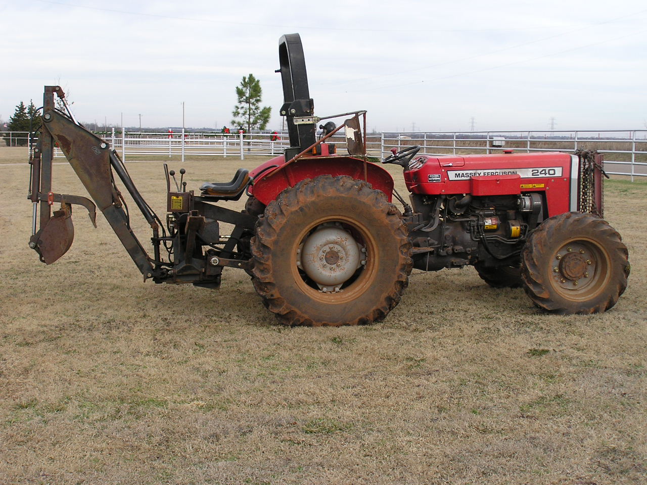

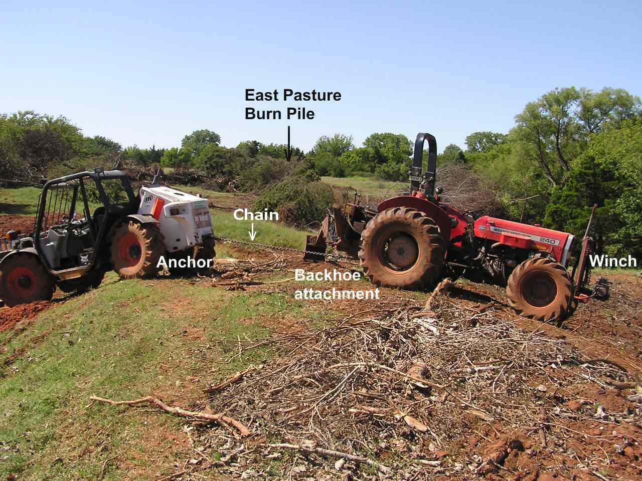

I used a small 3 point, PTO powered, fixed top link, back hoe on a Utility tractor for several years. Didn't want a loader on it because it was a gear transmission.

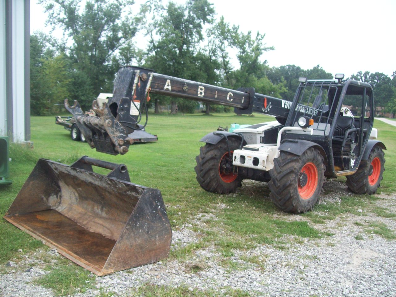

Too late now, I sold it and the tractor 6 years ago, after I got my first Compact Telehandler.

Different strokes for different folks. :D
Ok, so you are the exception to the rule, we all know that ;) I think that MF230 is likely a good bit more tractor than the OPs L3430 and the hoe is pretty small

That tractor weighed 6300 pounds, with all 4 tires filled, but the little hoe could still pick up the back end push it forward.
