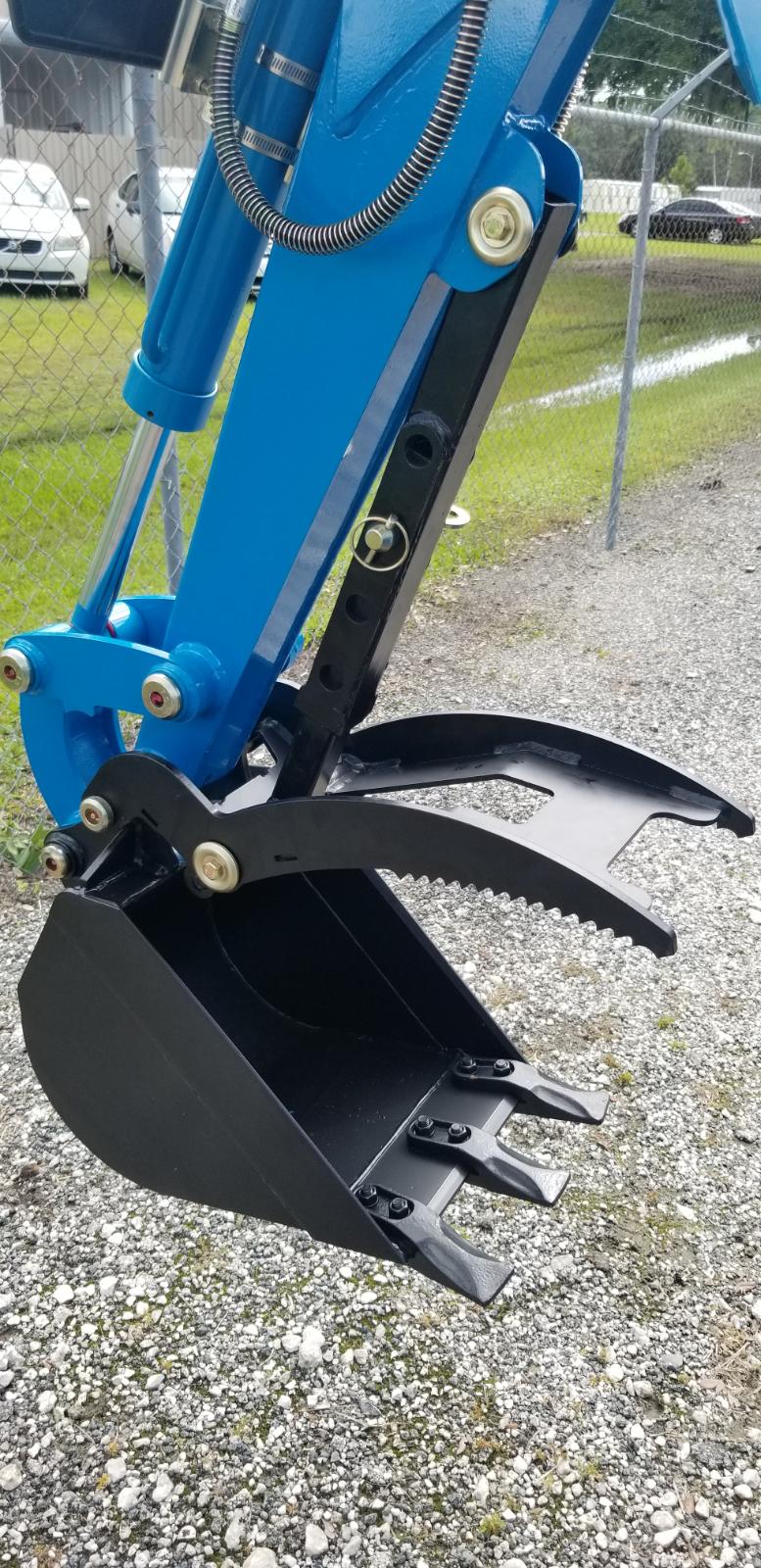

I’m getting close to purchasing a tlb. I’ve narrowed it down to an LS XG3035 HST and a Kubota L2501 HST. I am going to attach a mechanical thumb, but I haven’t seen an LS backhoe that has the mounting holes. Kubota has a reinforced mounting ring. I’d prefer not to have to fabricate one. Any folks here solved the thumb issue?
I love the value of LS, but I gotta have a thumb.

Just use a bolt on thumb. The plates clamp on the outside of the dipper stick. My new XG3025 has a welded on bracket for the thumb "arm" to either put a bolt through or for a hyd. cylinder end for a hydraulic actuated thumb.

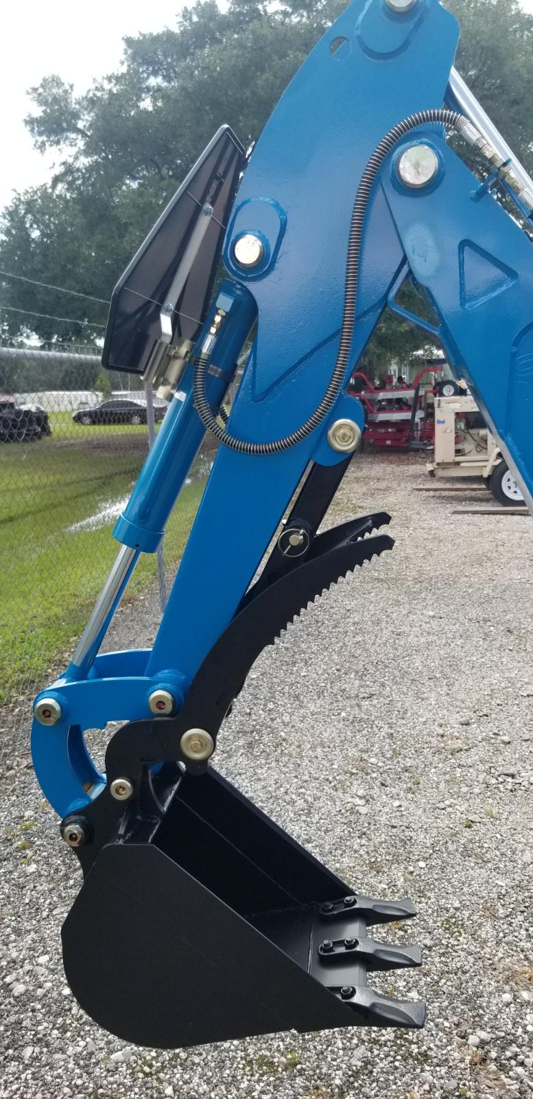

I just purchased an XR3135H TLB. LS has a mechanical thumb for it and it came with the mounting bracket on the BH from the factory. The Thumb was shipped from a different location and installed by the dealer, but the bracket was already there, and the thumb is an LS part.

Looks good! Do you know the actual cost? Also if you have a part number?
   / Backhoe thumb #8
Thanks for the price. I have the next smaller hoe, so it may actually be a different part. Thanks for the info. Most of the dealers don't even know that LS has some 'brand' attachments.
