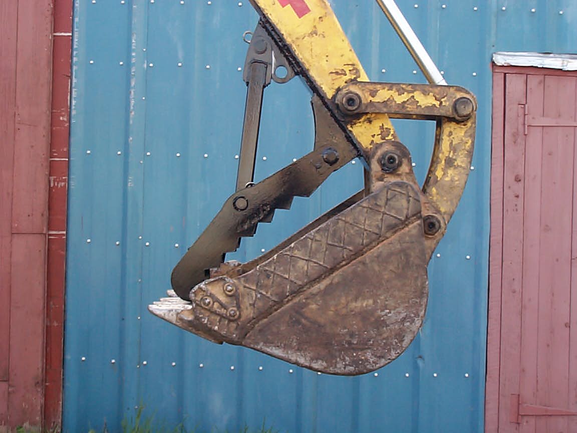

Well I finally finished my first time welding project and made a non-mechanical thumb for my JCB 1400B backhoe. /forums/images/graemlins/laugh.gif
Check out backhoe thumb for more info and some pictures of it in action.

Great job and great photos. I would use grade 8 bolts on the thumb. Grade 2 just doesn't have the strength and you'll be replacing them before long.
/ Backhoe thumb #3
very nice job and STanley beat me to it!!!!!! Even grade 5 will be a big improvement over grade 2, 2 is just too soft for your use. /forums/images/graemlins/shocked.gif /forums/images/graemlins/shocked.gif

I upgraded to 1' thick grade 8 bolts after bending yet another grade 2 bolt /forums/images/graemlins/crazy.gif

Thank you for sharing the pictures. I may try making one myself and I agree that #2 bolts are a little soft or were you using that grade for a 'shear' bolt effect so as not to somehow damage hoe?
/ Backhoe thumb
Thanks for the compliment. I used the #2 bolt as that is all the ole hardware store had and I thought its an inch thick no way I can bend this...DOH!!
I found a commercial grade hardware store and bought some nice Grade 8 bolts at $13 each...ouch...they should hold up fine /forums/images/graemlins/cool.gif
