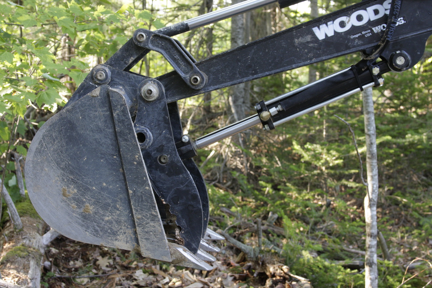

I switched my Woods BH-80X manual thumb to a hydraulic thumb which runs off my 3rd SCV remotes. It works awesome but I do have one question for the guru's. When I swing the thumb out about 1/2 way and then curl the bucket to meet it, I can move the bucket backwards if I swing the thumb towards it. If I then release the thumb pressure the bucket bounces forward. My concern is that I am not sure what is happening from a hydraulic standpoint. I think that the thumb has more mechanical advantage. Any thoughts?

If the force from thumb can move the bucket so the bucket cylinder get pushed in (retract), there is a hydraulic problem.....If not the movement in bucket comes from excessive play in the linkage between the cylinder and the bucket
You need to tell how much you can move the bucket with the thumb....
There is a natural play in any linkage. After some hundreds of hours of use, this play increases (wear prevention by using the grease gun every 8 hrs of digging) an will show some considerable movement on the edge of bucket...there are 1 connection pin on the capped side of cylinder and 3 connection pins on the rod side of cylinder....manually check the play in these connection pins...together they will add up to a considerable free play

Thanks for the info. The backhoe only has about 50 hrs on it so it shouldn't have much linkage play but I will take a much closer look at it tonight. I also thought that I might put a piece of masking tape around the rod 9 about 2 inches out and try to get a sense of actual rod movement back into the cylinder.

You could add a relief valve to the thumb cyl and set the pressure to whatever to suit your purpose. If the cyl are the same, as in tons of force, then the one with the best mechanical advantage will overpower the other, and perhaps break something.
There might be air in that cylinder or the valve is leaking. Does the cyl extend back out when you let off the thumb?
/ Backhoe thumb retrofit
When I back of the thumb, the bucket snaps forward.

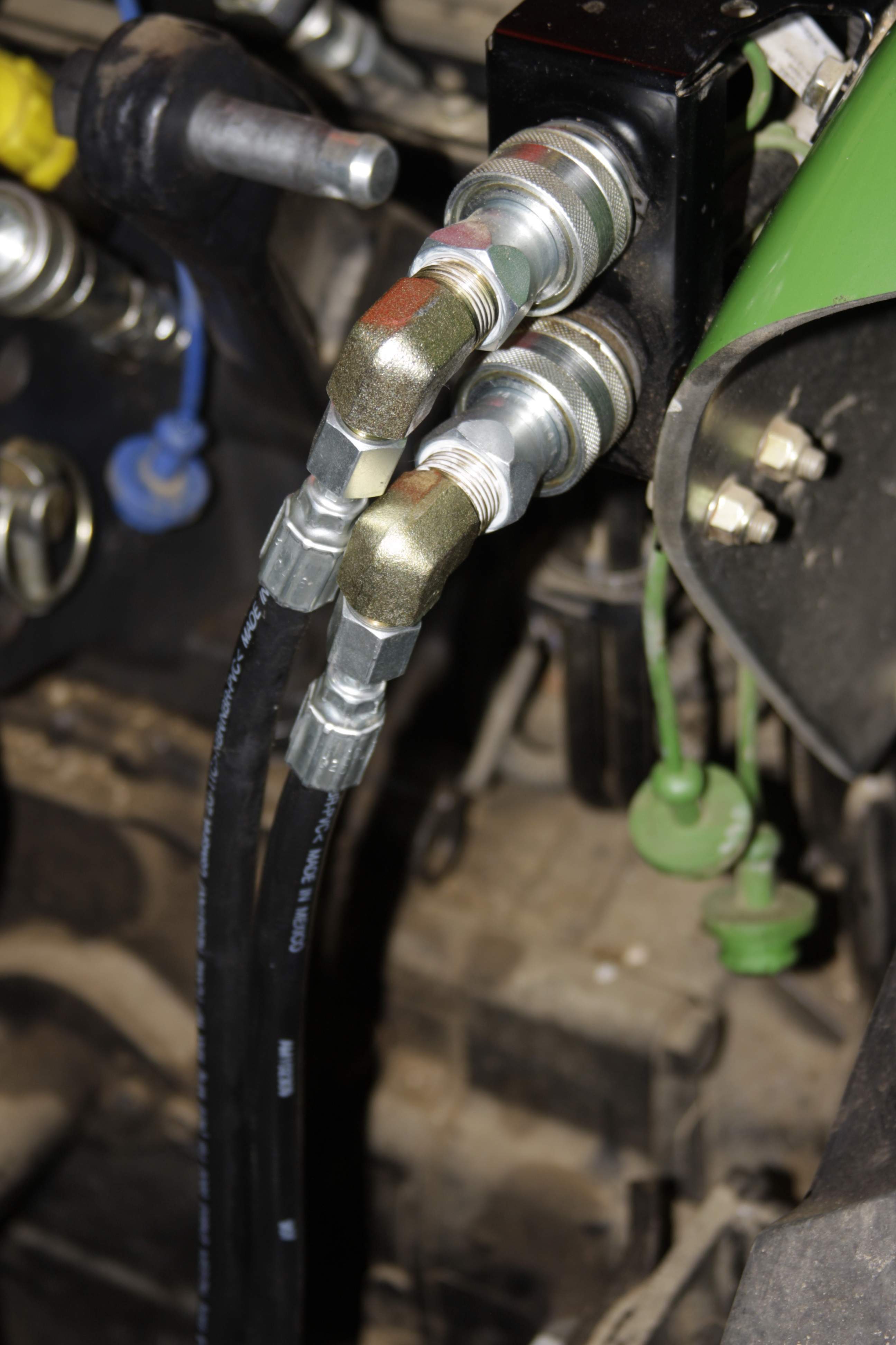

I have done some more checking and it turns out that the issue is not a linkage play issue but I can indeed force the bucket ram to retract back inside it's cylinder by aplying pressure against the bucket with the thumb. If I do some rough measuring and figuring, it looks like the tip of the thumb has at least a ton more mechanical advantage over the edge of the bucket. That being said, is the relief valve for the bucket being opened by the thumb? My plan will be to add a relief valve to the thumb circiut and adjust it to balance the bucket but I am confused about what is happening. Does anyone want to advise me as to the easiest way to plumb in an inline relief valve? I am adding a pic to show how the thumb is plummed to my remotes.

Another option is to move the thumb cyl mounting pin holes closer to the pivot point, decreasing the push force. Just bore some new holes about half the distance of where the pins are now. My thumb has three sets of mounting holes.
/ Backhoe thumb retrofit #18
I believe you have the cylinder pins in the wrong holes. Use the holes closer to the pivot point. The pin mounting does not look correct. Wrong size hole for the pins.

If you are going to use the relief valve, and the SCV is at the back, then just tee the relief output into a return line to tank.
