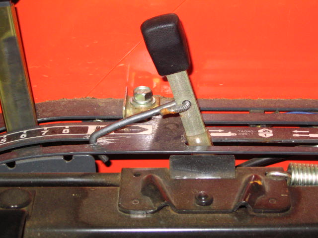

In lieu of a bungee strap,I made up my own locking mech.

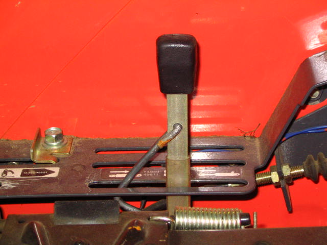

First picture was shown in the n/o position. This picture will show to operated position. To lock operated,just lift lock out of slot,operate lever forward,drop lock down into forward slot. You must release the locking position when the backhoe is removed.

That's a good idea. Thanks for sharing.
