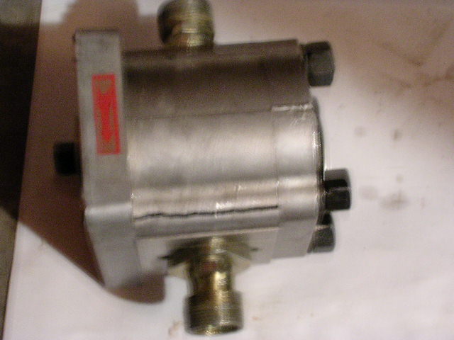

#26
Good news / Bad news
Well I reassembled the BH PV assembly after removing the metal shavings. The following happened:
1) Stabilizers raised and lowered no problem at 1K rpm
2) Tried to curl the bucket / move boom and nothing?
3) Reved up the engine to 1500 rpm
4) Bang... the pressure side of the hydraulic pump blew out
a. it cracked all the way across the side and a waterfall of fluid came out
At any rate, I am really happy to have figured out the 1st problem with the PV- with everyones help. Now I think there could be two other issues?
1) More metal shavings in the other controls?
2) I installed the BH PV valve with the adjustment with too much pressure?
Any advice on rpm for backhoe operation and what should be the pressure in the system?
I am definitly buying a pressure gauge and want to get this thing right.
The joy of a crate tractor. And the other good news is that I am learning about the machine.
thanks again...
/ Backhoe Questions #27
Slorne,
I will say you have the right attitude for this. /forums/images/graemlins/wink.gif
</font><font color="blue" class="small">(
)</font>
Wow, its hard to believe that pressure would build up and break there! I would have expected a hose to go first. Be careful. If a pressure failure, you were lucky you were not hit with any metal or high pressure hot fluid.
When you were raising the stabilizer arms, did you hear the relief valve working when it was in the full up position, at the stop? ie just trying to prove that the valve was working and not jammed.
Recommend calling Pat and getting one, if not both of his spare pumps. Disassemble the failed pump at see if anything can be learned there. Try flushing and cleaning the lines, as best you can while waiting for pump to arive. Flush and check the tank for these chunks. Check the suction side screen, to make sure there is not any gapping holes, that will allow for it to be recirculated. When you start again, use low rpms, and do as Pat suggests above. Start from a very low setting proving the valve is working, and adjust up. As far as a pressure gauge, you may have to get some fittings made.
PS: Please post a picture of the split pump when you have a chance.

/ Backhoe Questions
#30
photo of broken pump housing
/ Backhoe Questions #31
slorne:
sorry about the blown pump: #1 reason i suggested setting up a pressure gauge inline... anyhow
#2 there should be an o-ring under the small metal bracket/hose fitting on eash side of the pump between the 4 bolts that hold the fitting to the pump and the fitting. there is a grove cut in them. all of the hoses have o-rings between the hoses and the flat mating surface of the cylinders & fittings too.
more than likely the pump was damaged prior to the PV blow out. the metal more than likely came form the pump? had to come from someplace. I would removing the pump inl;et & outle hoses and cleaning them inside with flush & air. same for tank if possable use long magnetic pickup tool to forage for debris. dissassemble the valves and do the same for them if (IF) you find much more than flakes the sice of metal flake paint.
keep up the work it will be rewarding SOMEDAY /forums/images/graemlins/smile.gif
MarkM
/ Backhoe Questions #32
**** that sucks. I knew you would find crap in the PR valve from the other things you told me(fluid moving in tank)
It is possible that you replaced the PR valve and had screwed it in all the way or too far. Like i said, if you dont have a guage dont worry about doing it the way i said, you cannot hurt anything by having it set too light.
Start with the PR valve set almost all the way out, then work the outiggers until they just have enough power to lift the tractor off the ground. do small incriments until you achieve this. Then go have a little fun and if you find the hoe is not able to dig like it should make small adjustments. Remember, skill is everything with hoe operation. if you never used one before dont attempt to just push the bucket into the ground because everything is done by touching the bucket down, then pulling the main boom towards you to fill the bucket about half way, then curl the bucket and it will fill the rest of the way. That is the proper low stress way to work it.
Do you need a spare pump?

/ Backhoe Questions
#35
John,
I have given alot of tought to what happend with the pump after I found the metal shavings and cleaned out the PR valve. I'll list what I think happend:
1) Cleaned out the PV, which was definitly the problem
2) Started, enguaged PTO and tried moving stablizers
3) They moved - lifted bh off the ground
4) Then they did not work the second time
5) I slightly tightened PV - thinking there was an inital burst of fluid, but then not enough pressure
6) Nothing - So I turned up the RPM's - and bang
I think the error was probably the following
1) too much pressure (PV too tight to begin with)
2) First action from stablizers was a result of the metal shaving being removed and fluid flowed briefly
3) Tightening and increasing rpm overloaded the system
Tomorrow I will clean all controls, the tank, filter, replace all fluid. Then start with a very loose pv (tight enough not to fall off) and slightly tighten. I will be very careful and tighten slowly and wait (patience)
Although the crack looks like it's through the bolt hole, it is not. It's only through the casing and the face plate with 4 bolt holes has no crack.
No drop in rpm or strain on the engine when the bang occured. It only started pumping fluid out of the crack like a waterfall.
Also, no sign of broken metal in pump or gears. Although the gears look like something could have scuffed them. I will post detailed photo's after I get this thing figured out.
Once again, I am greatful for everyones help and sincerely could not have assembled, trouble shooted this tractor with out everyones support.
Regards-
