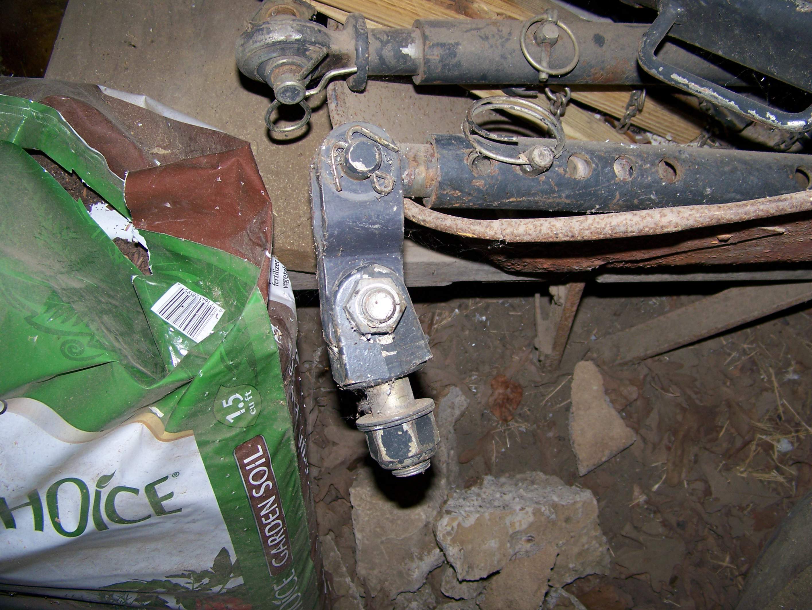

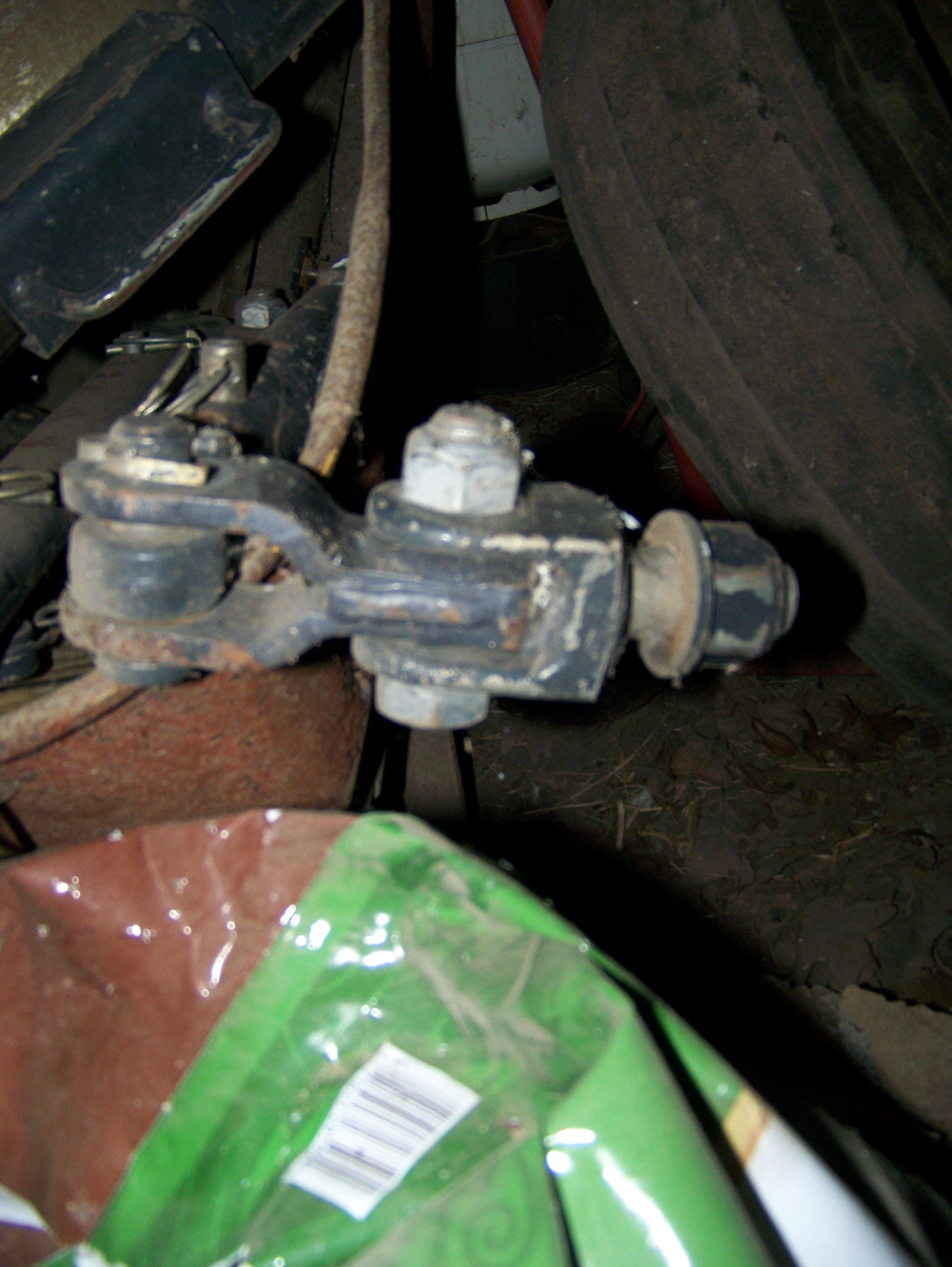

Here are photos of the stabilizer extension for my 511 subframe. It is the "Y" shaped extension that is cotter pinned to the stabilizer. Stabilizer Extension.jpgStabilizer Extension SideView.JPG
hugs<<><><>>Brandi
   / Backhoe question #25
I'd scan the parts break down and illustration , but my scanner is hooked up to my PC and the PC is on the fritz. The sway extension link is Bradco/Mahindra part # 103213. The hex capscrew (bolt) is #1142. The lock nut is # 1936. Quantity 2 each. This infor is from the sub frame mounting kit #102590 instructions manual #76259
Hope this helps.
hugs<<><><>>Brandi

bindian,
Thanks for the picture. I've looked and don't have anything that looks like that. I have a parts manual # 75522, an operators manual # 75521, and an installation dvd which I watched and the narrator said the same thing you guys have been telling me, but it never shows what I need to know. Even if I had those parts in the photos you sent, I still would not know where to bolt them to.
I'm gonna call the dealer Monday and see what he can tell me.
Thanks for the help.

Cap'n Jack,
I will try to remember to take the 3PH arms out of the wheelbarrow (where I store them) and lay it out with the stabilizer and get photos to give you a better idea how it goes together.
hugs<<><><>>Brandi
