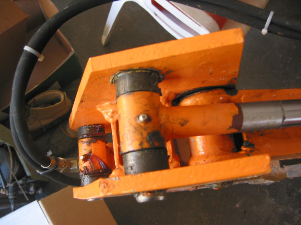

Sorry for not posting sooner. THe bearings I used were the bronze/graphite 'permanent' lube. Big mistake. Should have gone with what you're doing. I'd rather be responsible about having to always shoot those zirk fittings rather than depend on something that's rated 'permanent'! The problem I'm having now (because of this) is the the swing pin seized in the bearing. So the upper and lower steel plates have oblonged holes where the poin goes through. Haven't had the time to address this. I also have three sized buckets. Had need of changing sizes a couple weeks ago and couldn't loosen those pins! One of the winter projects wil be to replace all the pins with new, and add zerks!! Otherwise, I'm relativley pleased with the machine. I wish I did the next size up, though. It seems I often have a need of something a bit more powerfull. But then, I'd probalby still say that if I owned one of those military/government/highway/heavy-construction beasts! /forums/images/graemlins/confused.gif

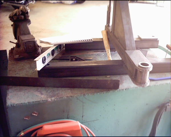

I should finish welding this weekend, except for one missing bracket which is /forums/images/graemlins/cool.gif shipping today. I also ordered the 6" bucket. Seems everyone that knows I am building this machine can find something they need. I hate turning people down but I do not want the liability.

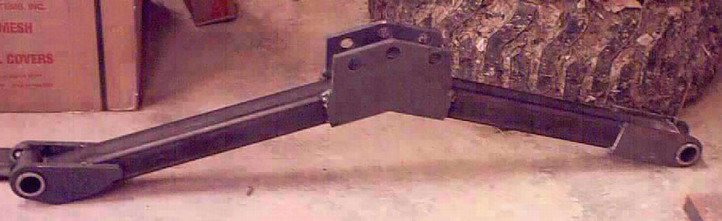

Never had a weld let go. No twisting, either. On the whole, I'd have to say that it's a pretty well designed piece. Here's a pic of the engine compartment.
http://f1.pg.photos.yahoo.com/ph/mrcaptainbob/detail?.dir=/84b0&.dnm=1445.jpg
The pump of coarse is run off the engine and is located directly in back of the electric 'panel' box. And that's directly under the hydraulic reservoir.
