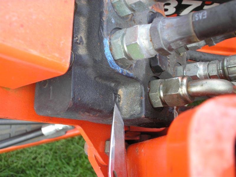

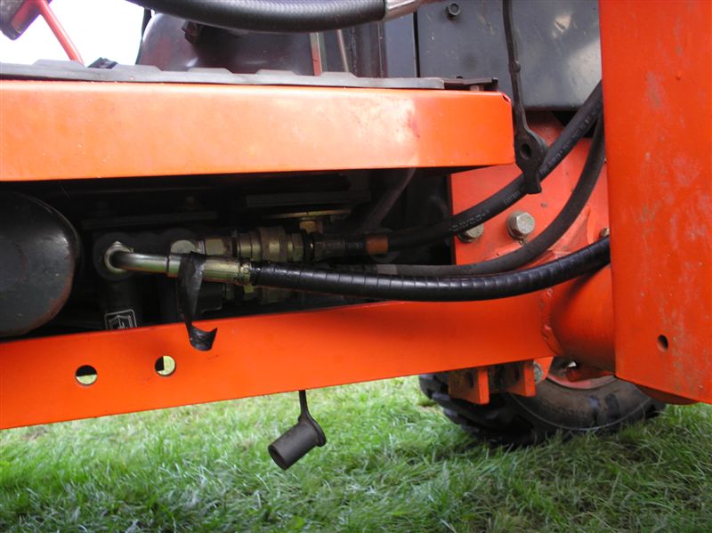

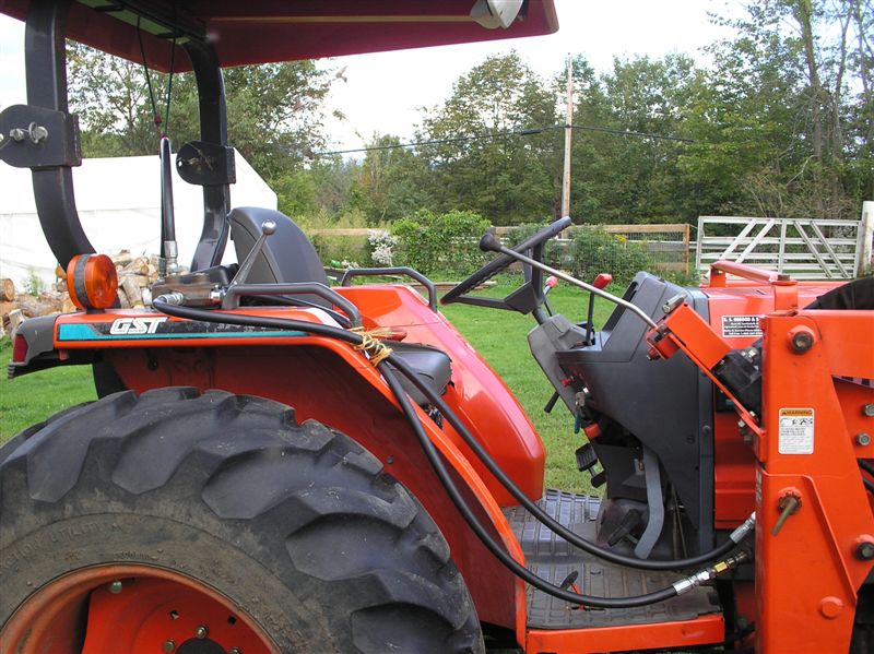

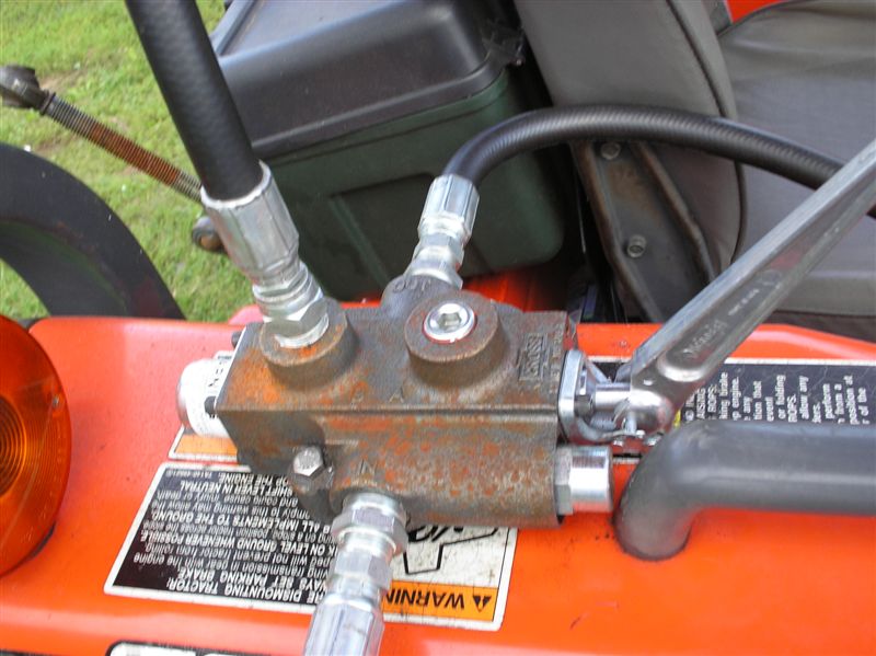

Hi, thought I would post on this thread how I did this, for commentary and critique.
I needed to add a rear valve to raise and lower my mower-conditioner, which has a single acting cylinder. I think what I have done is appropriate. I basically had hoses made that Tee into the line that comes out of the 'PB' port on my loader control valve (pointing to it with my knife in the picture; the one I Teed into is to the right of the blade). This line already had a quick-disconnect connection at its midpoint, so I just had my hoses made with the opposite QD's. I purchased a Converta valve at TSC ($122) and converted it to single-acting by installing the supplied plugs (instructions for this are on the outside of the box. The instructions aren't very good, but I called them and got help right away). With this setup you use the work port labeled 'B', and 'A' is plugged.
Although itエs not pretty (can't believe it rusted in one day!), this all works and works well and got me on the field cutting. The the only downside is the way I have it, the lever works opposite of what you're used to. However the above posts about 'PB return is not being a proper return port' have me worried (my system return is the hose marked with electrical tape in the picture). The lines do get fairly warm, but I'm fairly sure this is normal.
Also worth noting that the valve mfr made sure to mention this valve is not for raising and lowering something that can't drop a touch before it goes up (not an issue for my moco).

Welcome to TBN:D
I am glad your valve works for you-BUT-in general, you CANNOT "T" into pressure lines on open center hydraulic systems. All new valves must be plumbed in series to work properly. I would guess it's working for you because it is a SA cylinder and does not need a lot of pressure to raise the mower.

I actually was going to T into the 'In' line until I read your posts warning about that. I guess I thought I was doing the right thing by T'ing into the PB line - not so? So is the way I have it OK except I should have the return (i.e. the 'Out' from my new valve) go somewhere else? I have time to change this now because I'm not cutting hay again until next summer.

Marty,
You should have a hose that runs from the PB port on your loader valve to the IN port on the new valve. The PB port on the new valve should go to wherever the original line went to (presumably the 3PH). Then the OUT of the new valve should go to the tank. You CAN Tee low pressure return lines, but NOT high pressure lines.
If the new valve in placed in "parallel" with the loader valve, then the fluid will take the path of least resistance back to the tank, and that won't be through your new valve. ALL valves MUST be in "series":D

Kennyd - i don't think that valve has a pb port. just in and out ports. all he can do is feed it from fel pb and return flow to the next-in-line pb user (in series as you point out). not ideal and potentially dangerous per discussion above but otherwise he needs a valve with pb.

Thanks for the comments. Theo is right, the new valve doesn't have a PB port. It has an open center design, so to my (probably flawed) way of thinking, the FEL setup doesn't know it's there unless I actuate said new valve, which is fairly rare. Basically I only raise the Mower Conditioner if I am going to run over something, like maybe a finance manager.
This tractor, a Kubota L3710, does not have external cylinders for actuating the 3PH. I have the 'out' from the new valve going back to where the PB went before, which looks to me like it is a tank return. I will see if I can consult the appropriate page in the book and possibly scan and post it here. Essentially what you're telling me is, if I actuate this valve while I have something raised with the 3PH, I could cause myself a sichyation, correct?

Marty - that old fel pb out line had to be going somewhere. i assume you have no backhoe. do you have a rear remote set? does your pb feed the 3-point? the 3-point doesn't need to have external cylinders to use pb. the physical connection to the 3-point may not be real obvious.
but if your pb line really wasn't there to feed anything and was just routed back to a tank return point for some possible future use, then you are fine once you change the fel pb out "tee" that you spoke about to a simple series connection as kennyd had pointed out.

On most CUT's like JD's and the Kub's the 3PH is the last valve in the circuit. I will bet that PB line terminates to the tranny case, where internally it feeds the 3PH.
I will venture to say all you need to do is remove that T you have, and leave the OUT port go to where the PB line went to and you will be fine.

Kenny - I misspoke - I guess I meant that functionally I 'Teed' into the lines, but in actuality, I did have new hoses made that fit into the existing quick-disconnect junction in that PB line - basically I undid that quick-disconnect, and connected my new hoses. These are the in and out for my new valve. So I don't have any actual Tees in my system. This was based on some of your very good posts on the matter, that one should avoid Tees in hydraulics. In fact I bought some Tees before I read your posts and have to return them.

So then, I apologize for busting your chops:D Sounds like you are good-to-go then with the way you have it!
I was basing ALL of my comments on what you wrote in your first post:
