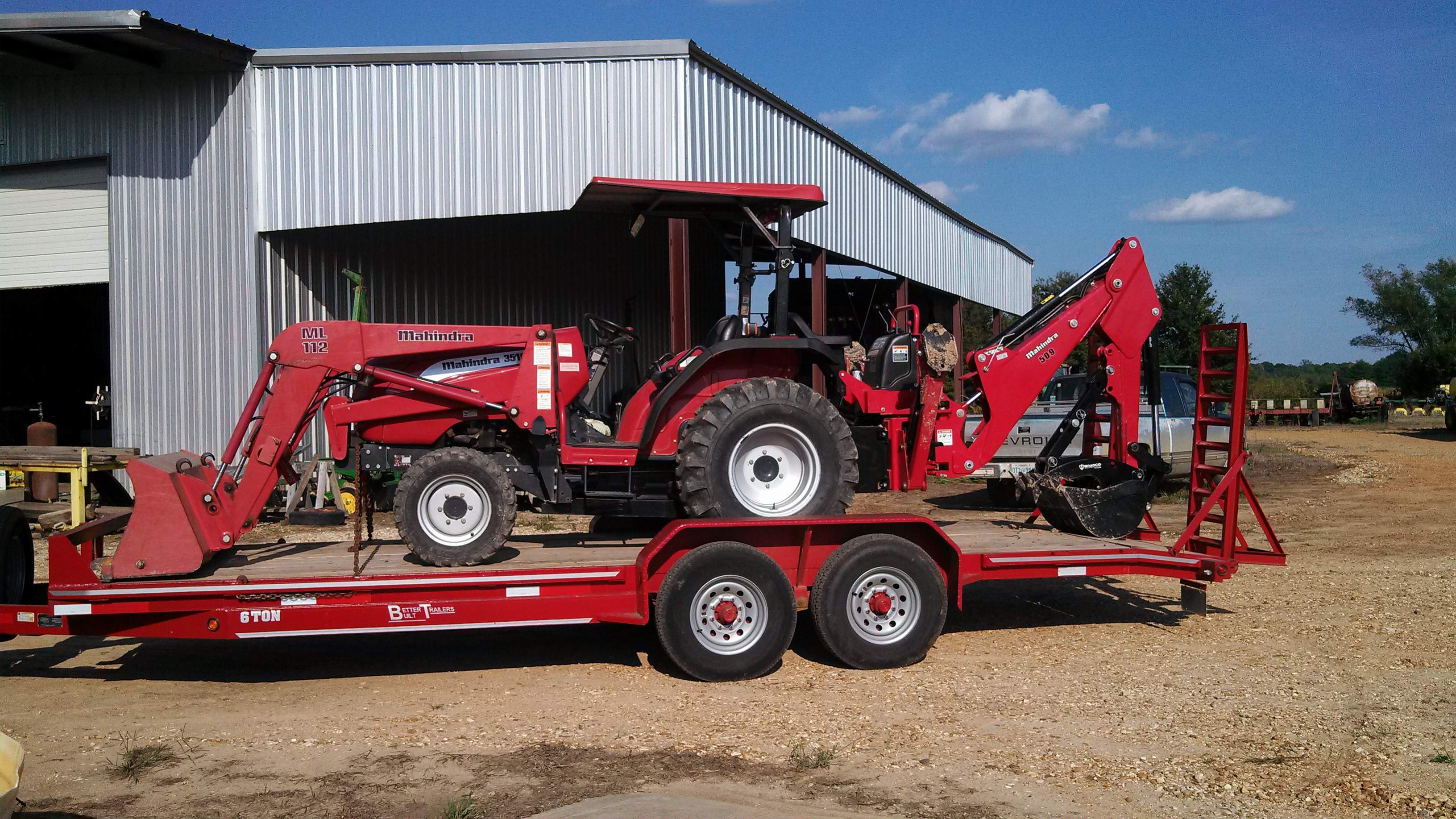

Compare the hydraulic pump ratings between the 35 and 40 hp models. My backhoe doesn't work my 40 hp engine very hard, I think 5 hp less would hardly be noticeable for backhoe work. Same frame means you have about equal weight.
If the main hydraulic pump flow (ignore the PS pump flow) is the same or close on the two machines, the hoe is the way to go IMO.

My Massey operates the hoe nicely at just a high idle around 1600. It's all you need. I wouldn't worry much about the power either. The hoe is pretty much limited by the weight of your tractor anyways. Once you bite too much it's going to slide or be dragged . Thus you only get what you are getting anyways. I would think that the larger tractor wouldn't be enough more weight to be dragged any less.
One word of great advice I got with mine. If you don't have a cement floor to park that hoe on when dismounted build a wooden platform to set it on. I took mine off on some slightly uneven ground the first time and it came right off. Putting it on was a whole nuther matta. At the very least make sure it's sitting nice and square with plenty of room for the tractor to move around in front if need be. Like don't park it dismounted right next to something fragile and expensive that can't be moved out of harms way, in case you need to slide things around a bit getting reattached. If you are square and flat it's a 3 minute job. I leave mine on nearly all the time though as the 1000 lbs takes the place of loading the tires more or less when it comes to traction.
