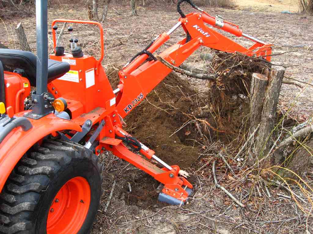

The CK20 is absolutely great with a six foot backhoe like the Kioti KB2465 or a Woods BH70x.
I had the earlier version of the Kioti backhoe (KB2365) which was great. The new version is even nicer.
The CK20 is a heavy little beast which makes it perfect as a platform for a backhoe. I found that I needed to install a set of turf/dirt shoes called Bigfoot on the BH stabilizers as the BH was strong enough to pull the tractor around in dirt otherwise. That is an easy addition but I'm forgetting the name of the manufacturer of the bolt on shoes. If you are handy with a welder you could make yourself a pair easily.

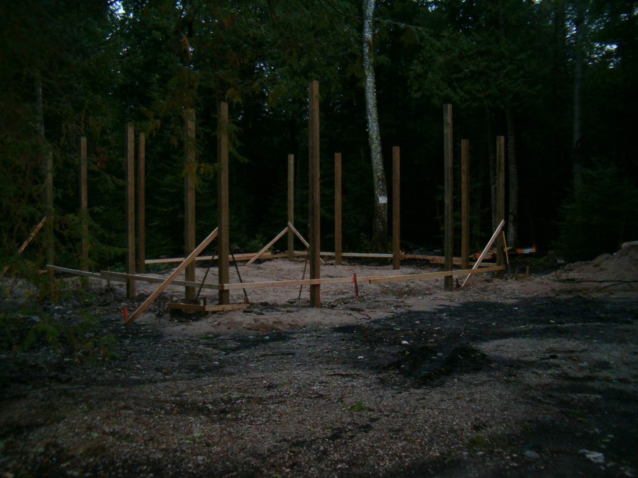

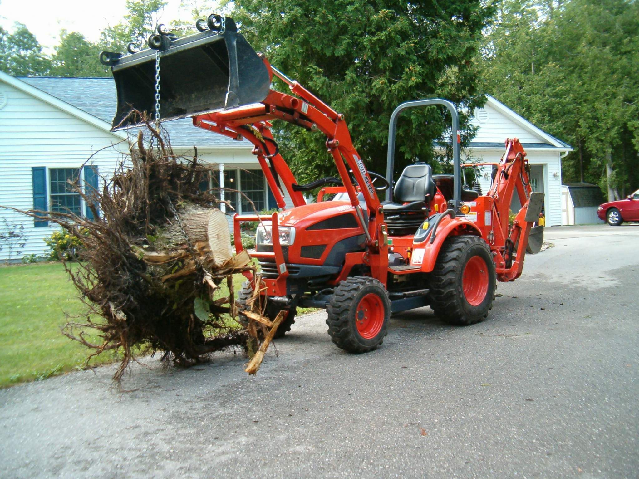

I have a CK20 with KB2465 backhoe. My property consists of heavy forest of mature trees. With that rig I have built roads straight through the hardwoods. That means any tree stump that got in the way was about to get excavated. I also cleared an area for a pole barn and leveled the spot iin addition to digging footings for a couple additions. The stumps didn't all pop out instantly but this little CK never met a stump it did not beat up on.
Island spoke of adding the larger outrigger pads. My dealer made me up a couple of squares of 3/8 plate steel measuring just a couple inches beyond stock outrigger pads. What a difference they made for that little stump bully. My plates have no teeth either. Just a flat pad so I can use them with the machine on blacktop. Works well.

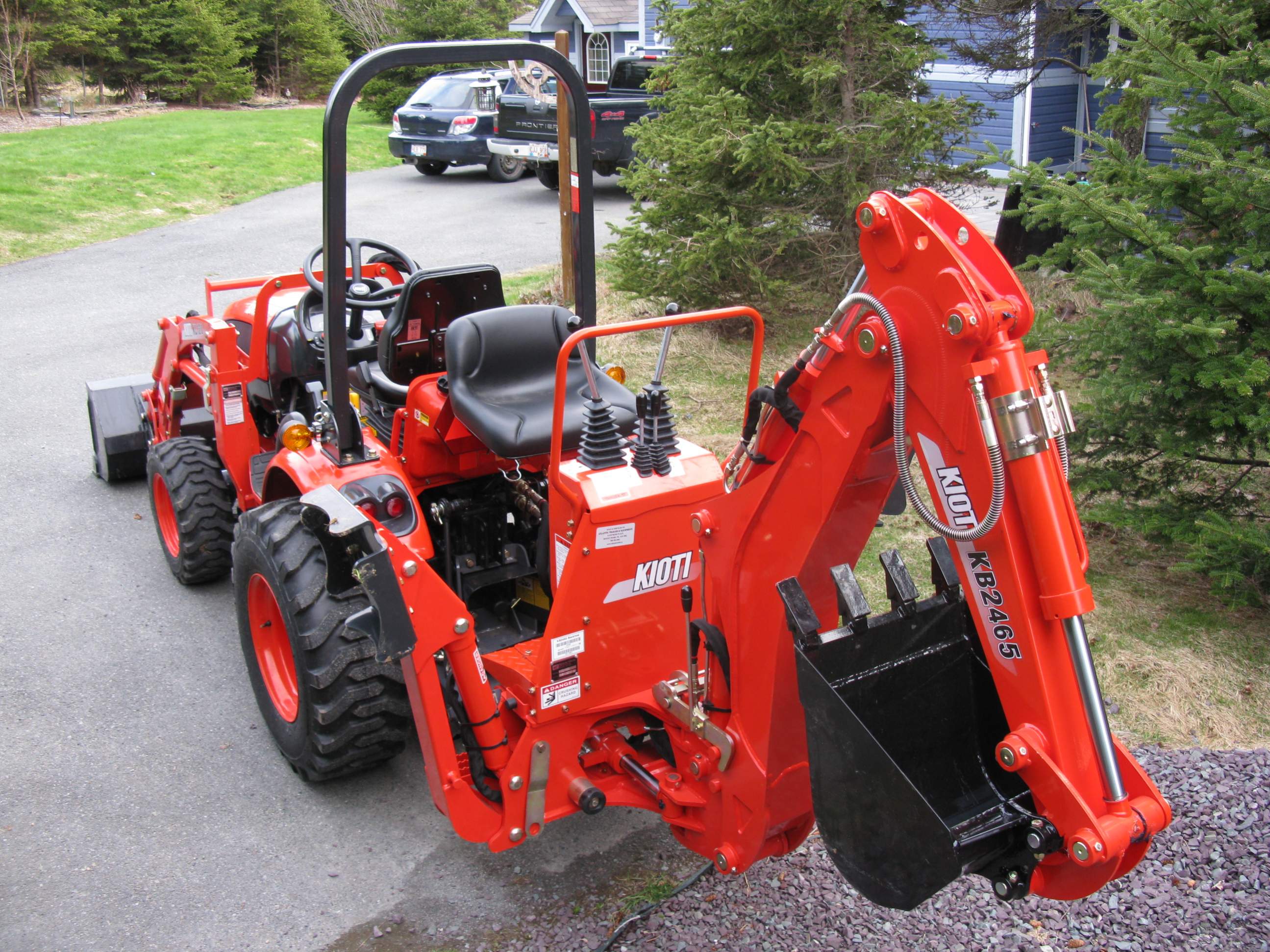

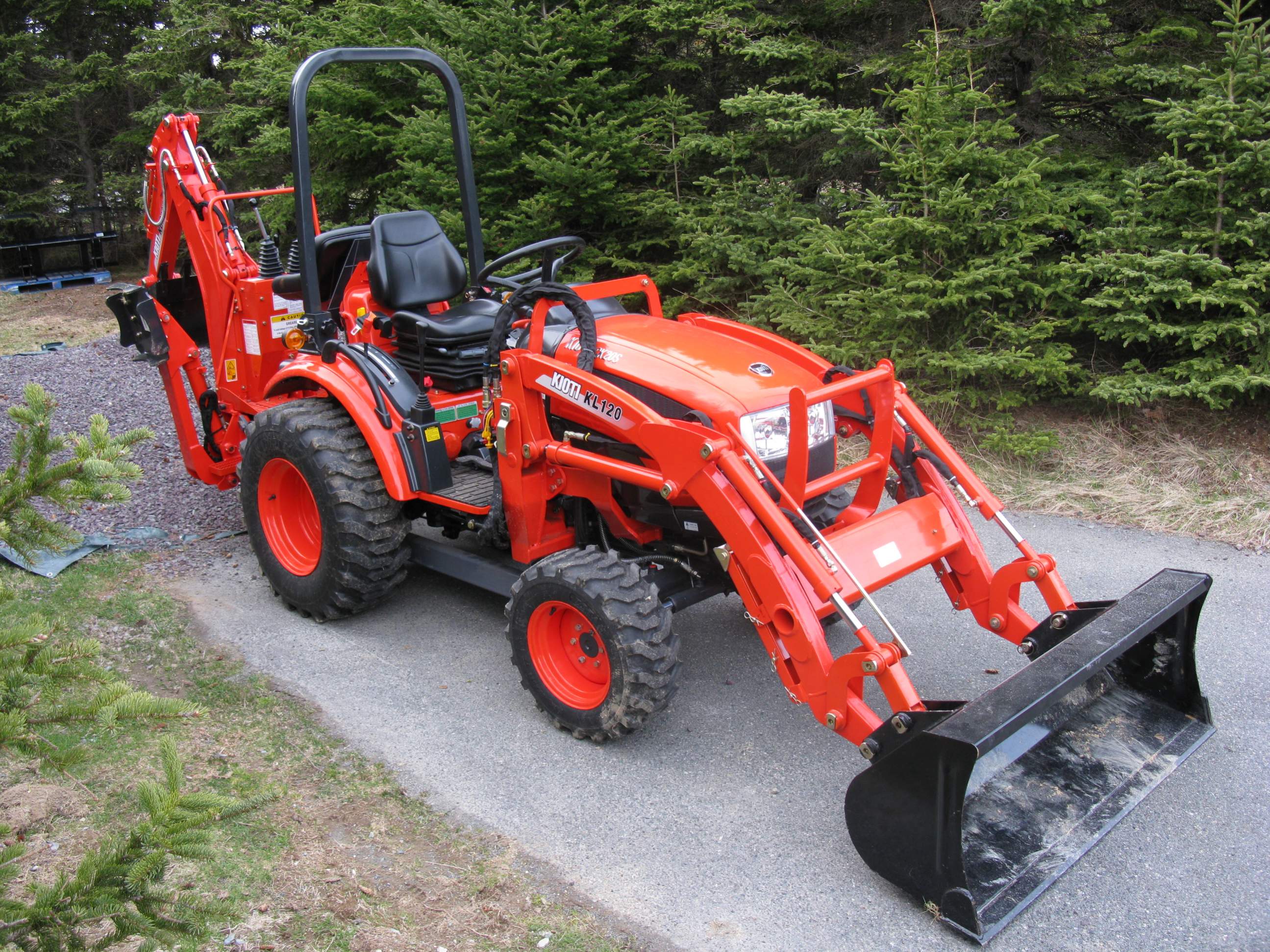

I excavated a 2000 square foot area for a house extension and then dug out 2 feet of soil and roots from about 50-60 mature spruce trees. At the time I had a Woods BH-6000 on my CK-20 and had no problems at all.
I traded the CK-20 with the Woods for the CK-20S with Kioti KB-2465 and 16" bucket. I asked for the 12" bucket but the dealer put on a 16", which I found to have made no difference to the digging power.
My KB2465 cames with the bigfoot outrigger pads.
My next project is 400' of trenching at a customer's site for underground fibre optic cable. I'm looking forward to that job.
