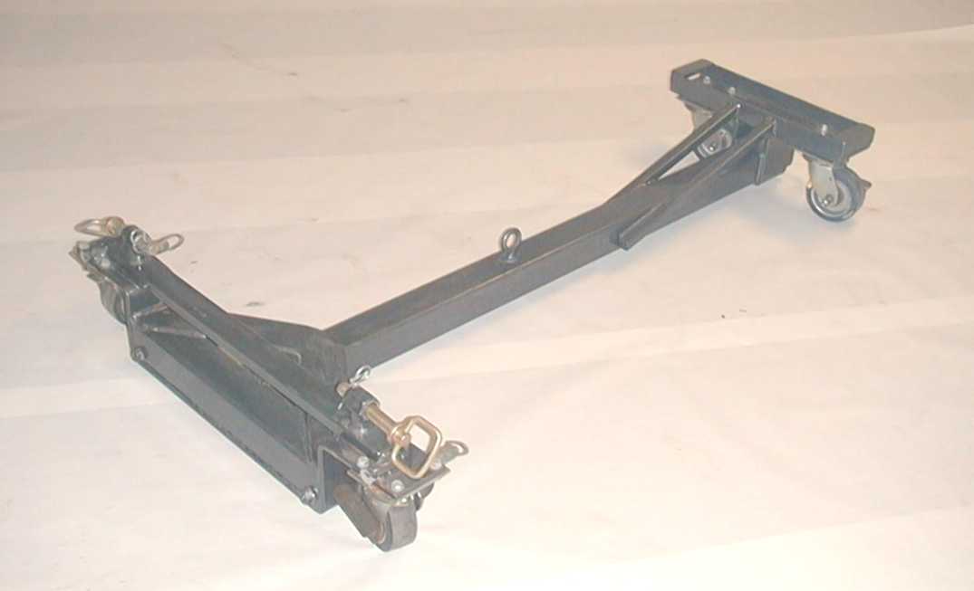

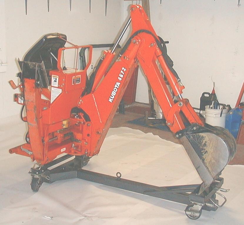

Here are a few picts of the dolley I made for my 4672 BH. When the BH is removed it takes up too much floor space,and in the winter I put tractor behind my two veh.. Have to pull truck out before using the tractor for snow, but it keeps everything out of the elements.
The dolley is made from scrap metal and the wheels also came from a junk yard.
Sorry about the number of pictures but sometimes the extras help someone see the details so they can make their own.
Doug T B1700 TLB

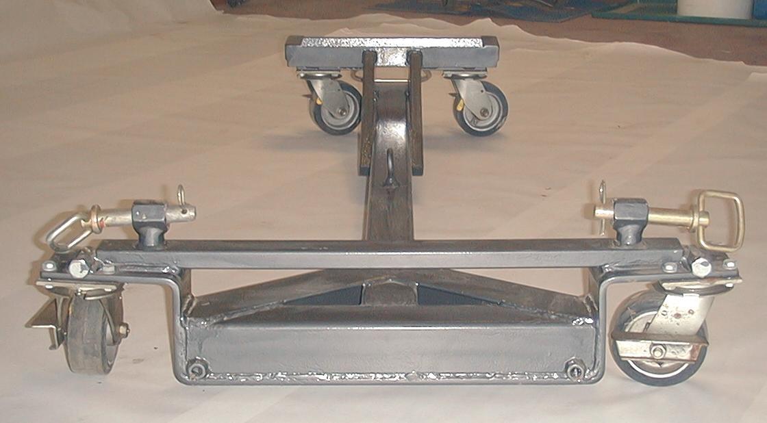

Picture 2
I'll try to make them smaller. Rookie
Doug T B1700 TLB

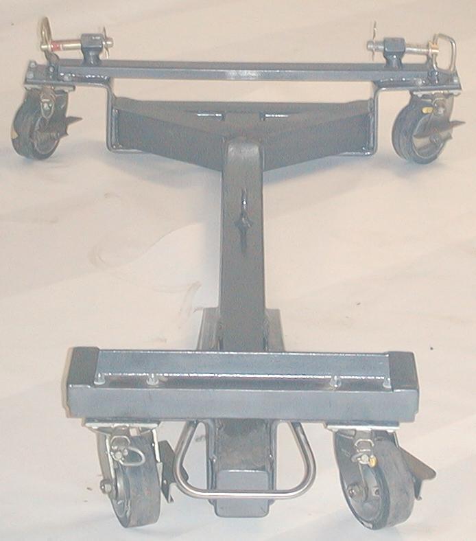

picture 3
Doug T B1700 TLB

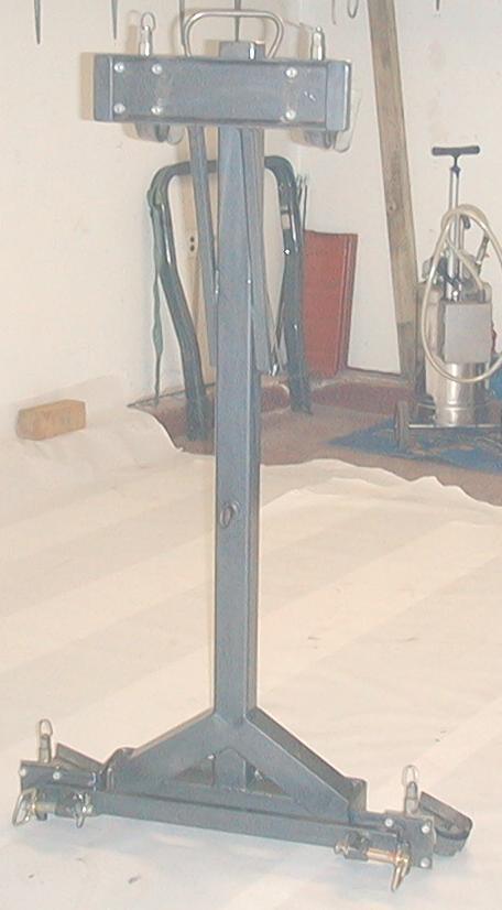

When not being used it can stand on end to save space.
Doug T B1700 TLB

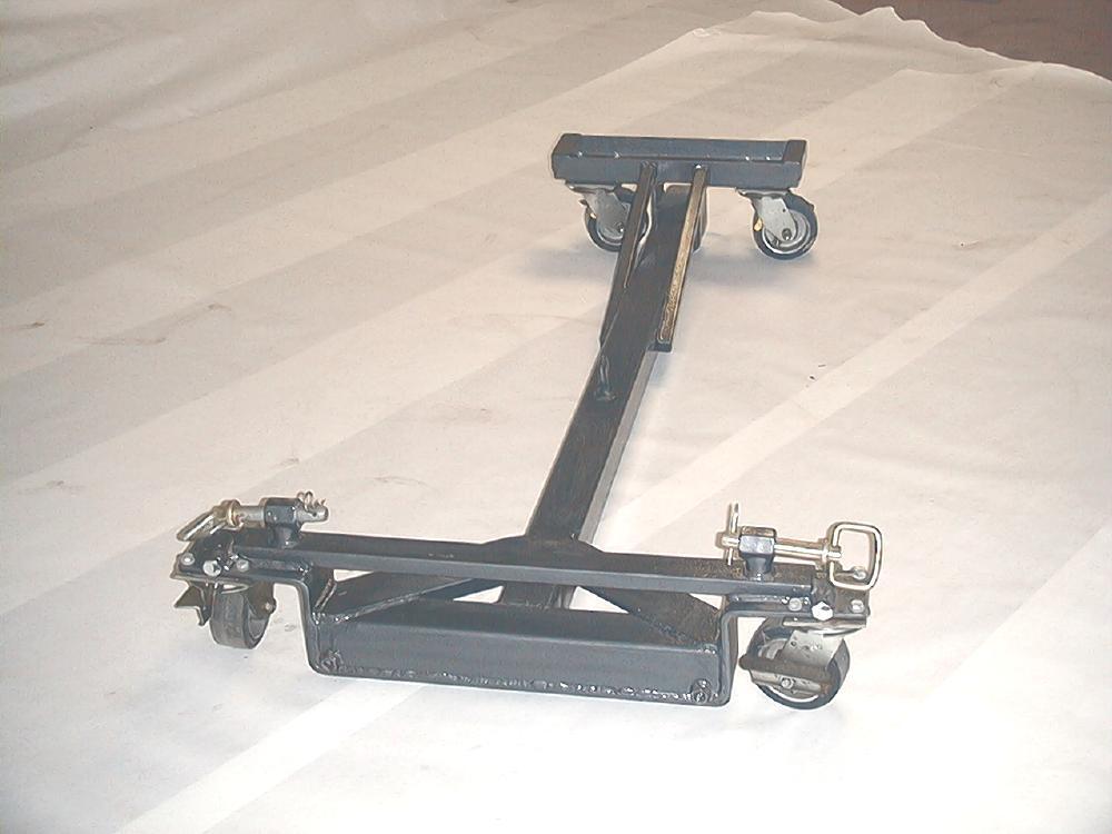

picture 6
Dolley reduces storage space quit abit.
Doug T B1700 TLB

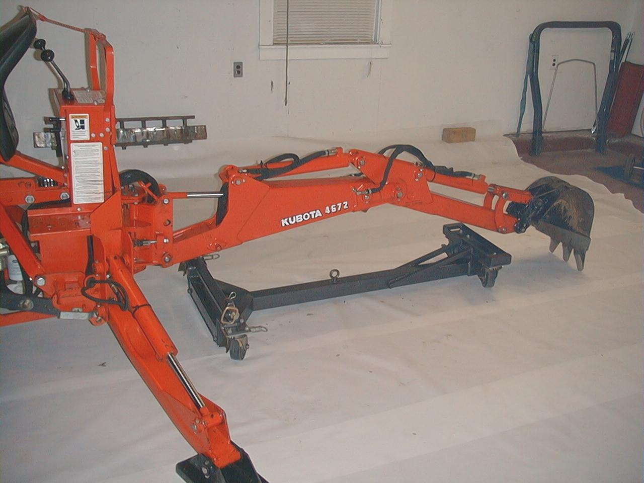

picture 7

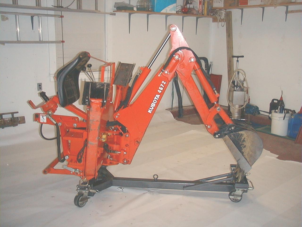

Here is the BH on dolley
Doug T B1700 TLB

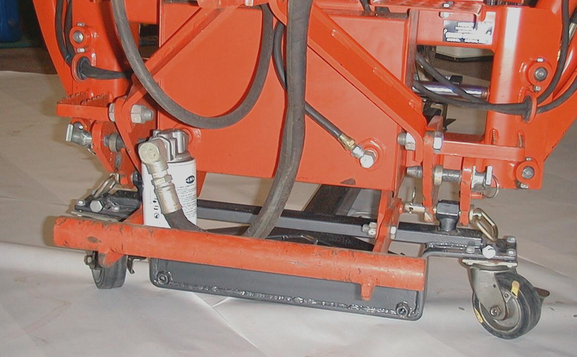

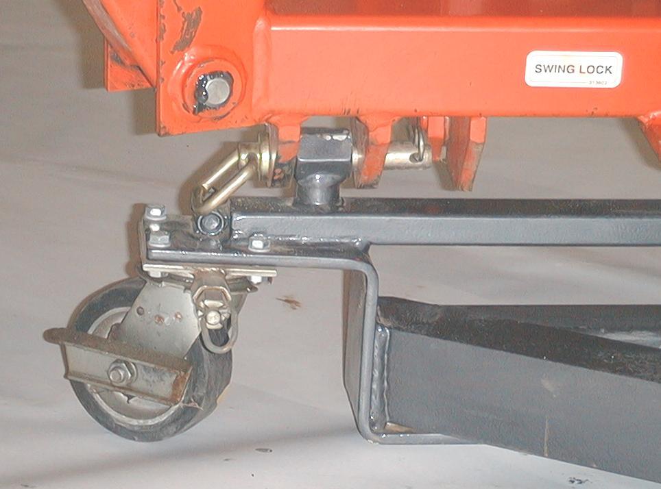

This is how the BH is attached to the dolly.
Doug T B1700 TLB

This is a view from the invisible tractor.
When the BH is on the dolly, I can stand on the round safety bar on bottom and jump or I can sit in the BH's seat and bounce, with no instibility on the hoe. At 250 pounds thats pretty good. Side stability,(me standing on the step to get on the hoe) is not a problem either.
Doug T B1700 TLB
