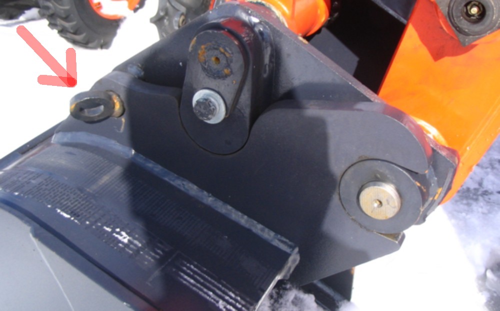

Larry,
Does your quick-attach system look like this? The L39s are coming with a single pin. Looks pretty nice.
   / Backhoe Bucket #12
Identical.. Only thing I can add is, get a whole bunch of inch and one eigth washers, and place them with the lynch pin on the other side. If you don't you will be digging and the lynch pins will get lost... I have mine now as tight as I can get it with 4 washers...
   / Backhoe Bucket
#13
Maybe there is something more suitable, like a carabiner type of clamp. I'll keep my eyes peeled. Thanks.
