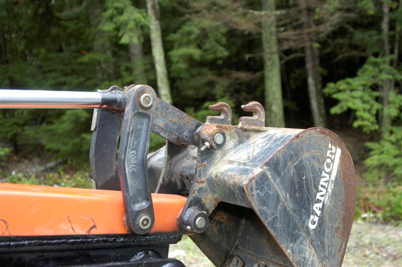

I put mine here so it's out of the way when digging, and with chain on the hook, I can uncurl the bucket for a little extra control and reach.

Ditzel, that's how I'm going to mount mine. Any issues with curvature of the bucket? Does it get hung up when digging?

/ Backhoe bucket hook #13
Do you mean curvature effecting the welding? I had none because that spot is flat, but any further down and I would have had to grind an arch into the bottom of the hook.
Hasn't got caught up on anything while digging yet.

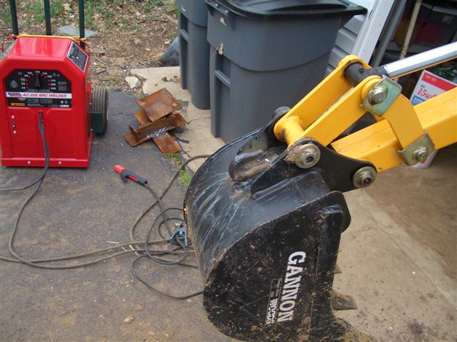

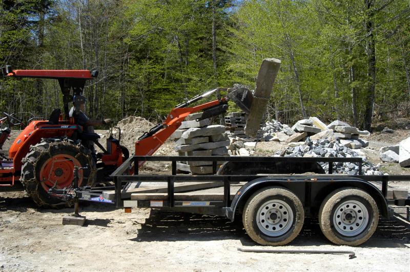

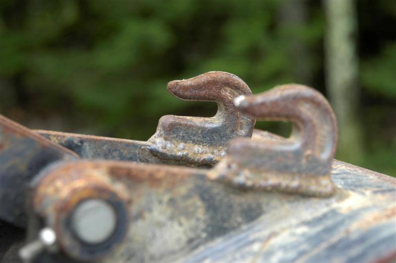

/ Backhoe bucket hook #14
Here's my setup I've used it a lot.

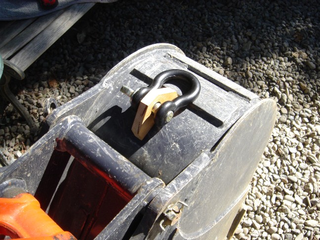

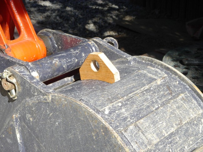

/ Backhoe bucket hook #15
Here's what I've been considering doing to my bucket. Welding on a piece of 1" steel machined to a 7.75" radius to match the bucket. (the mock-up is 3/4" thick wood) It wouldn't get in the way when digging. If I wanted to lift something I'd attach the shackle and a nylon lifting strap with a grab hook at the end. It's overkill since the lift capacity of the hoe is about 1200 lbs but what the heck. Any thoughts pro or con?

/ Backhoe bucket hook #16
That will work for sure, but one thing I've found when working is that you want to do as little additional attaching or manipulating of equipment to get the job done. Especially if it's caked in dirt or something like that and you have to clean it before attaching that shackle. If it was me, I'd opt for something easy to hang a chain on like a grab hook there...something a little more simple to attach and keep going.
However, what you propose would certainly work.
/ Backhoe bucket hook #17
Ok, youve convinced me. Ill start looking for a reason to do this. If I find something I cant rig in a few seconds with a grab hook chain and a shorty double grabhook Ill do it.
