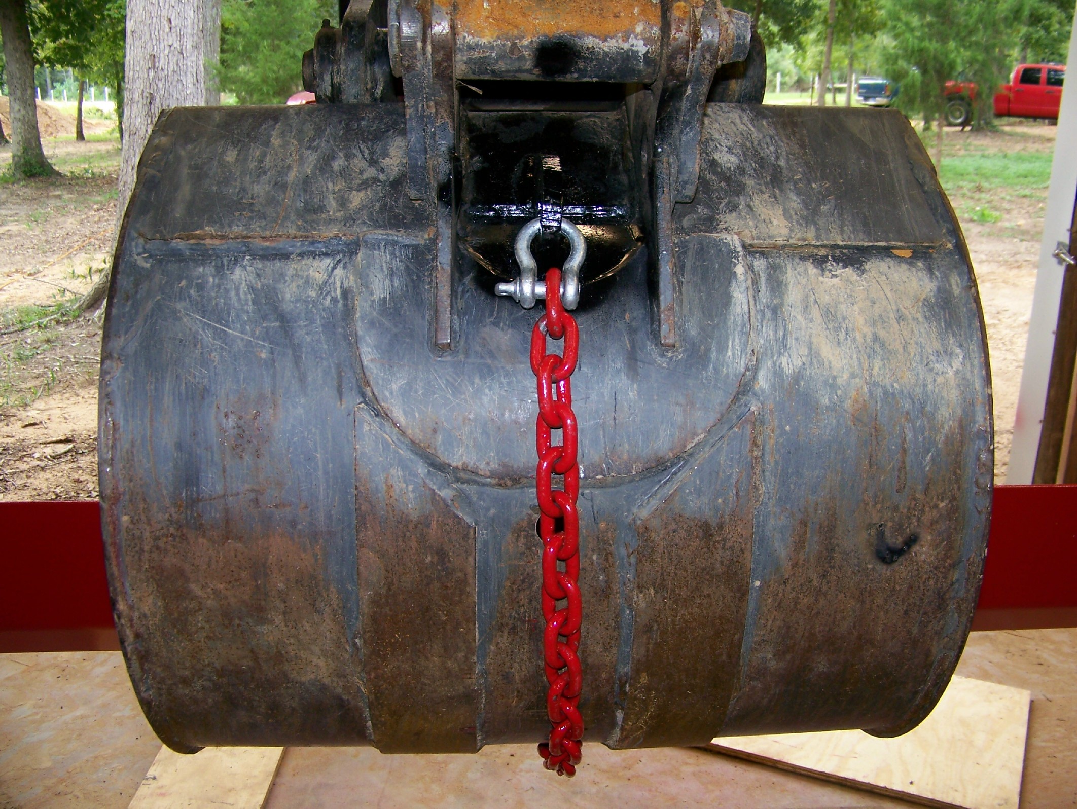

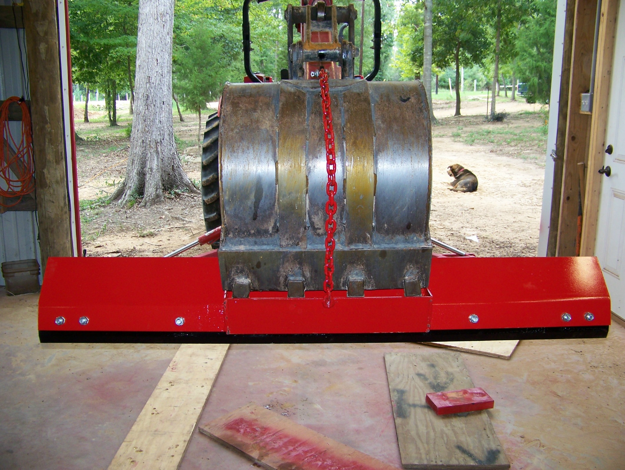

Thanks GeneV. I like the chain, as it has some slack so the blade will angle a little to follow a slight slope.

Ok, I could see that, allowing some play for slope changes, smart!

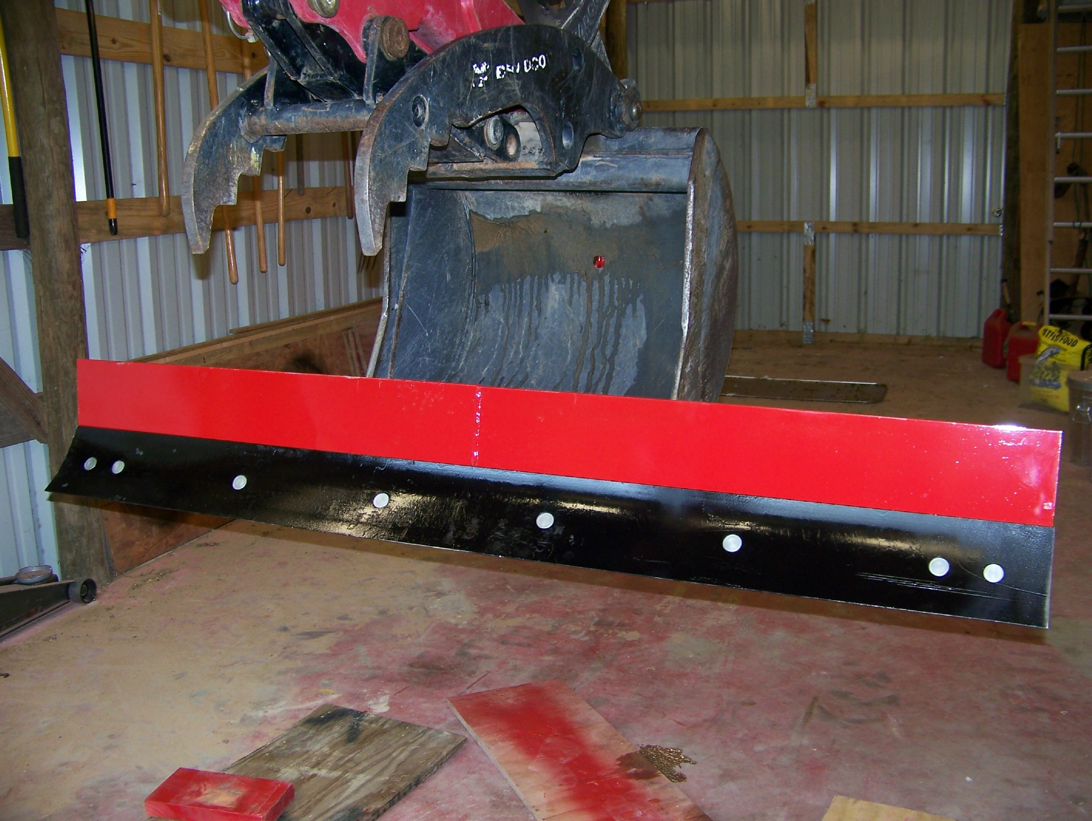

Oops. I forgot to add the painted, finished, product. It's been raining every weekend, so I have not been out to put dirt on the paint yet. View attachment 339216View attachment 339217View attachment 339218

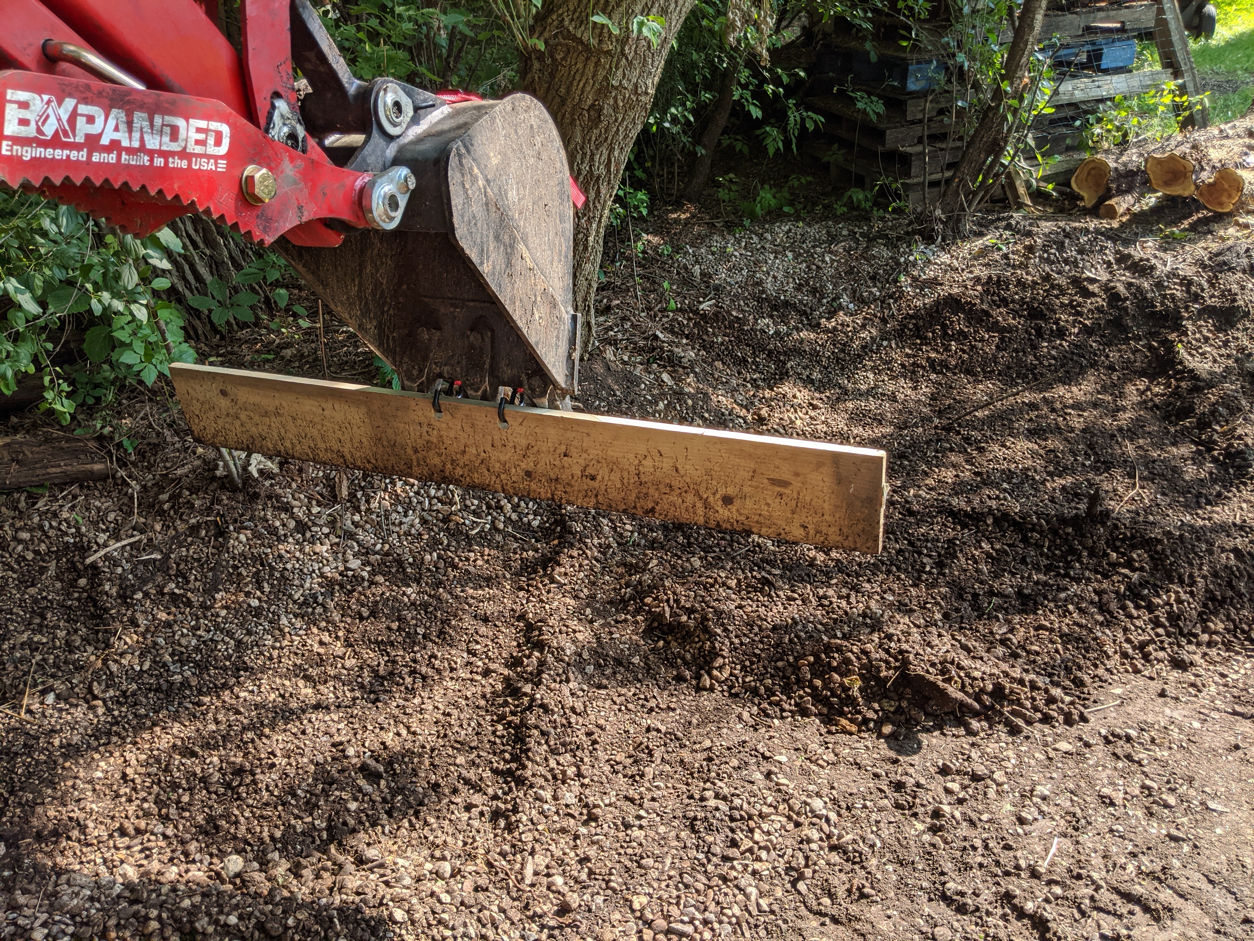

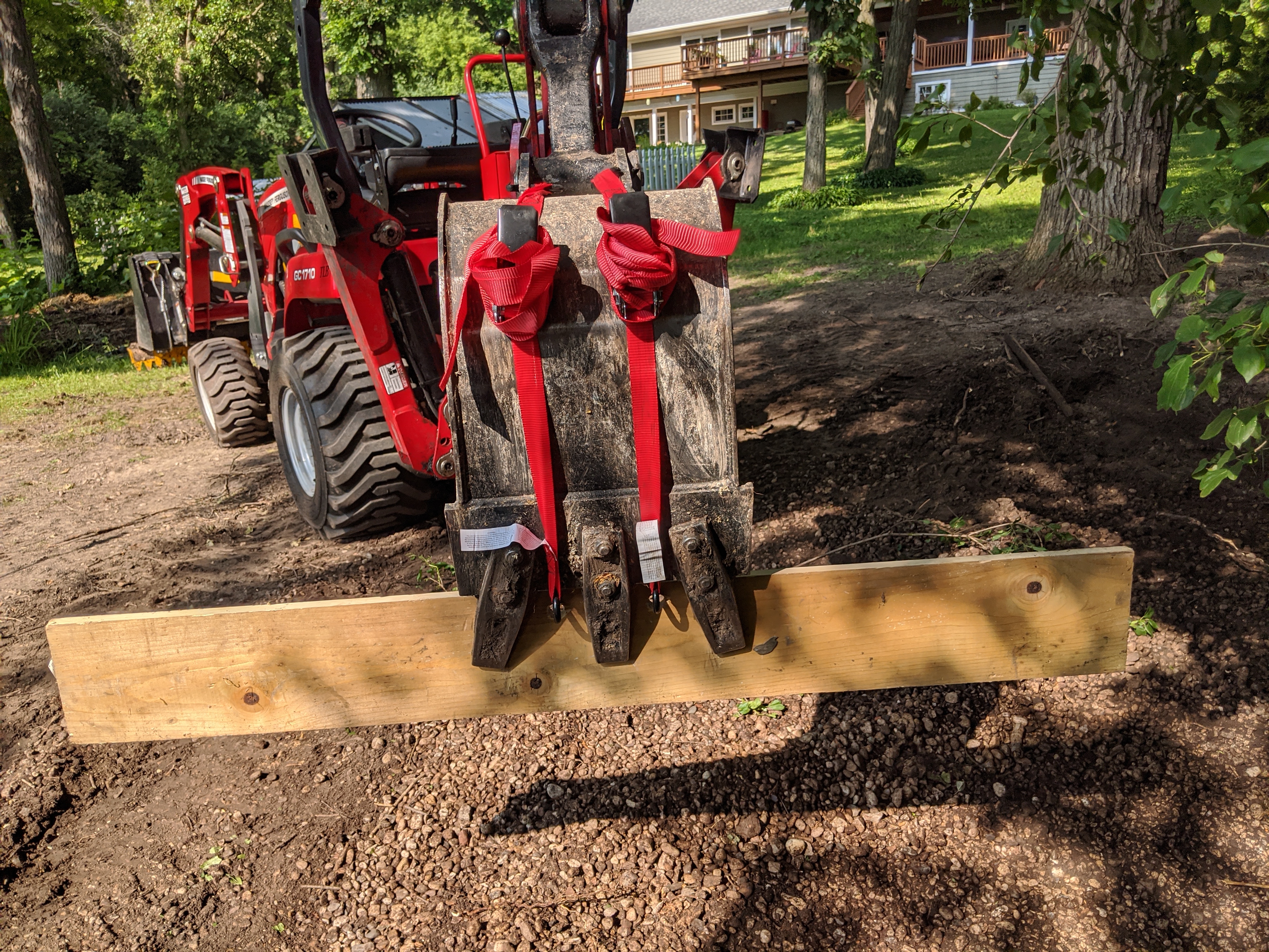

Hey Brandi, I put this together yesterday, it worked great!
/ Backhoe Bucket Grader Blade #30
I too, built a wooden working mockup. It worked great until I turned too close to a tree and made it a broken stub.
hugs, Brandi
Exactly what happened to me and it STILL worked good enough to finish the job.
