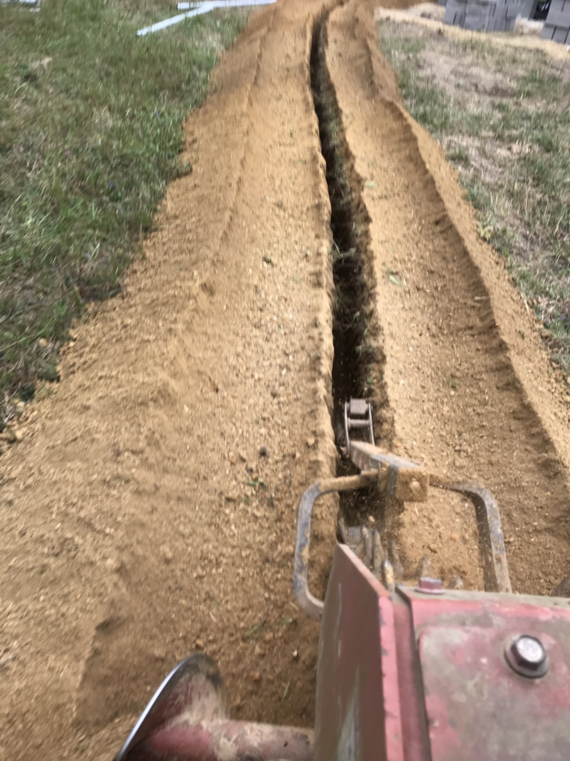

What about renting or hiring a trencher? They only dig 6” wide and grind up the dirt removed so good you probably won’t need more backfill.View attachment 693248
I considered doing so. But a cheap bucket for utility trenching can be had for ~$200 or less. And the area to be dug is rocky and I don't know what I may find in the way. Even if more expensive I can make a case for adding to the tool box with a one time investment.
