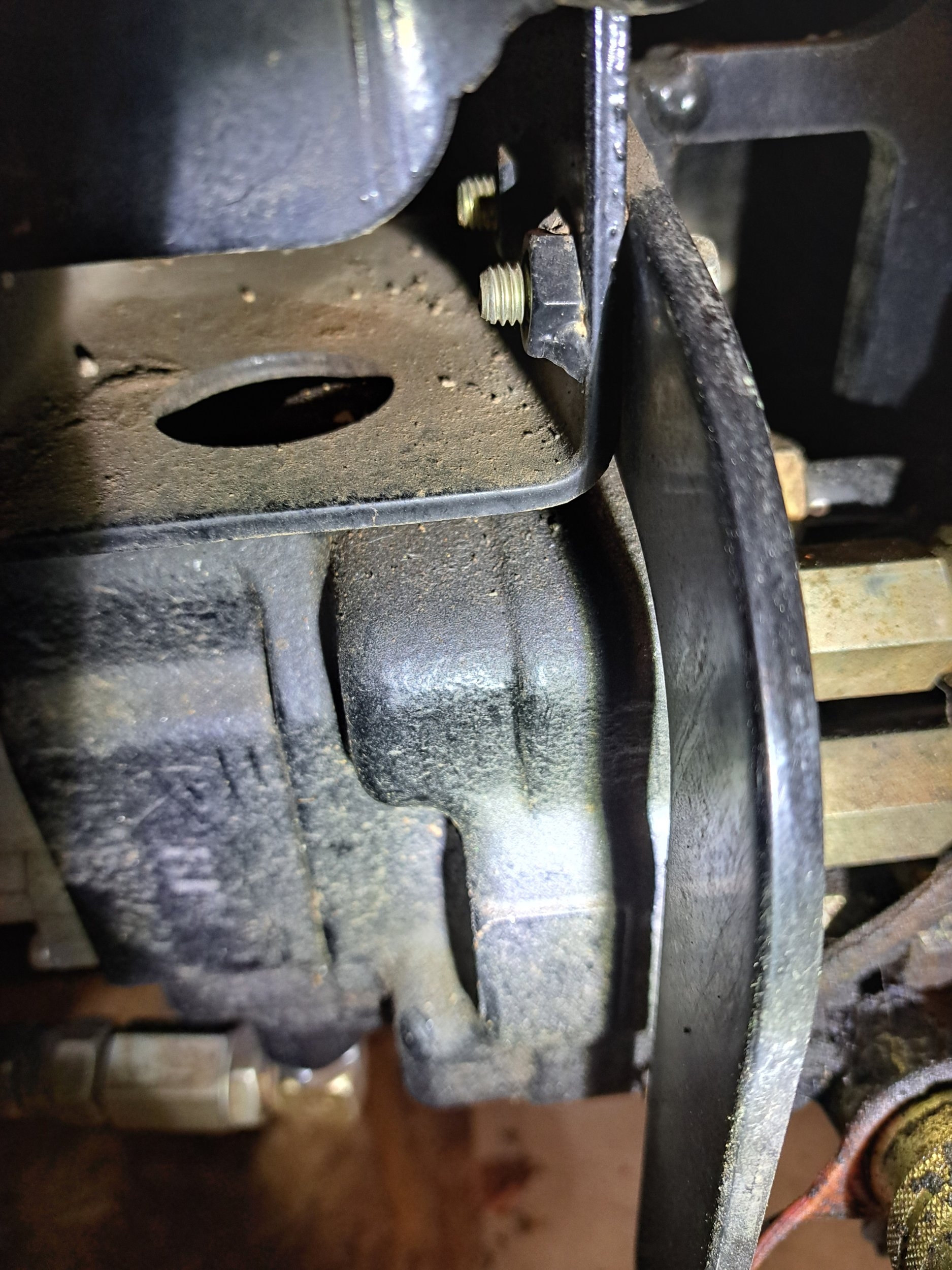

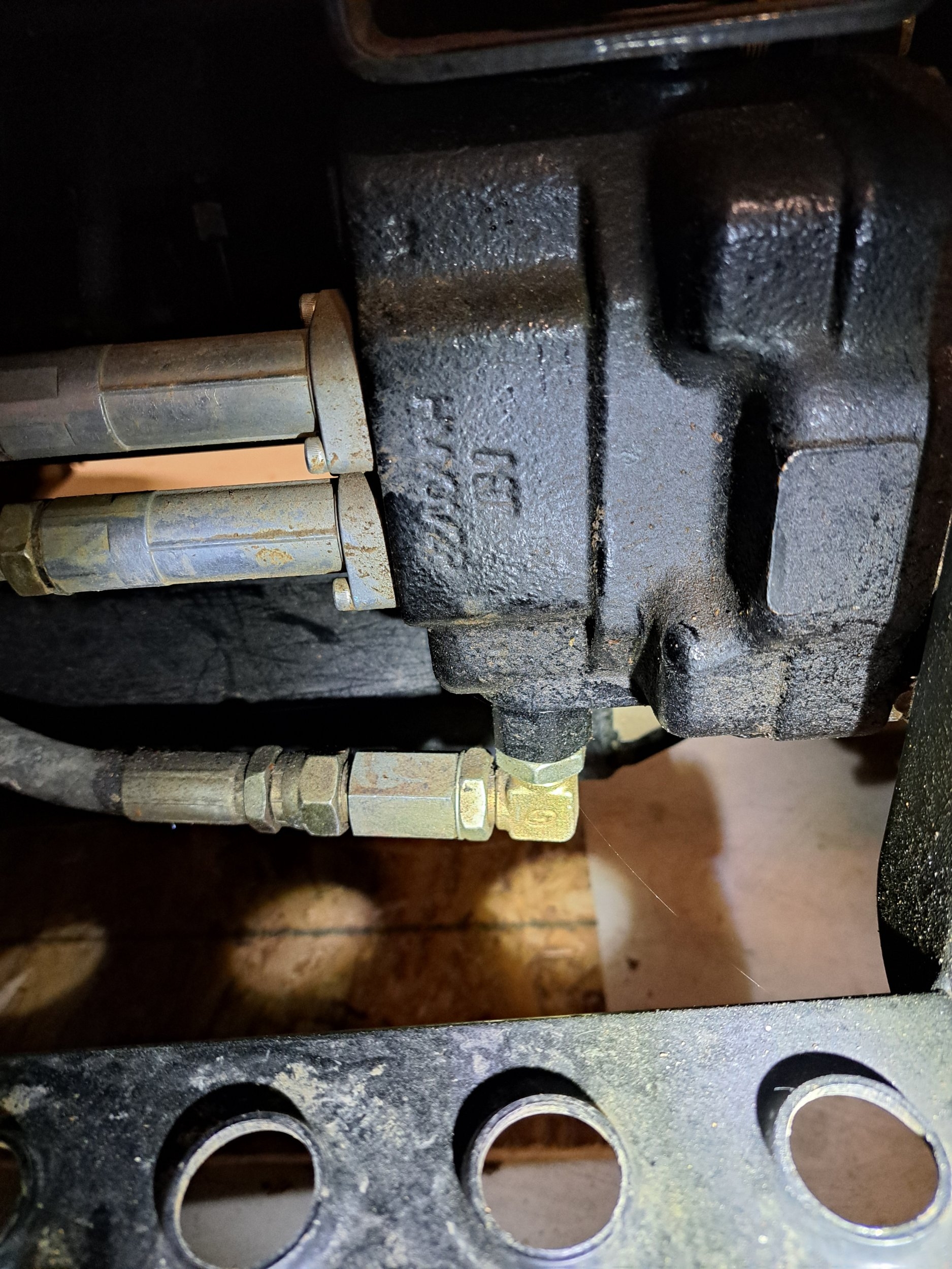

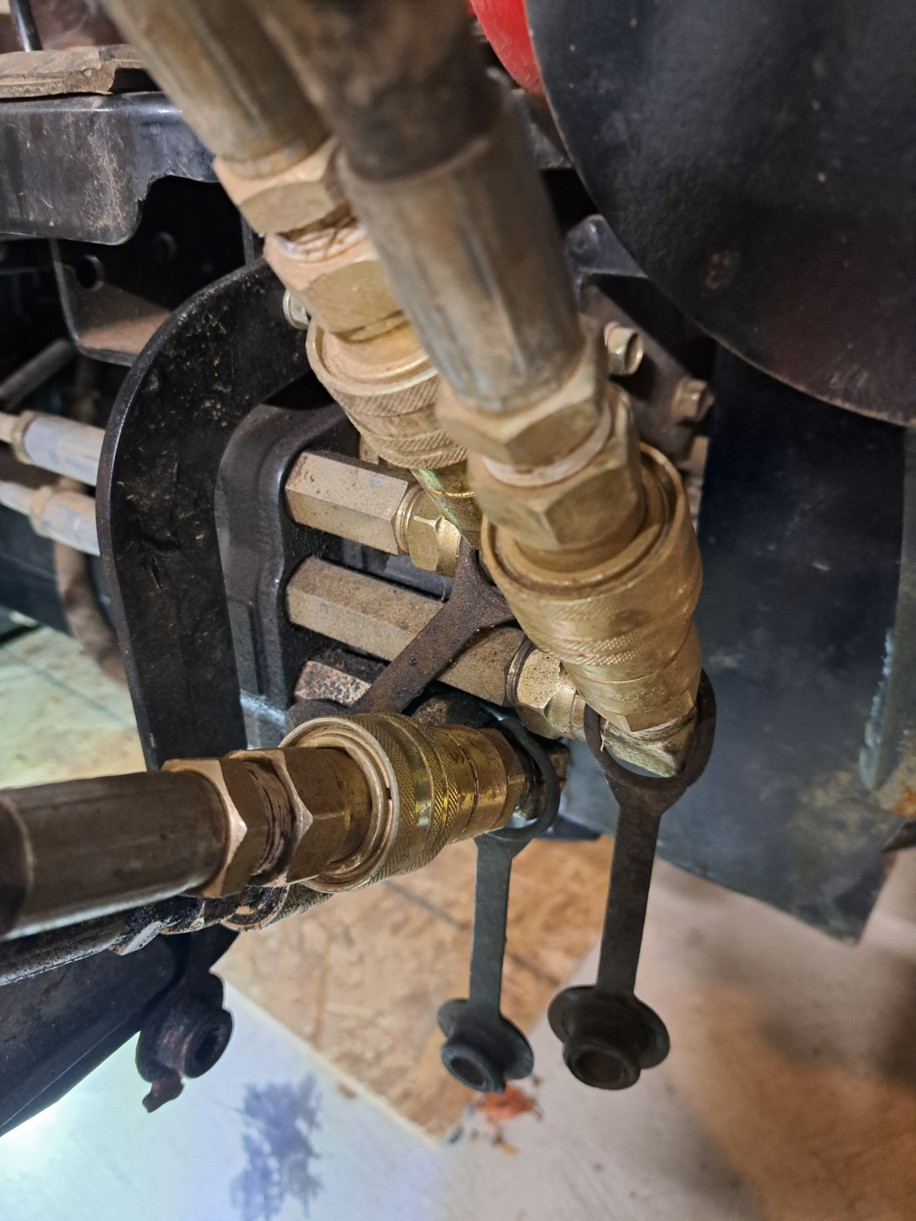

Trying to figure out where to tap in for the loader circuit, any ideas from the pictures? I see two plugs, but the one on top is not accessible (the hole is not centered). The hose on the bottom looks like it goes back to where the rear remote is. There are also two hard lines.

I could not see any “potential” pressure port options either. As a option you could put it in one of the quick disconnects for the loader and then operate that function. That will provide a pretty good idea of the loader circuit pressure.

Had to order a few more fittings, but was able to test it just now. Acting very similar, I put the gauge on one of the loader quick disconnects and it will get up to about 1800psi, but if i hold it, it slow drops in pressure to around 900-1000psi . Any ideas?

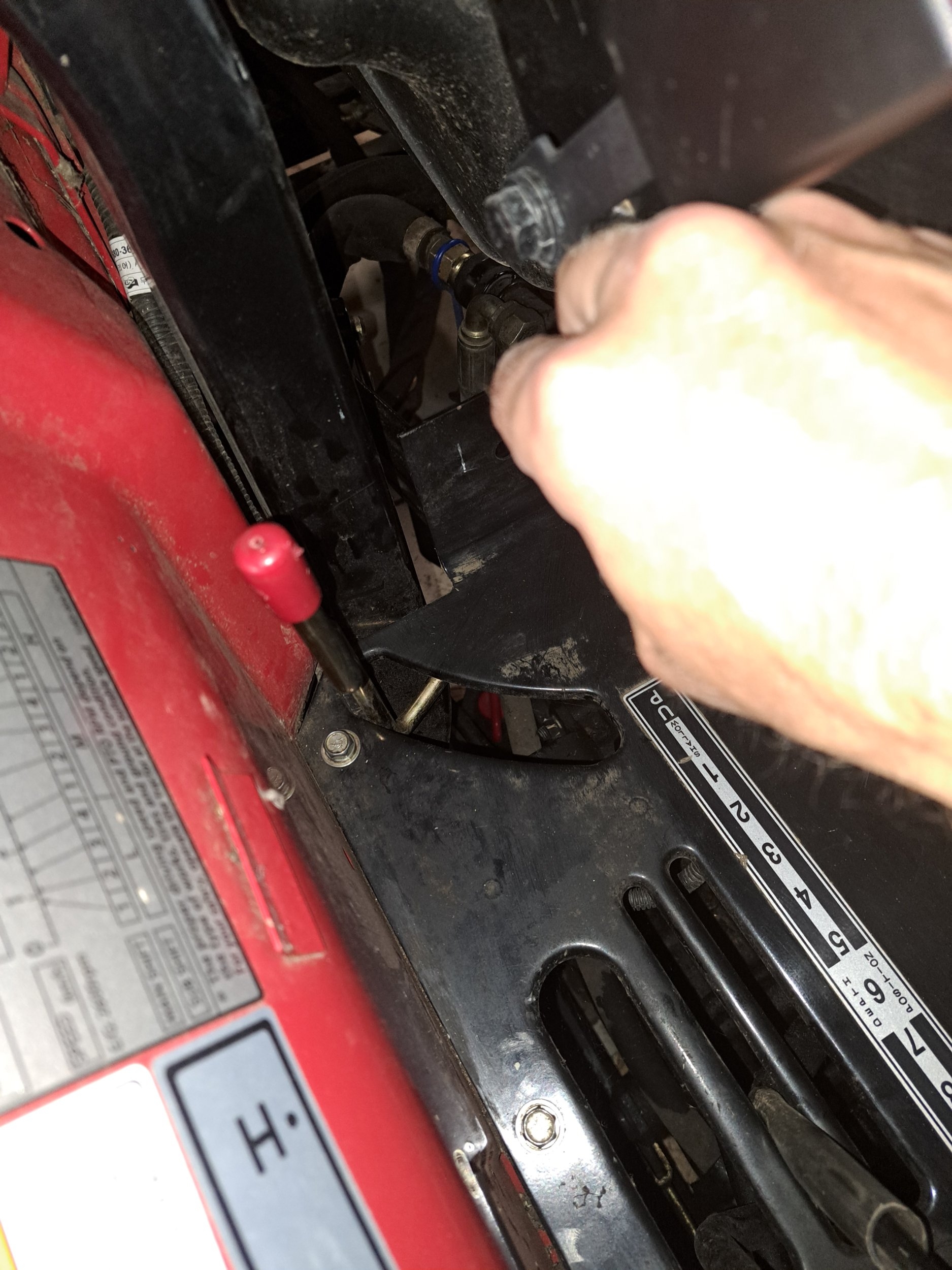

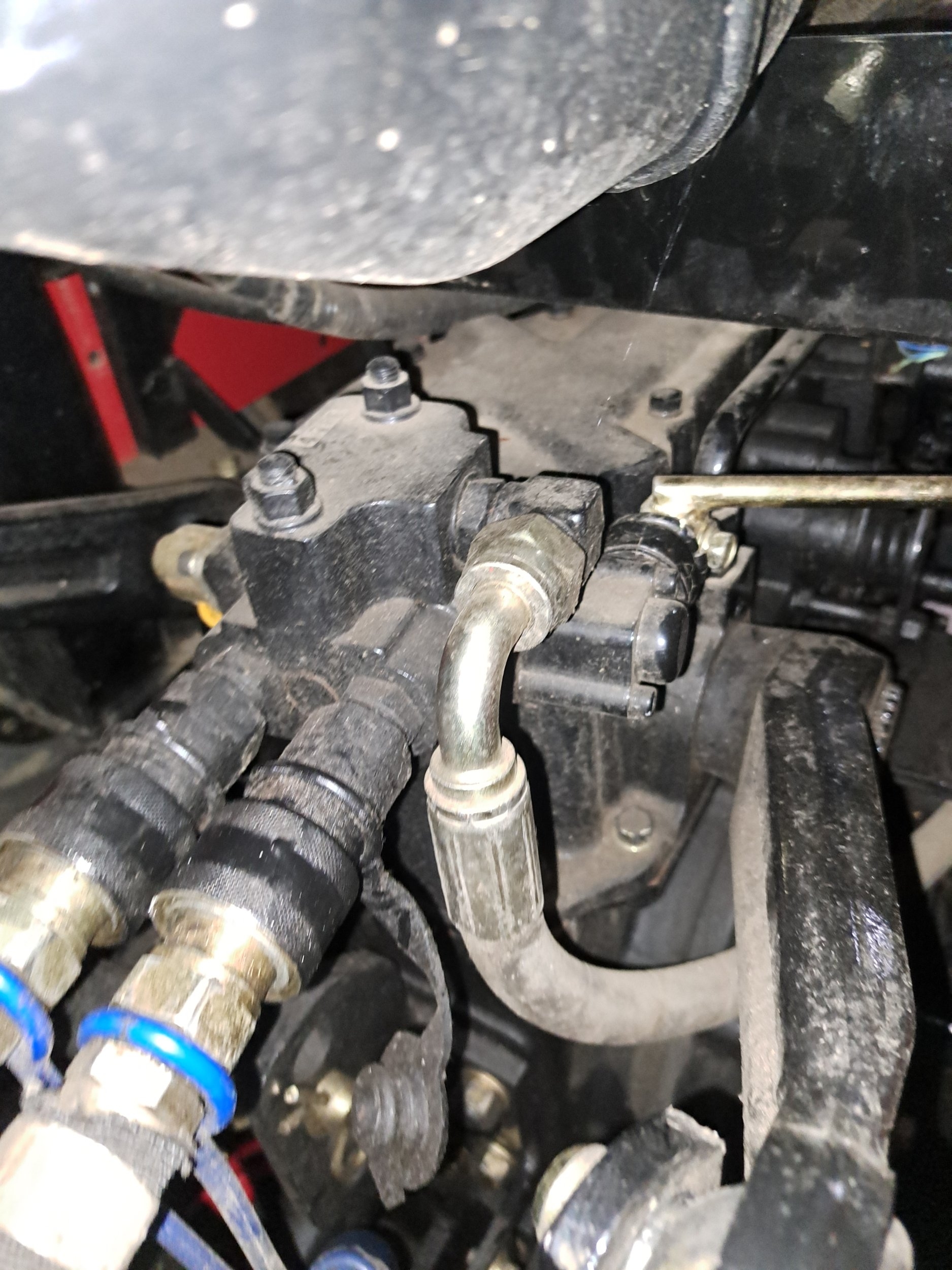

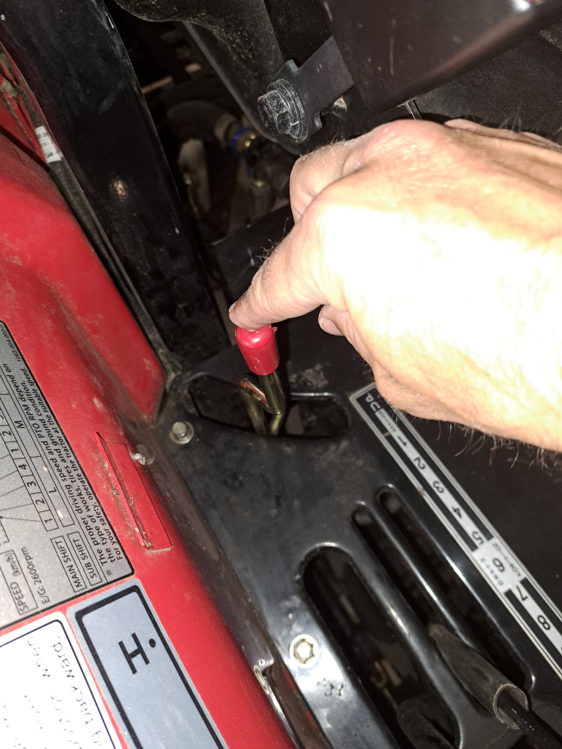

Long post sorry... So I am trying to figure out what the 3 positions do for the AUX. HYDRAULIC LEVER (See attached pictures). RK has not been very helpful in explaining what they do. So in the position furthest away from the seat I assume applies pressure to the backhoe (or whatever i have in the rear remotes.). In the middle position the 3 point hydraulics work. In the position closest to the seat I can not figure out what this does. I do notice when I put the lever in this position the hydraulics sound like they get loaded down even though I am not using anything. Is this normal? The loader functions in all 3 positions which i assume is normal since it is first in line.
To answer your first question,
I was quickly pulling the lever. I tried again going slowly. It would get to 1500 psi, and slowly drift down to 1000 psi, however this reading varies depending on the AUX lever i mentioned above. If i have the lever furthest away from the seat (backhoe operation) it would only get to about 550 psi, and hold steady.
I could not find any documentation in the tractor manual, but the loader manual says the relief valve setting should be 2347 PSI.
I am not sure how hot the gear pump casing should get, but after running for a while the one side of the pump was pretty hot...... too hot to keep my hand on it.
Forgive me, not sure i understand "If power beyond sleeve gets warm" ?
Thanks again, sorry for the long post.
