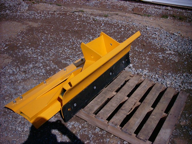

I have been working with the instalation of my new pool and used my backhoe level the ground. I find it difficult to get a good finish with the bucket ( about 30" wide).
Have any of you build a blade to fit a backhoe instead of the bucket?
If the construction is not too complicated I might build it myself. I have made a rippel tooth of simple design which works quite well.

We built a couple of them for a local landscaping company. The hoe bucket goes into the back socket, then pins on.

Thanks Jim!
Your picture looks like the conception I was thinking about.
Thanks also to rlw and EdKing.
Maybe it is easier to bolt something to the bucket than making a new outfit to replace it.
