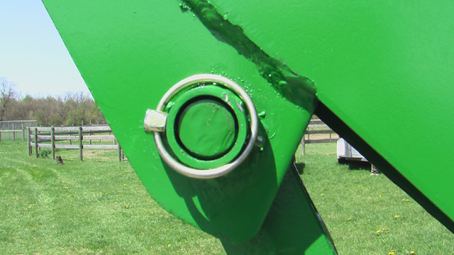

I ended up pinning through the pin collars in order to keep them stationary as suggested. Thought about welding tabs and drilling through and threading the frame but decided to see how this works.
To be honest I didn't keep track of the time I spent working on it.
Basically I would work on it on the weekends then get away from it for a month or more, then back at it again. We have horses so they take up a lot of my available time and I haven't put heat in the garage yet so I lost the winter months. I started it about a year and a half ago but have maybe 20 weekends worth of work.
Just a guess.

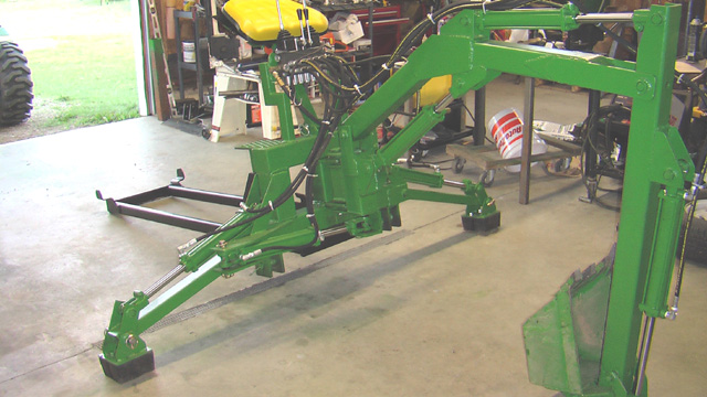

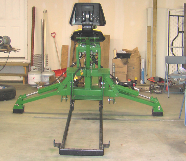

Here are a few photos with the BH detached.
Pull 2 pins on the subframe, disconnect the hyd lines and drive away.
Too easy!
