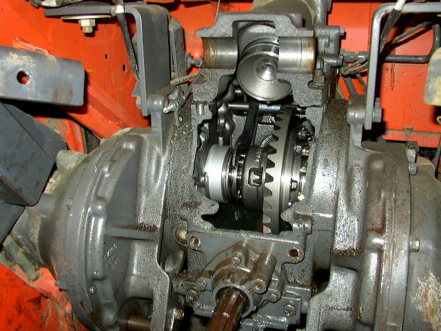

Below is a picture of what can happen with too much force on a 3-point hitch. This happened by mis-using a logging winch, not a backhoe. But it is food for thought if anybody thinks 3-point hitches can handle anything. It's been a while since this wreckage was posted at TBN .
Offered again here as a cautionary tale......
