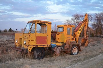

Picked up a backhoe the other day, a Truxcavator:
Was originally made to go on a truck (take off the tailgate, bolt it on and it runs off of a pump on the engine).

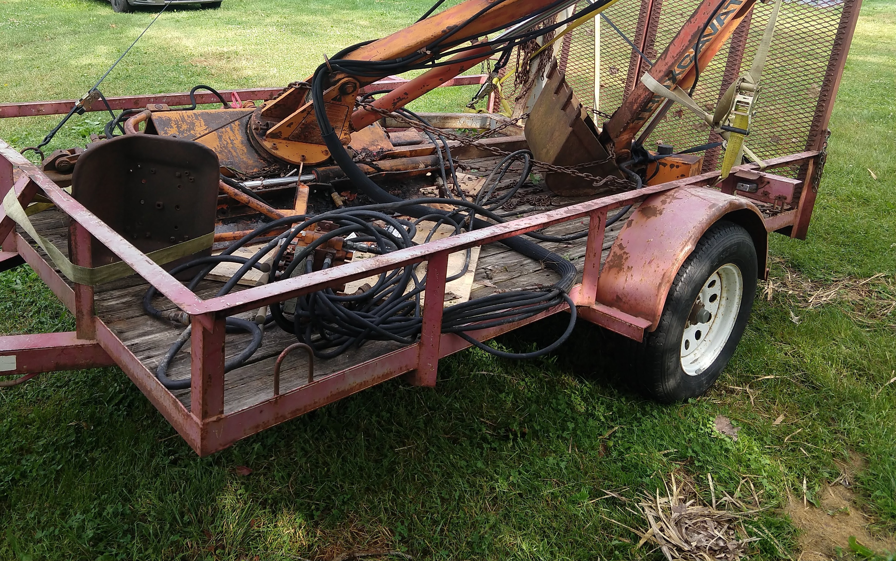

Debating between converting it to a 3 point mount, or setting it up to sit on the back of a trailer (like this one that the guy also had for sale):

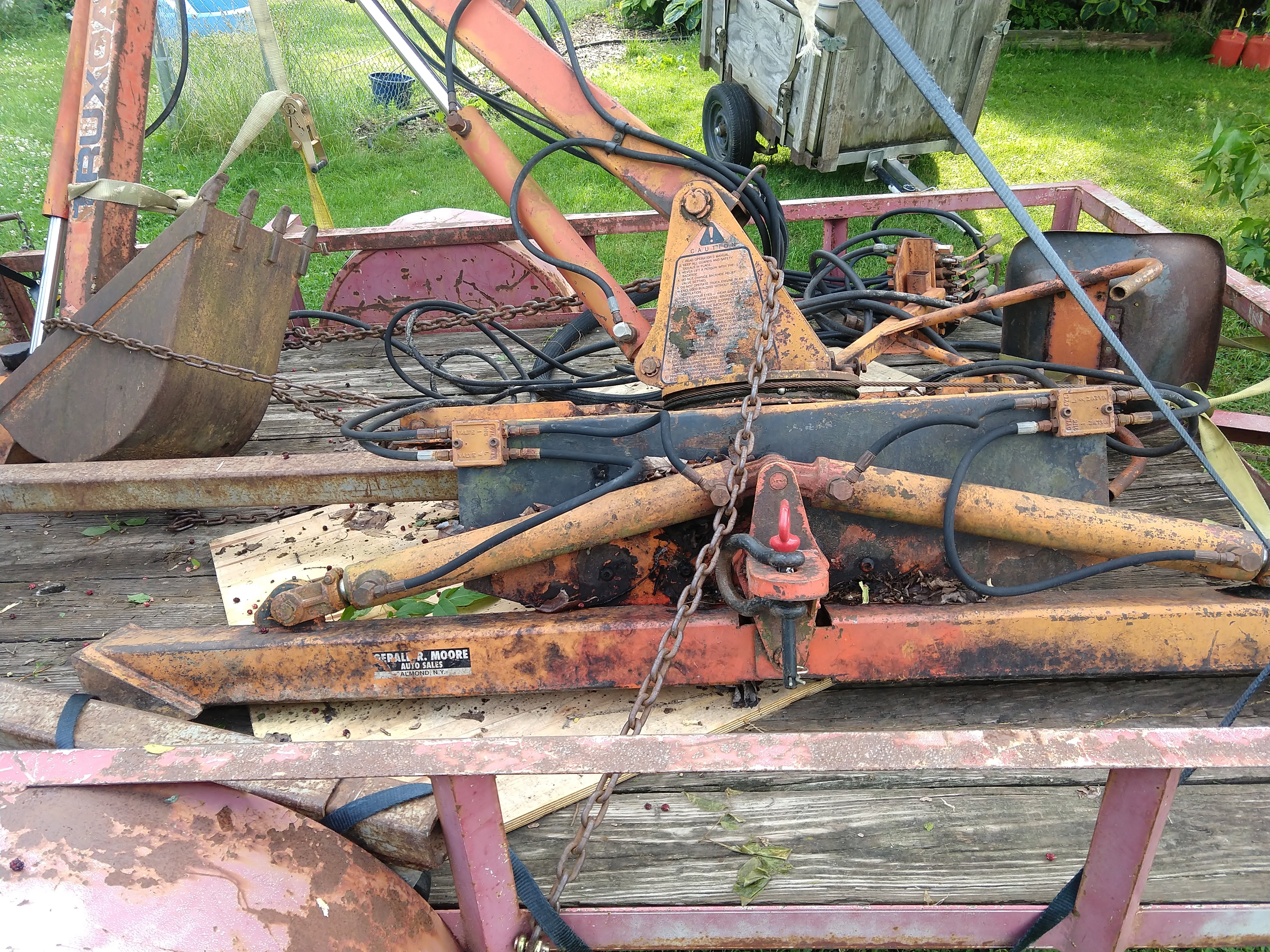

If putting it on the trailer, it would get a pair of hydraulic "feet" on the front so it would have 4 outriggers.
The trailer has a curb weight of 1350# per the dataplate, so it would be somewhere around 1800-2000# with the backhoe installed.

Of the 6 backhoes's I've had only one on a 75HP Cat 2 New Holland 75D was a 3 point mount. That was a rugged 10.5 foot woods. Worked fine, but mounting and unmounting it was a muti hour job. I think you'll be fine size wize. A trailer mounted hoe appears very cumbersome to me.

Just going back and forth, trailer mounted would be easier to take to my brother's place if needed (don't have a trailer that will handle the larger tractors) and be quicker to "get hooked up".
Not sure how things would work with adding a platform to sit on while operating it, there isn't currently anyplace to sit on the backhoe itself.

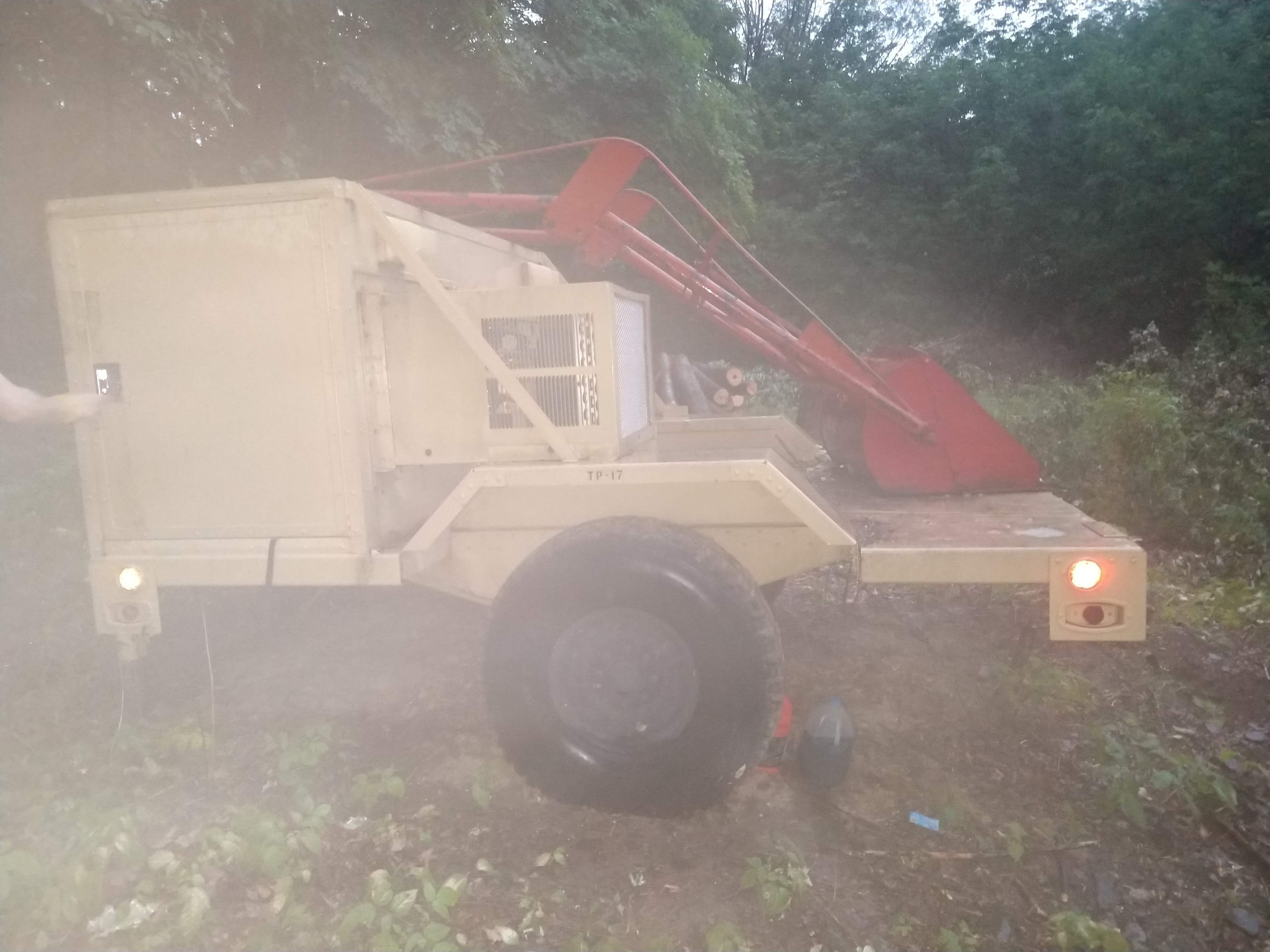

I say slap it on a trailer, make it have four outriggers that reach out a decent distance for proper stabilization, and run it off whatever pump/engine setup you can scrounge up. You won't have much into it, it'll be useful simply due to the ease of moving it around from location to location, make it so you can tow it with your truck and behind a tractor. I'd do this project in a heartbeat if I could find the parts for the right prices.
Make sure you have enough tongue weight when "stored" on the trailer for towing, too much tail weight can be catastrophic.

Totally agree about tongue weight if pulling at any speed. But a big help fir this will be the hydraulic tank, pump and engine to run the rig.

Depending on the size of the hydraulic tank, he may also want to think about a baffled tank. That surge when you hit the brakes can be nasty depending on tank size and how much liquid is in it.

The current tank is small (3/4 gallon?), I plan to replace it with a larger one (2-3 gallons?) if I can find one.
I will probably just use this as a build thread.
