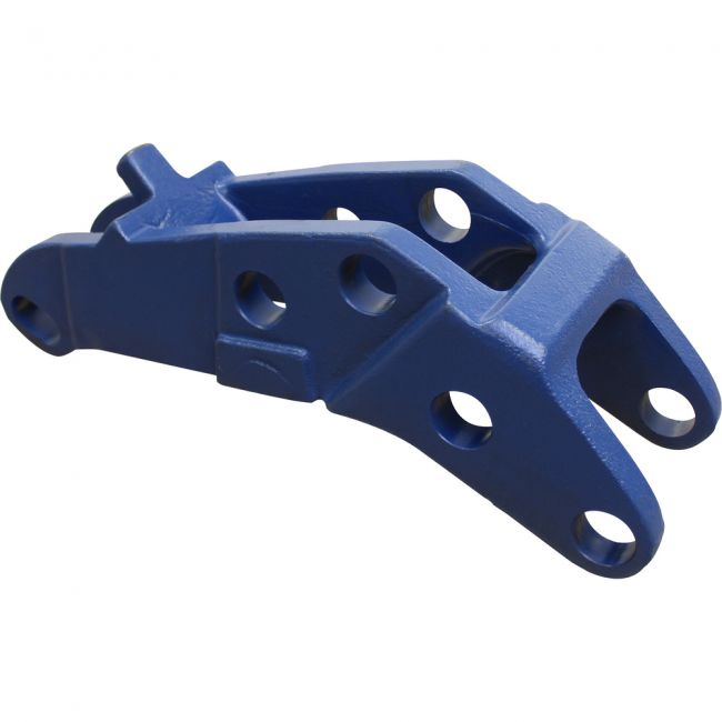

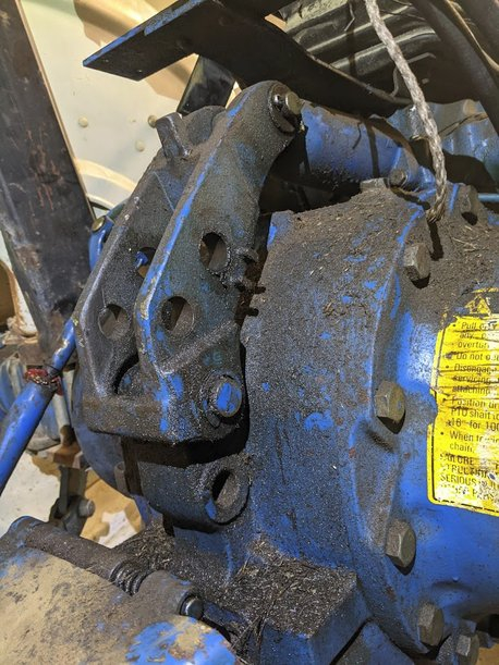

If this is a problem, my current solution is to purchase a different toplink bracket. My current bracket only has one bottom pin hole (pictured below).
I was thinking I could buy a bracket like the one below that has two bottom pin holes and put a pin through each hole when the backhoe is attached, this should minimize the force being applied to the draft system. Would this be fine to also use when plowing when I want to use the draft if I just remove one of the two pins, or would I need to swap the whole bracket? I also know that I can attach the backhoe to the bottom of the two holes on the toplink bracket and that would apply less force to the draft system without needing to buy a new bracket, but I don't know if that would be adequate. Thoughts?

If anything, the bracket will work as a fuse and may break instead of the much more expensive rear end housing like usually happens on tractors without draft control.

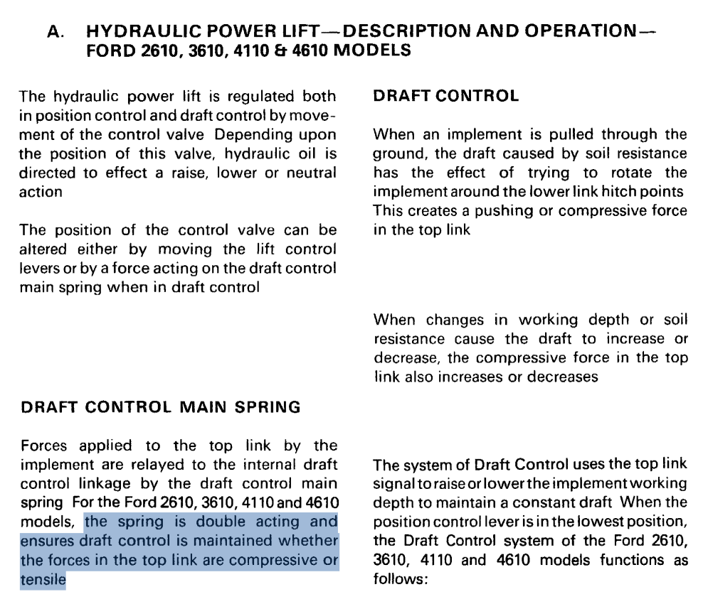

I appreciate your response, however, you are incorrect about the functioning of the draft control system in this model of tractor. The 3930 (which corresponds to model # 4110 in the manual I have) has a double-acting draft spring designed to sense compression and tension.
I can understand Ford/New Holland not seeing a need to publish the load ratings for the draft system as it was obviously not designed to operate with a backhoe, and it's very unlikely for an operator to exceed the draft load limits during typical plowing. However, I have to think that the tractor was designed with the idea of it being used in a situation where the draft control may be at risk of damage. Otherwise, I don't see why there would be a toplink bracket that can be made not to pivot since this would prevent the draft system from functioning.
