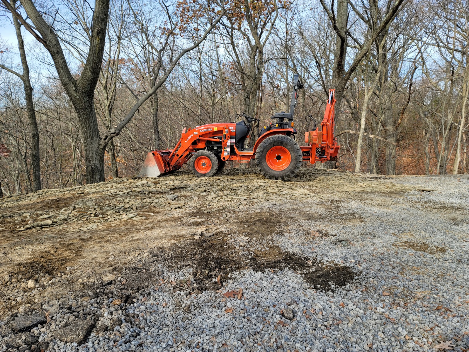

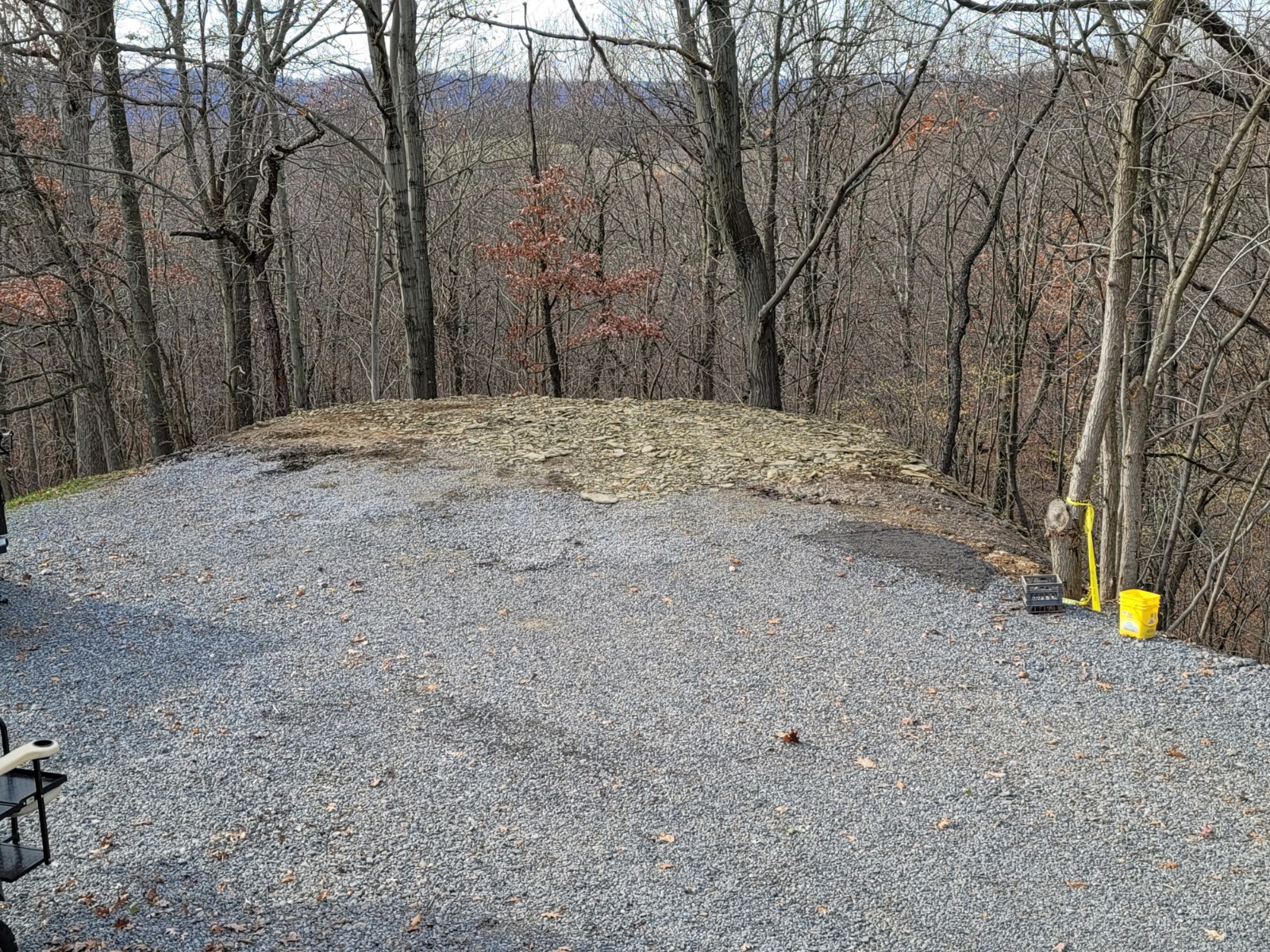

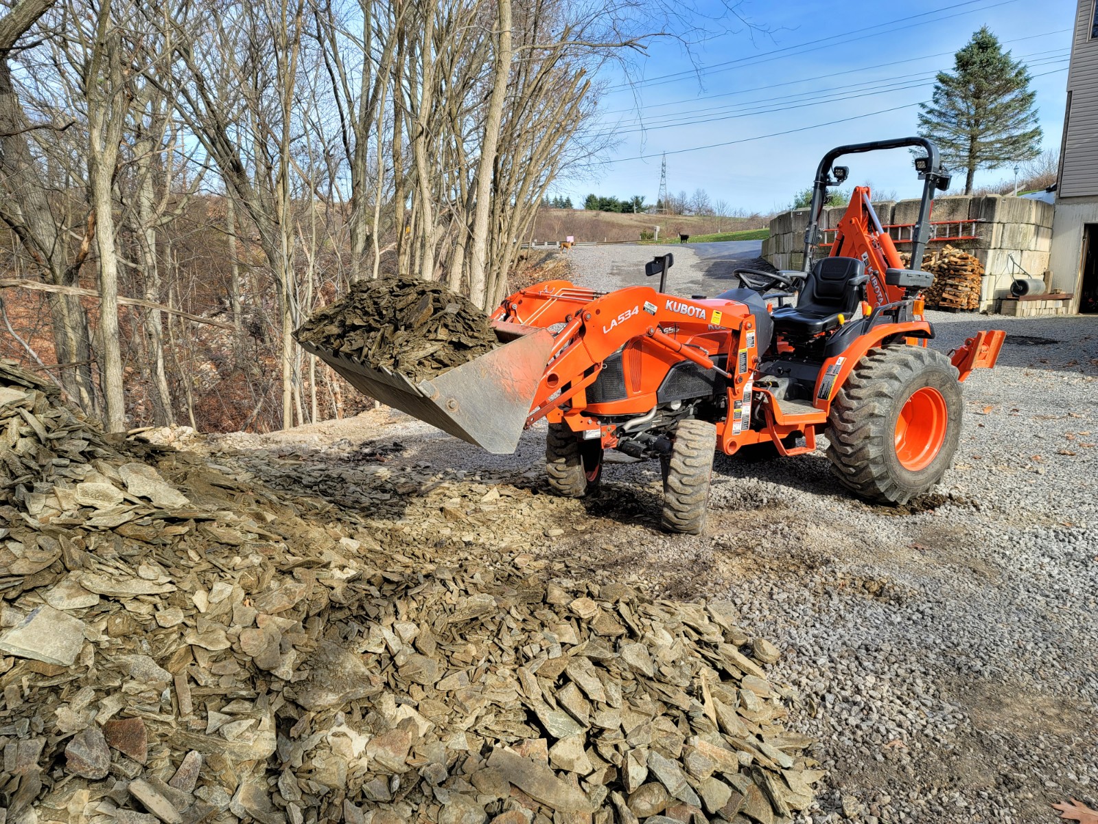

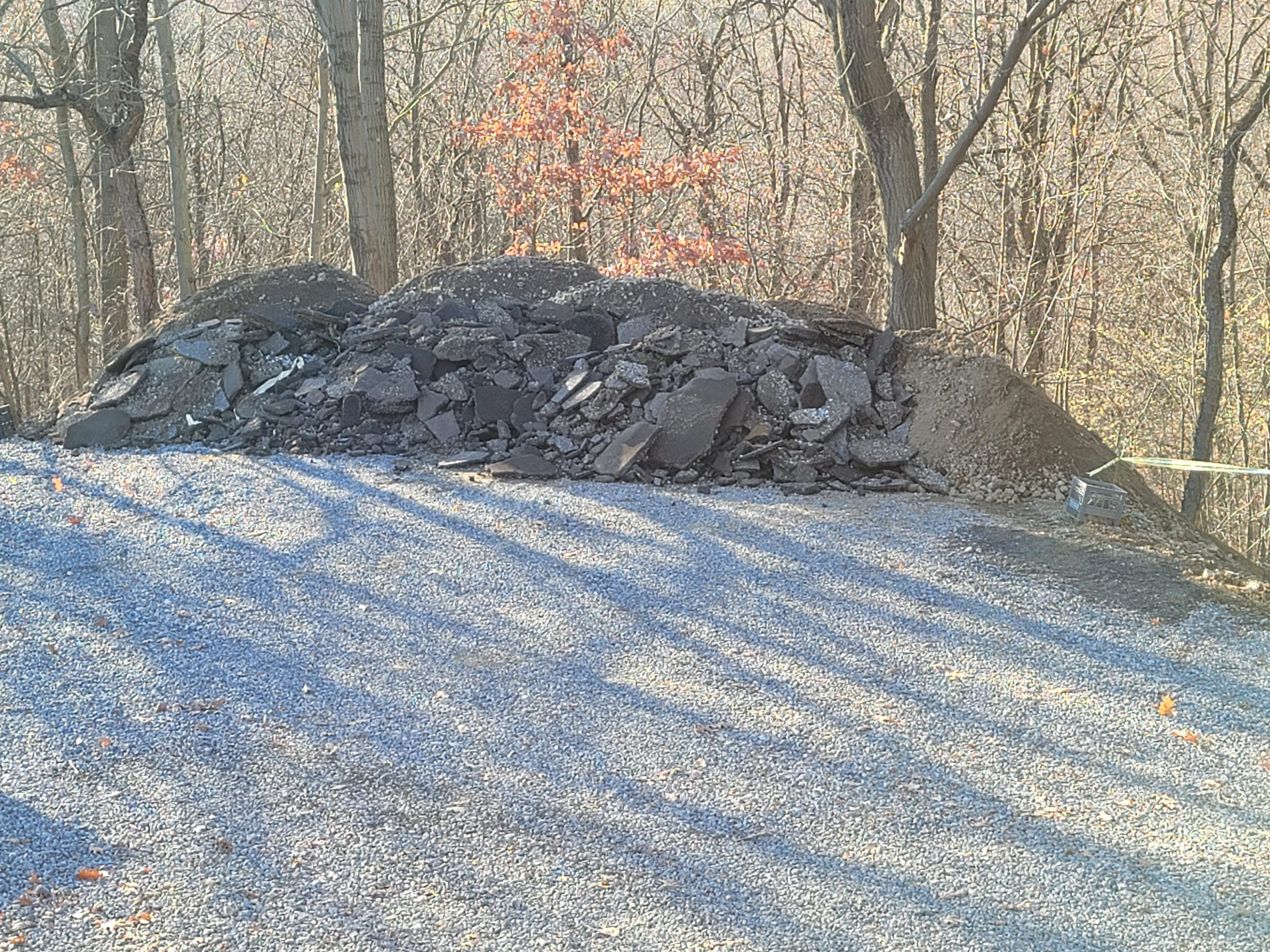

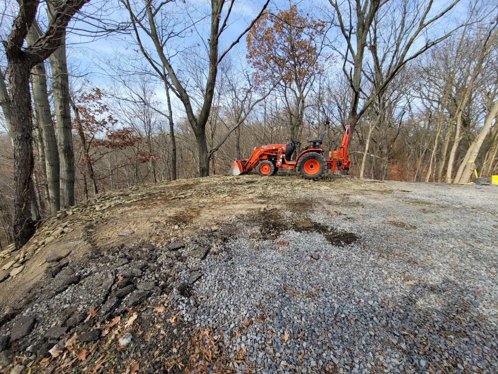

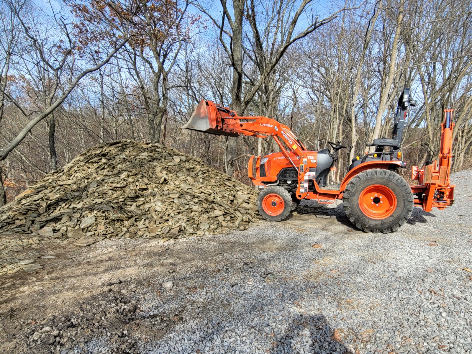

I do TONS of backdragging with a little B2650. I angle the digging edge down around 20 degrees and I do lift the front tires off the ground. As I am pulling the spoils back I tap the level towards my right thigh to take angle off the bucket as I go, this keeps you "losing" material that you dragging. It's a bit of a art, you learn to tap that angle out to flat as you go. At time I will go over the edge of the fill pile, tilt the bucket sharp to about 45 degrees to start the spoils pile and quickly reduce angle as I back the bucket to the solid surface I am dragging to. Then I go back to my tapping out the angle as I go. I've done over 600 hours in 3 years like this and never hurt anything. But I do not back drag fast, and I am always watching the spoil pile I am dragging and tap out that angle to adjust and lose material at the rate I want.
You would have to experiment with my technique and see what I am talking about. But always go slow in low range and you can feel if your getting caught on a large boulder or something that is pulling o the bucket.
The following is a typical day for my baby tractor. It moves dirt and rock for a living and it drags, packs and smooths it every time. We get sometimes as much as 15 or 20 dump loads a day. Some days nothing... But it can do this work easily and quickly and suffer no damage.
