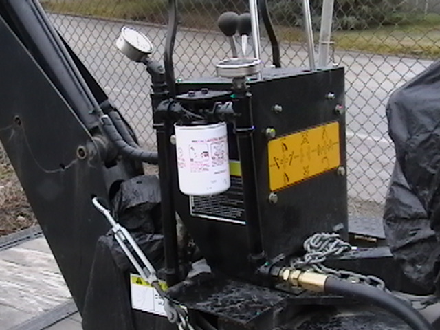

I mounted my return line filter on the console, but admittedly I'm a little more **** than most because I also employed a restriction gauge and a thermometer.
