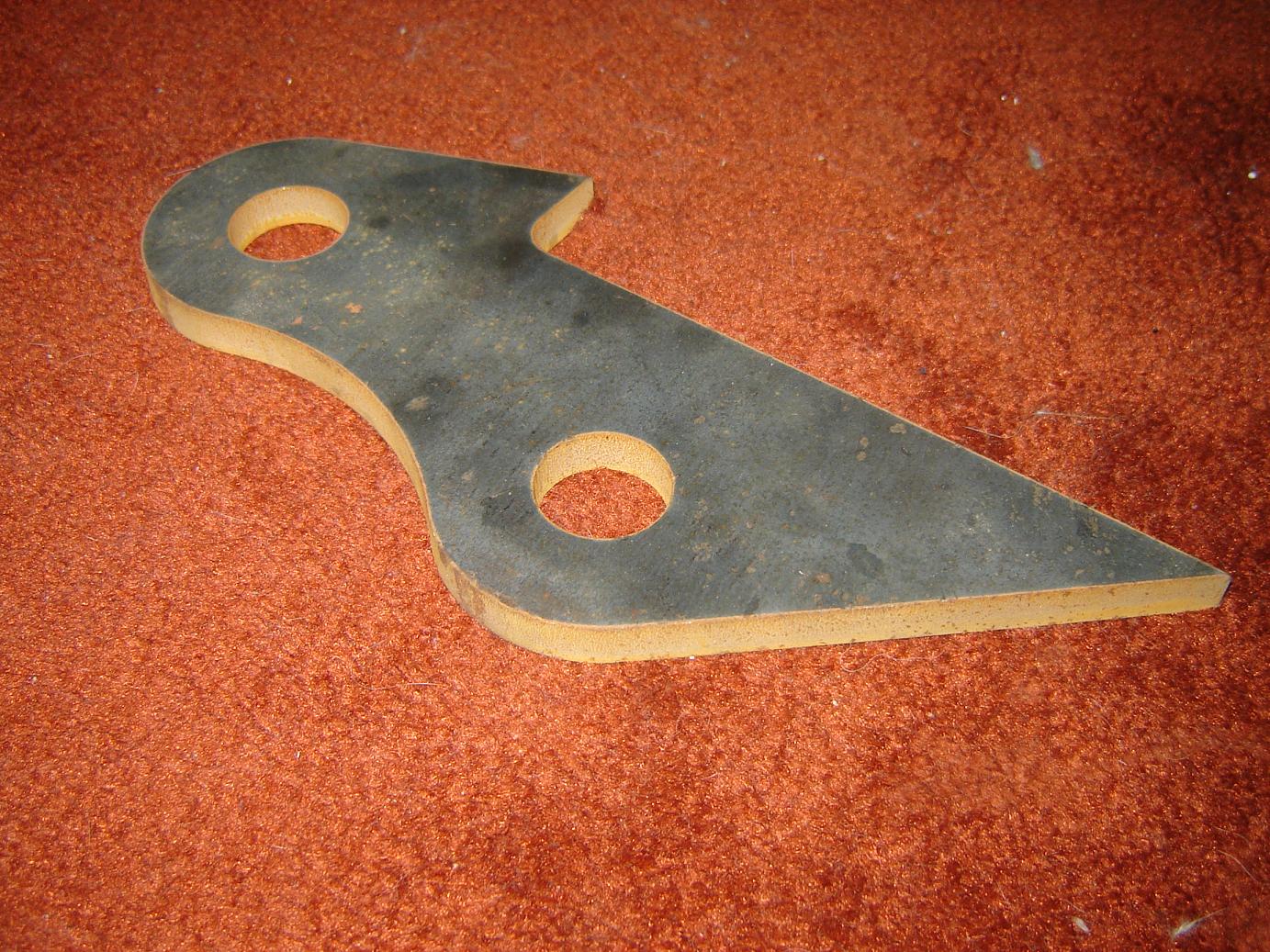

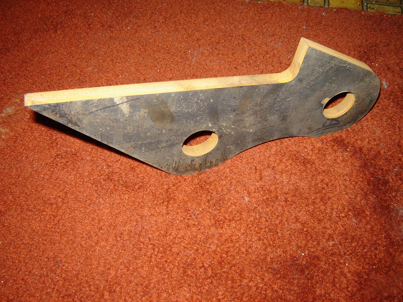

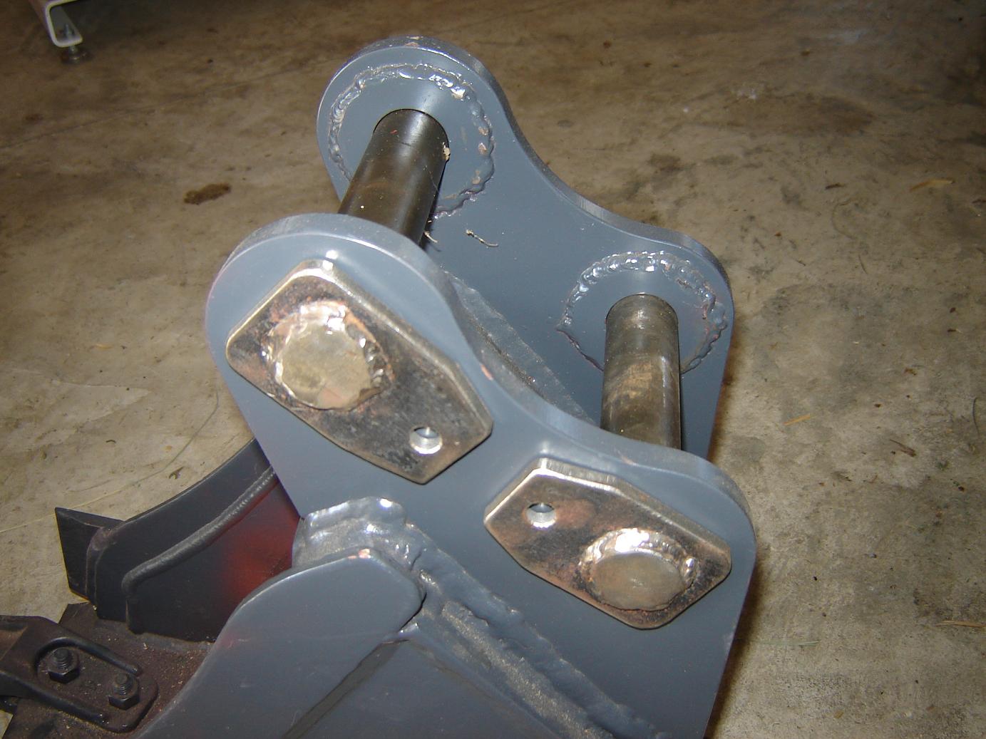

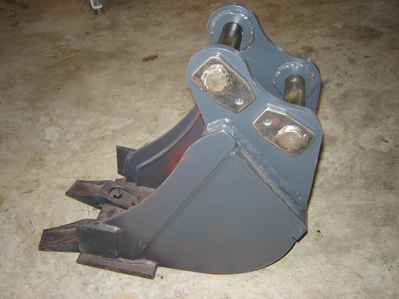

/ Back hoe bucket spacers called? #13
Here are pics of my modified bucket with new ears. Also included are pics of the raw ears which were cut with a water saw. My spacers were simply 3/16" or 1/4" steel plate. I am not near my bucket presently to check. I could have went thicker, but I was more concerned with keeping the ear outside width as narrow as possible since the bucket itself was only 9 inches wide.
I actually had 3 sets of ears cut for future use. One pair is targeted at a frost tooth.

ok finished the bushings, 1/2 plate 1 1/4 hole. pins. well i found a 6 foot rod with threads at each end cut off 2 pieces from the middle, wire wheeled the front one fits perfect, the rear one is making contact before the hole ( maybe the bar had a slight bend ? )
what material is used for pins, cold rolled, hot rolled?
I dont have my kubota pins there upstate wont have then on hand till the 17th. think i am going to wait till then before welding brackets to the bucket
/ Back hoe bucket spacers called? #15
The bushings came out nice!
When you weld the ears onto the bucket, weld a little at a time and stick the pins in the holes often to check alignment.
