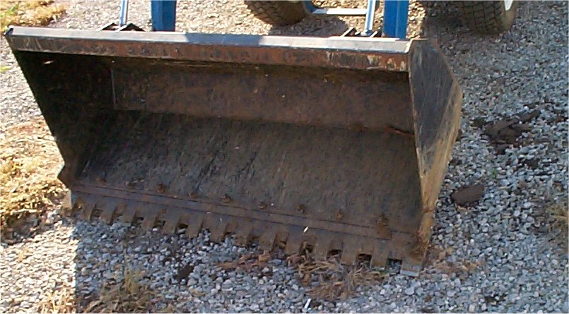

Here's a little bit of a different type of tooth bar. Called a Rezolok edge. Back scraping, no problem. Works great for raking dirt to get rocks out. Since it bolts to the bottom of the edge, it adds a lot of strength to the digging part of the bucket. And since it sticks out quite a bit, it really helps in moving things with the bucket.
   / Back Dragging with a Toothbar #10
Looks pretty good, but I'd hate to have to take it off with all those bolts holding it on.
