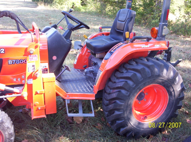

I would like to add a coouple of things to my b7800 if any one has done this talk to me on problems and where you found the add ons.
First I would like to add a step to sides to allow for an easier mount to the tractor.
Second has any one found and located tele arms to replace the bottome lift arms. Kubota dealer not the least bit helful. said arms from a larger tractor may work.

I can help with the step. This how I made mine.

I replaced the useless (and already bent when I got it) safety check chains with the telescoping stabilizers from the B2910. Well worth it. Tractorsmart has a parts package already made up. I am sure they can put together the parts from the lower arms from the B2910 as well to get the telescoping link arms you desire. TractorSmart home page

Thank You, I needed that, I have had about enough of turn buckles.
   / B7800 #6
This discussion valids the difference in cost of the older B2910 or newer B3030 versus the B7800. Bells and whistles become extremely important after a couple hundred hours on the clock or a couple dozen 3pt hooks/unhooks.
The lowers and telescoping sway bars from the B2910 will fit the B7800. So look for those part numbers. Messick's can help you and will ship to you, great people. :)
