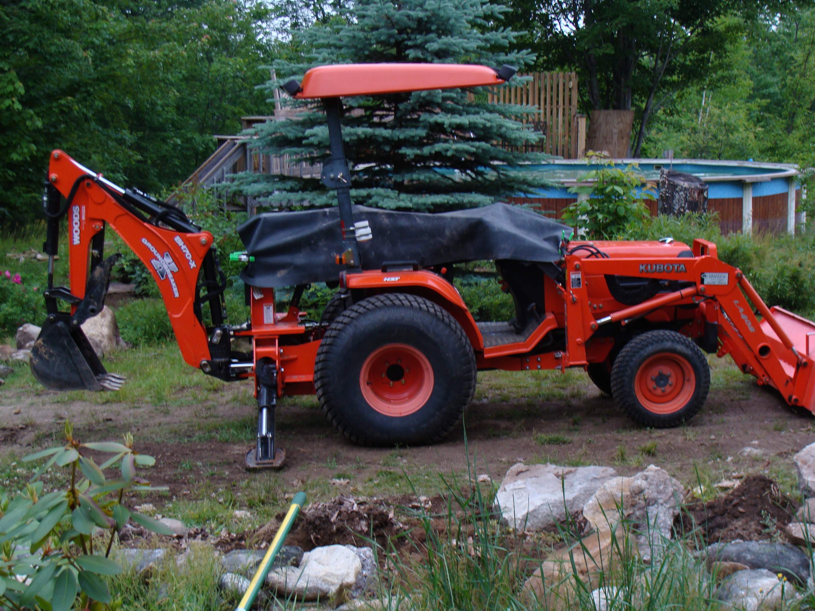

Anyone have the Bradco 408 backhoe mounted on B7800? Thinking about mounitng with subframe--subframe interfere or extremely difficult to mount? Anyone have problems with 408? Likes or dislikes? My use will be just around property--nothing too heavy--hardest probably taking out a few trees.

Have a Bradco 408W on a L3130. The L3130 could take a bigger backhoe but not sure how the 408 will fit on the B series, could be on the big side.

You are correct--checked with Bradco and was told the 408 was too big--would accept the bradco 365.

I realize its different but I just put a woods bh80x on a 7800 that is the biggest they said it digs an 8 foot hole with subframe np

7800DUDE, would you have a pic of that? That does sound a bit large for the B7800 so glad you got the 4PT frame mount!!
   / B7800 with bradco 408? #6
Magicheater Ill get some pics soon I just installed it sat from start to finish 5 hrs dealer and woods said that it was the biggest I could go and the machine would handle it fine I have soild filled turfs front and rear did not have to add front weights were supplied
   / B7800 with bradco 408? #8
B7800 with Woods BH70X attached

Thanks for responses and discussion. Sounds as if for the B7800 the consensus is the BH75 or Woods BH80X both with subframe. If anyone else has suggestions or comments I would welcome them. Never had a backhoe and don't want to waste money on one that harms tractor or won't fit properly. I've decided based upon discussion on other threads I don't want a 3 point altho many say they work fine.
